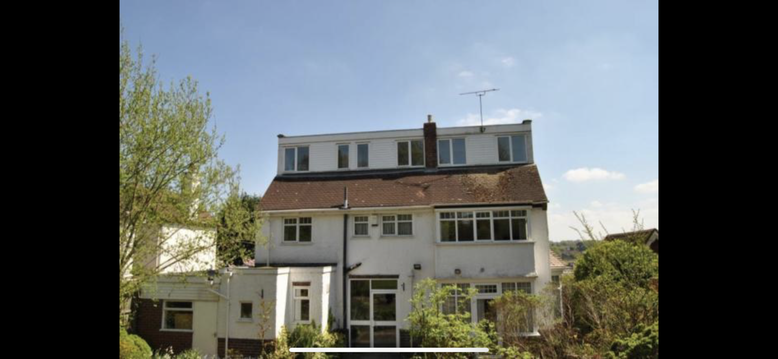

This is a picture of the rear of the house, you can see the stainless cowls (there are 2)

The flue that we originally discussed: does the sweeps camera go all the way to the terminal? If not you MUST access the terminal to check for material at the top. Also, terminals are terrible for being full of spider webs. It will pass a flue test but fail the spillage test. Is the terminal suitable for a gas fire? (It probably is).
Is the new photo the original? Can you post a clear pic of that terminal, and how far is it from the flat roof?

the picture is from when we got the house, don’t think I can get much better due to height. It’s 3m+ from the flat roof of the bay window. I will try in the morning and see if I can get a better picture

As requested, here’s the best pics I could take with my phone. My camera is yet to be found
