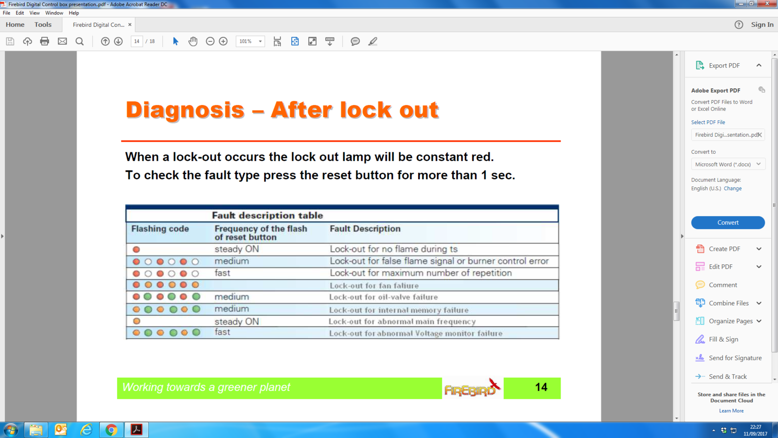

I have and it took me to the control box.
it has a supply present, I take it the photoresistance looks for the flame so I can disregard that as it's not firing anyway, the oil valve looks to be a solenoid to give the burner oil, a motor for the fan and ignition electrodes. I'm getting low on oil but not that low and I would of thought it would still try to fire even without oil present?

Is it the MO535 MPF digi box fitted or standard one (No post purge)
Have you tried unplugging burner supply to reset the box.
Is there voltage on motor black and blue wires.
Yes I unplugged the supply to the control box as couldn't get probes on to check voltage.
No voltage going to the motor though.
Control box shagged? Can't see anything else connected to it to tell it to run.
