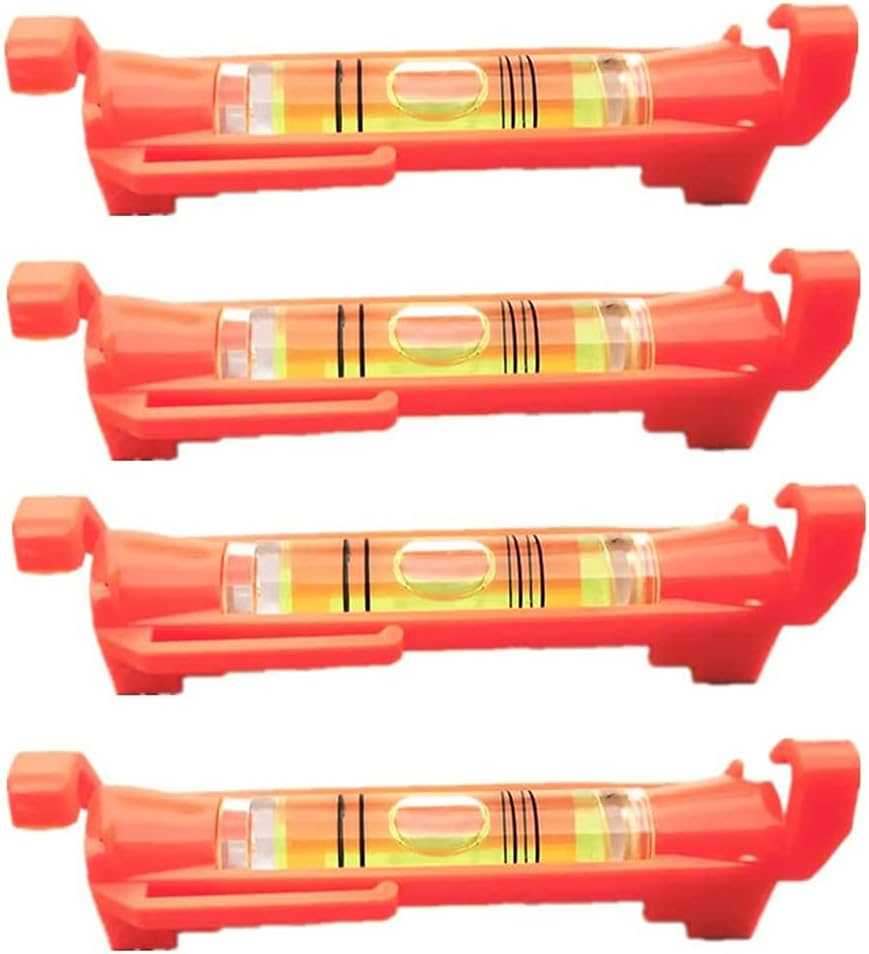

Set the corner blocks first, dry, perhaps on 10mm thick pieces of timber or whatever is to hand.
I use a string line level over that kind of distance.
Then, if neccessary, I'll set one or two midway blocks, dry again, to get precise levels with long levels or pices of timber.

How are you leveling the two ends? You'll need a datum at mid point too, so use the same method
Yes you'll need to hold the line up to prevent it sagging - known as a tingle. I use £10 notes.

Use a string line level.
