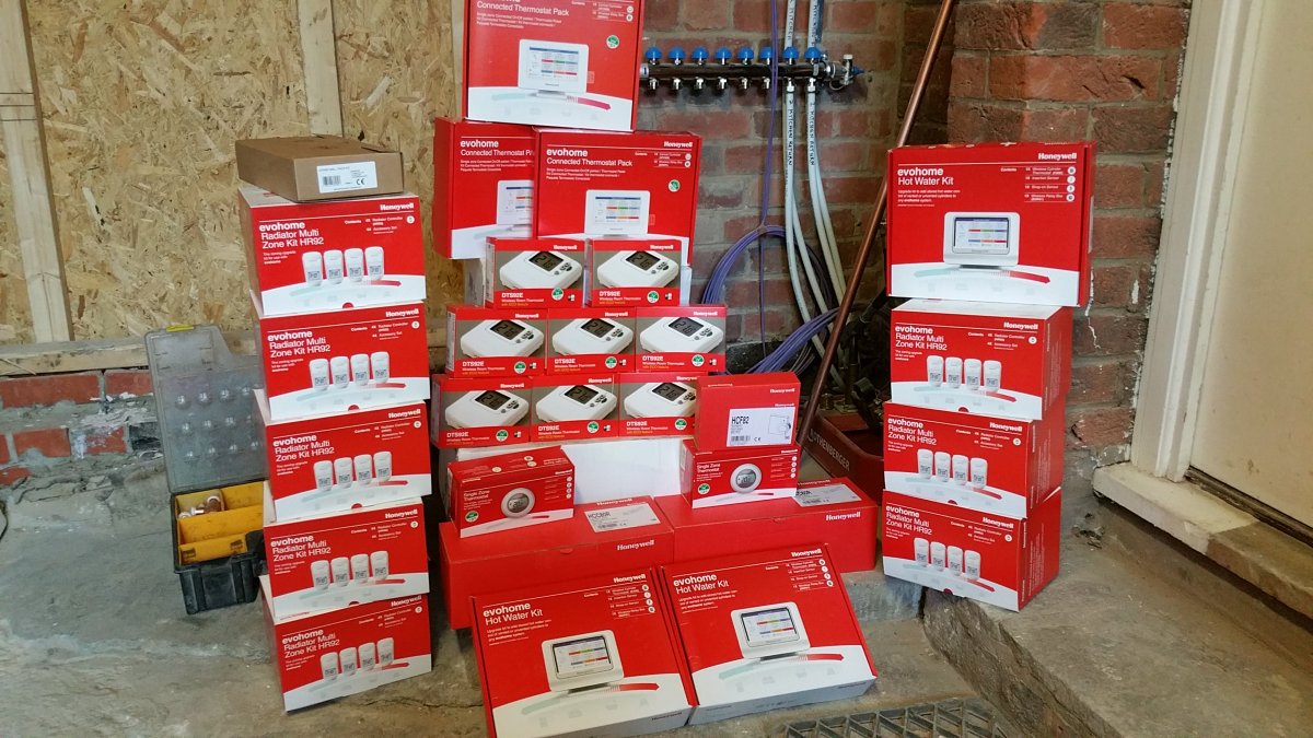

All sitting in the workshop waiting for the new year.
No chance I'm fitting this lot before Christmas. Hive and Nest are pants.
If u stick one wire in wrong mate u are very likely to blow that pcb they are good but notorious for failing if wired wrong, then trust me there will be no hot water or heating or manual control .. I can tell I'm not goin to convince you. Please don't think your the first, as Dan Dean etc have said , there are hundreds of us engineers out there an we all have at least a couple like you that will have a cold Xmas with an angry spouse. It happens every year, an this is not a dig at you.
