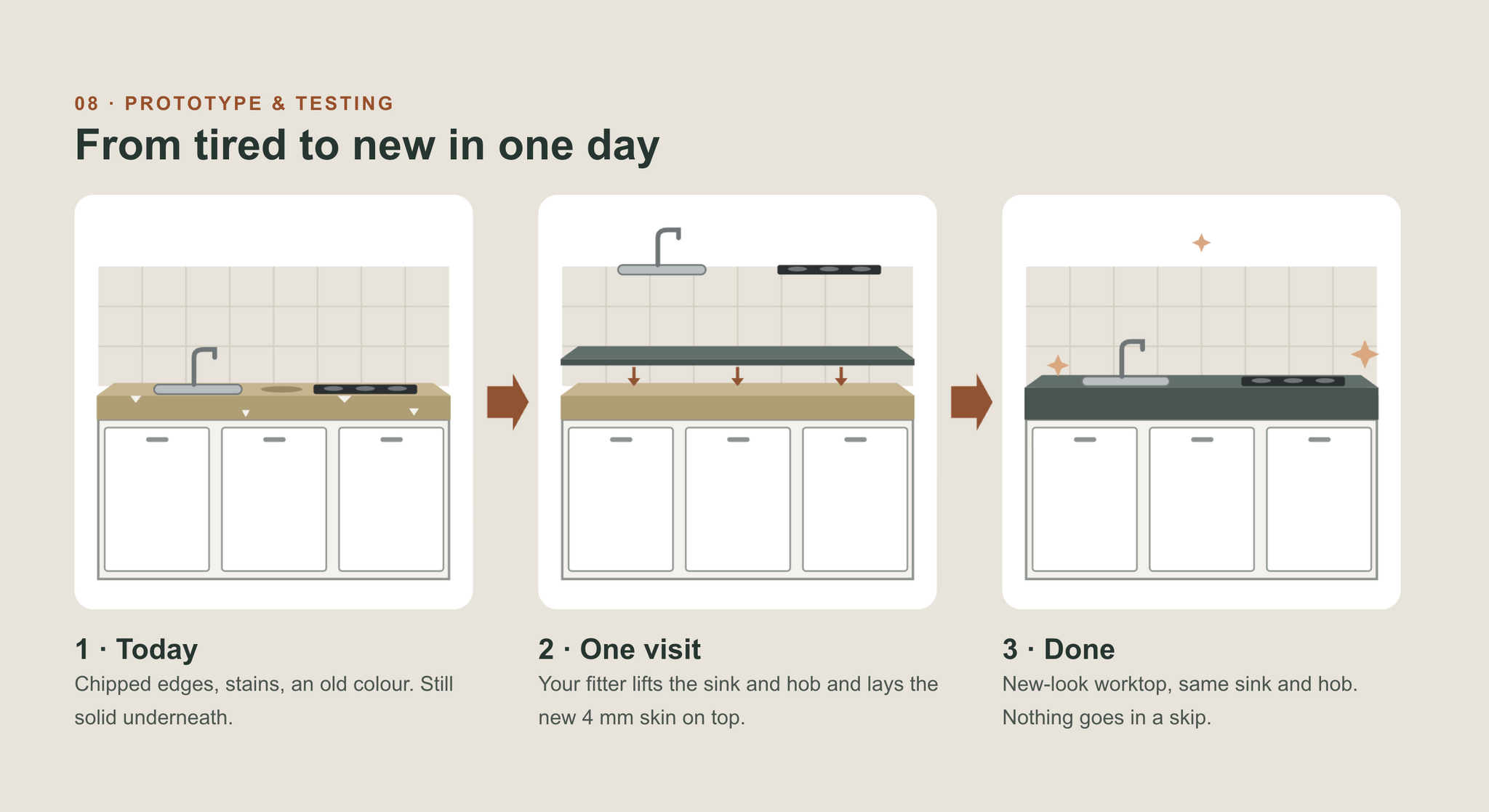

**The idea:** instead of ripping out a tired laminate worktop, you fit a pre-cut ~4 mm compact HPL skin **on top of** it. There's no glue, so the skin can come off again later. Sink and hob are lifted out and refitted. Panel price would be about the same as a new laminate worktop. Height goes from 38 to ~42 mm.

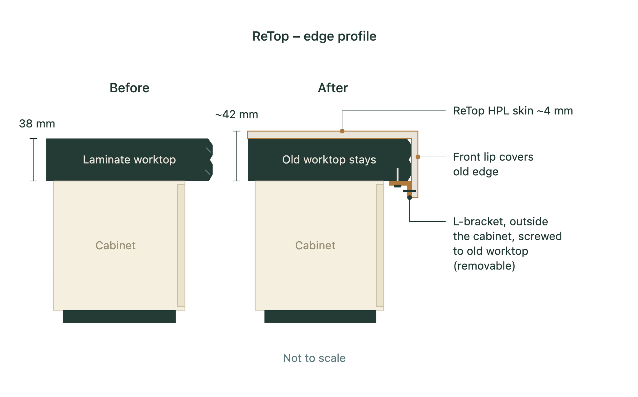

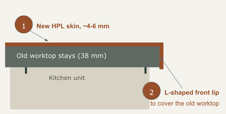

There are 2 options for the front edge (see first image). Both are held by a small hidden bracket with 2 short screws from below:
- **A: L-cap.** One L-shaped piece; the lip hooks over the old edge. Looks seamless.
- **B: Flat skin + edge strip.** A separate same-decor HPL strip on the front; the brackets unscrew from below.
*[image: 2 options for the front edge]*

*[image: fitting steps]*

How are you going to screw into (L bracket front lip) just 4mm of material?
Good point, thanks! In my drawing one screw goes up into the old worktop and one into the lip, and you’re right that 4 mm is very thin for that. That’s exactly what I need to test.
  1. Do you have any other solution that isn’t glue, so the skin can still be removed later?
  2. If it has to be screwed, what thickness would you recommend for the lip/edge?
