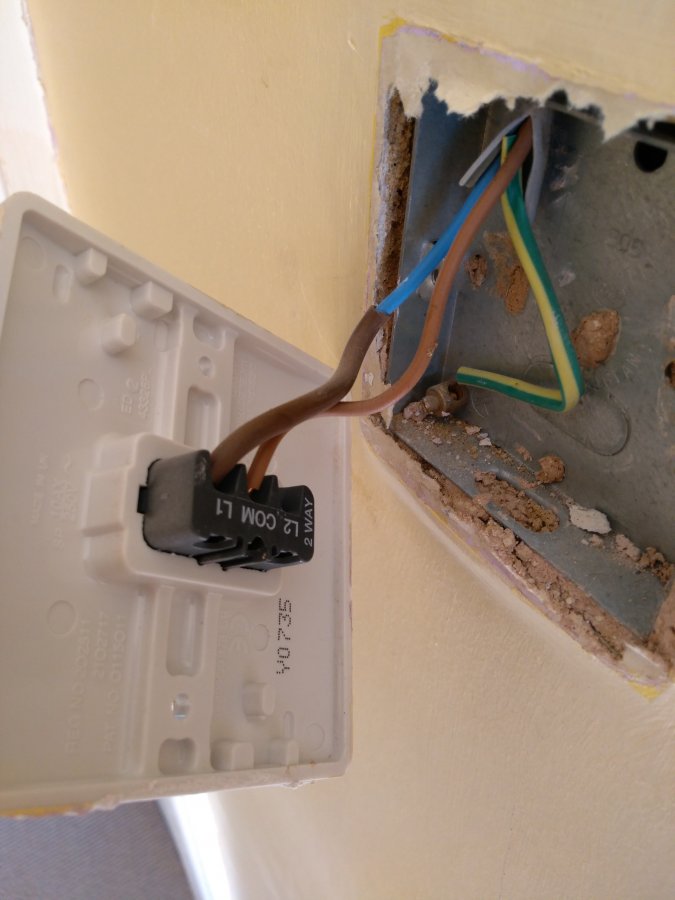

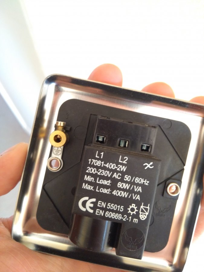

Hey guys,
I want to fit a chrome dimmer in place of a plastic switch. I have take pictures of the current install as I'm a little confused.
My guess is that I detach the yellow and green from the box and attach to the grounding cable on the dimmer? Otherwise the switch would be live right?!
The L1, L2, Comm stuff confuses me. I can see I have an L1 on my dimmer, so that makes sense. What doesn't is the Comm one on the old switch, should that to to the last port on the dimmer? The arrow and wavy line?! Or! L2?
Thanks for looking.

The arrow and wavy line symbol is the symbol for VARIABLE OUTPUT, Ie the wire going to the lightbulb.
In a majority of cases like yours this would be the Blue wire with the Brown sleeving on.
Do be aware that not all lightbulbs and fittings are actually Dimmable, they have to be compatible.
It is preferable for your Earth wire to be connected to the switch AND the metal
back box
Does the dimmer instructions state that it will fit a 16mm box, looks dubious.

Oh and really I should get a small length of earth wire and connect to the box and switch, and leave existing earth cable where it is?

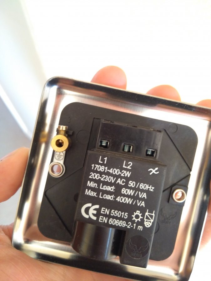

I doubt that your LED light will work with that dimmer.
It needs a load of at least 60watts (its written on the dimmer!)
I doubt that your LED light is anything like 60 wattts!. 5 watts, maybe.
So you'll need an LED-compatable low-load dimmer. The Varilight V-Pro is a decent make.
Ah, I see, I did not notice that, or realise it. Many thanks for pointing it out. With most people using led or energy saving, 60w seems like a very high load no? Considering this was purchased about a year ago.
Oh well, looks like I can't use my nice spare chrome dimmer, any other lights on the house are all less than 60w.
