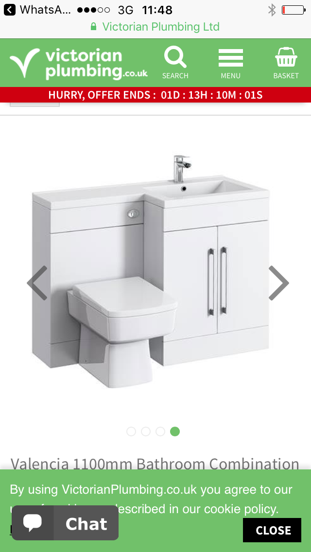

Hello,
I am looking at fitting a combined vanity unit (see pic) Is it possible to incorporate a macerator behind the toilet ? Has anyone else done it with success?
Maybe, but you will need the dimensions of the unit to see how much room is left for the macerator.
I have a Sanislim boxed in in our downstairs bog. They are, as the name suggests, slim. They can cope with a wc, sink and shower. It’s a lot quieter too when it’s boxed in, especially if you fit some sound absorbing material in the box.
Sanislim is D186 x H270 x W447 with centreline of 184 to connect to the pan spigot.
