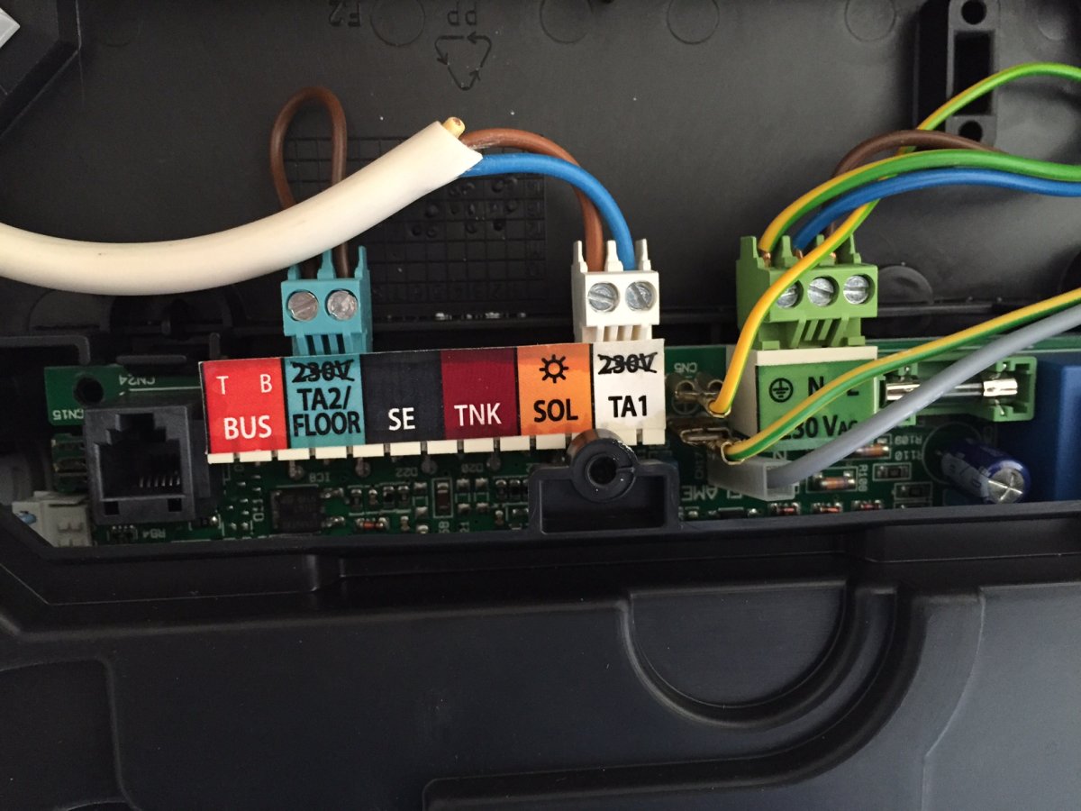

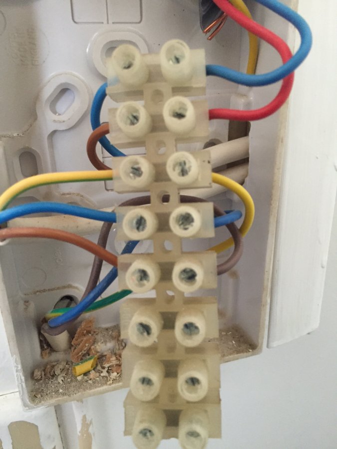

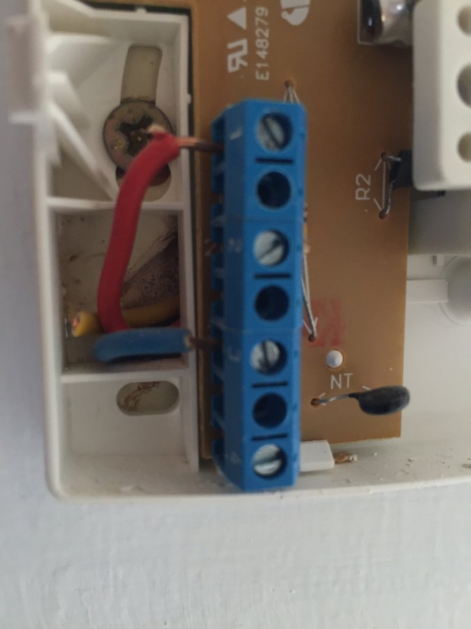

Hi I'm a newbee, looking to install a Nest thermostat in place of the current manual room thermostat and was after a little information and clarification before I start.
I currently have a wall mounted mechanical Horstmann HRT3 thermostat which has x2 wires (which measure 12V on a meter) 1x Red wire in connector 1 and 1x Blue wire in conector 3. These both back to a jct box and change to 1x Brown and 1x Blue cables and go back to TA1 on my Ariston Combi Evo boiler which has a sticker no 240v on the connector.
With regards to Nest installation, my understanding is that I connect a 240v supply to the L + N connections on the nest Heatlink for power, and the x2 12v cables on TA1 from my boiler (Currently going my thermostst) , go to conections 2 + 3 on the Heatlink.. Then my new Nest Thermostat connects to T1 + T2 on the Heatlink..
I have attached a couple of photos of the current connections on my old thermostst, jct Box, and Boiler connections along with a wiring diagram for the Nest Heat Link.
Thanks in Advance.. Regards Mark
