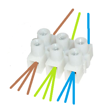

Doesn't the lamp come with a terminal block included in its own ceiling rose, as indicated by EFLImpudence?
No, seems I need to purchase it myself. Any idea on what the amp I need?

    He says the light is double insulated - it really doesn't look it, but it does only use 2-core flex. Your light uses 3-core. Does it have the double insulated symbol anywhere on it, or say Class II?
    One review says "Looks pretty but arrives as three separate light wires and an underwired rose - you need to work out how to get them together. No connections, or even connector blocks under the copper rose", which matches your experience. With a manufacturer that determined to save every last fen, you might like to think how far you want to trust your life to the underlying safety of his products.

    Talking of which - he says "Comply with UK satety standard" (sic). Does it lay claim to any specific standard(s)? Is it CE marked?
