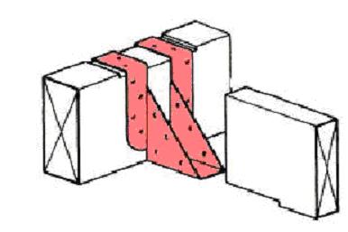

Trimmer a short section of joist set at right angles to the beam to be trimmed. these are affixed by joist hangers to accept the trimmer and trimmed joist to provide structural support.
the best pic i could find to give you a clue.
hope that helps
then all you need to do is double up the other joists as you have increased their load by 50%
