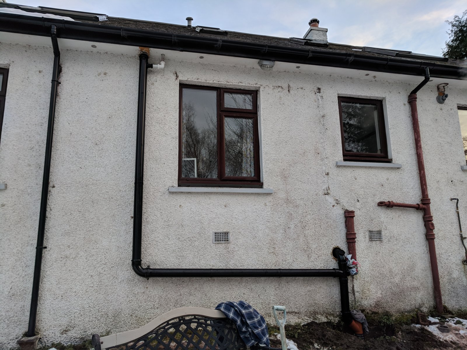

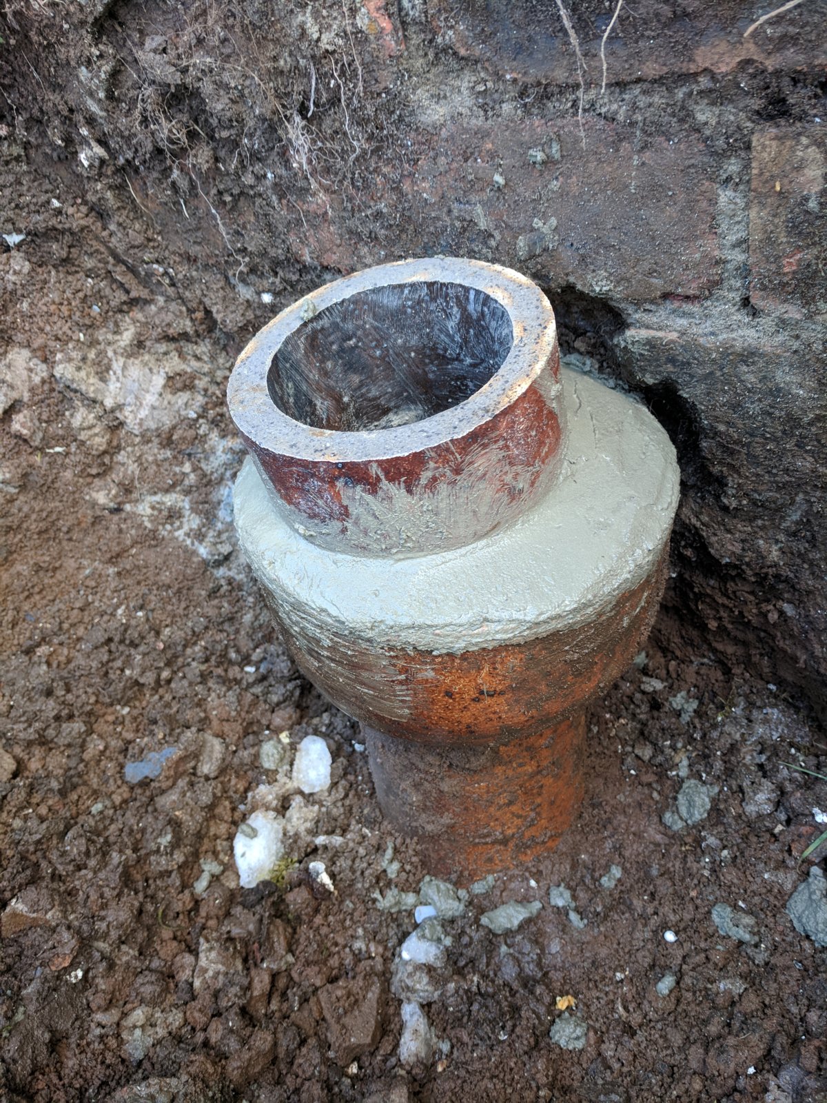

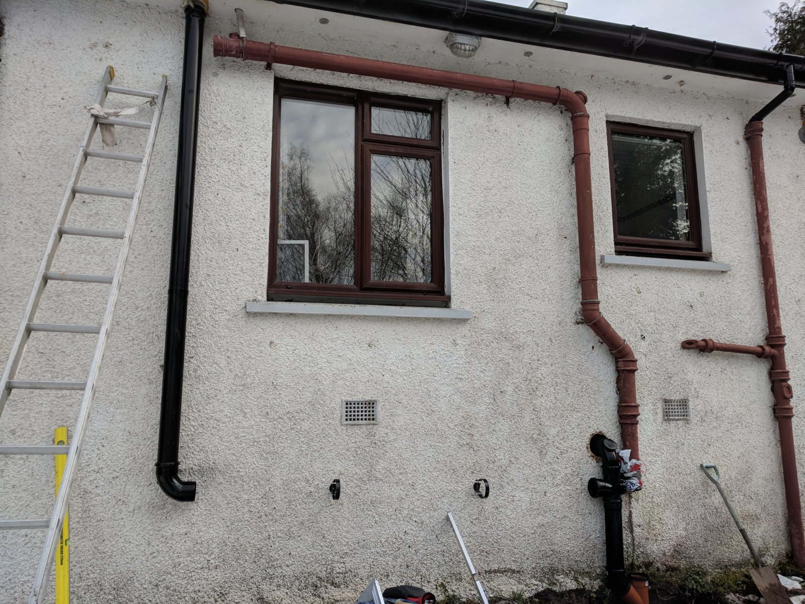

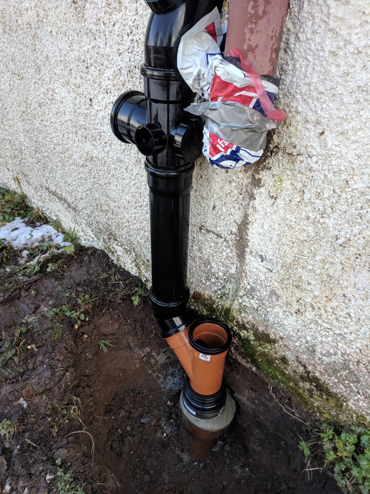

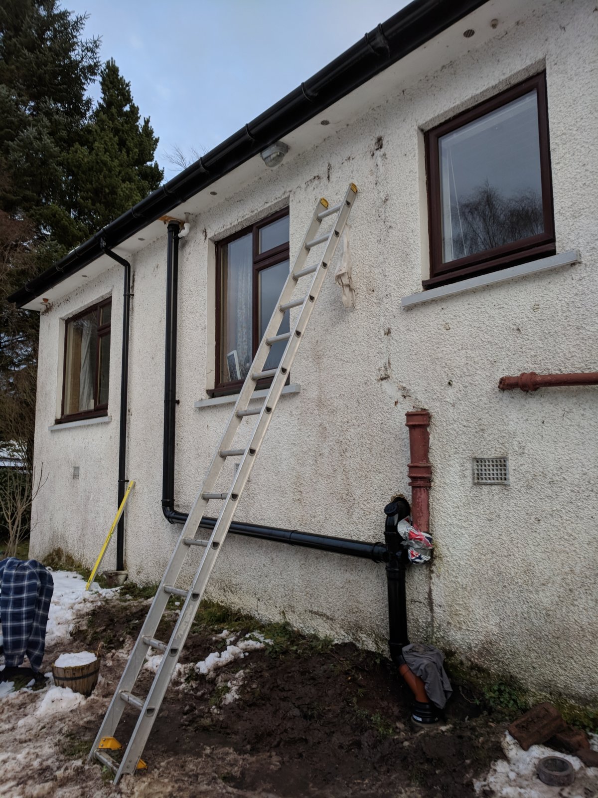

Got cracking on this today and did all as planned except the connection into the salt glaze spigot. It was sitting at a really squint angle and I wasn't convinced the push in adapter or the boot would connect well allowing the pvc to go straight up. I had a wee bit of old salt glaze pipe kicking about so cut a short section with an angle at the bottom enabling it to sit plum in the wonky spigot. Put a wee bit of newspaper round the bottom (to stop the mortar dripping down) and a touch of silicone to seal the joint then mortared it in with 3:1 sharp sand and cement. This gave a good, plumb conection for the fernco style connector and avoided having to dig a giant hole to grind off the spigot. Everything else seems to have gone well. Very impressed with how easy the mcalpine mechanical boss is to use, kept things simple while I was hanging off a ladder to reconnect the upstairs shower waste.
I won't fit all the brackets on the vertical section just yet as it will all be coming off in a fortnight or so for the rendering to get done but very happy with how it looks. Just need to remove the last cast section thats left on the wall then do the downpipe on the right. Should all be done tomorrow if I can find someone who stocks 4m lengths of downpipe.

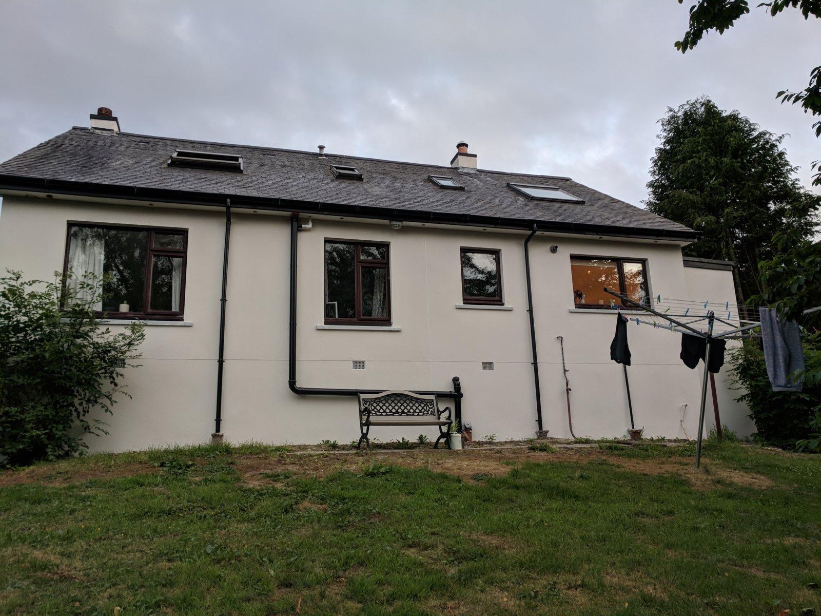

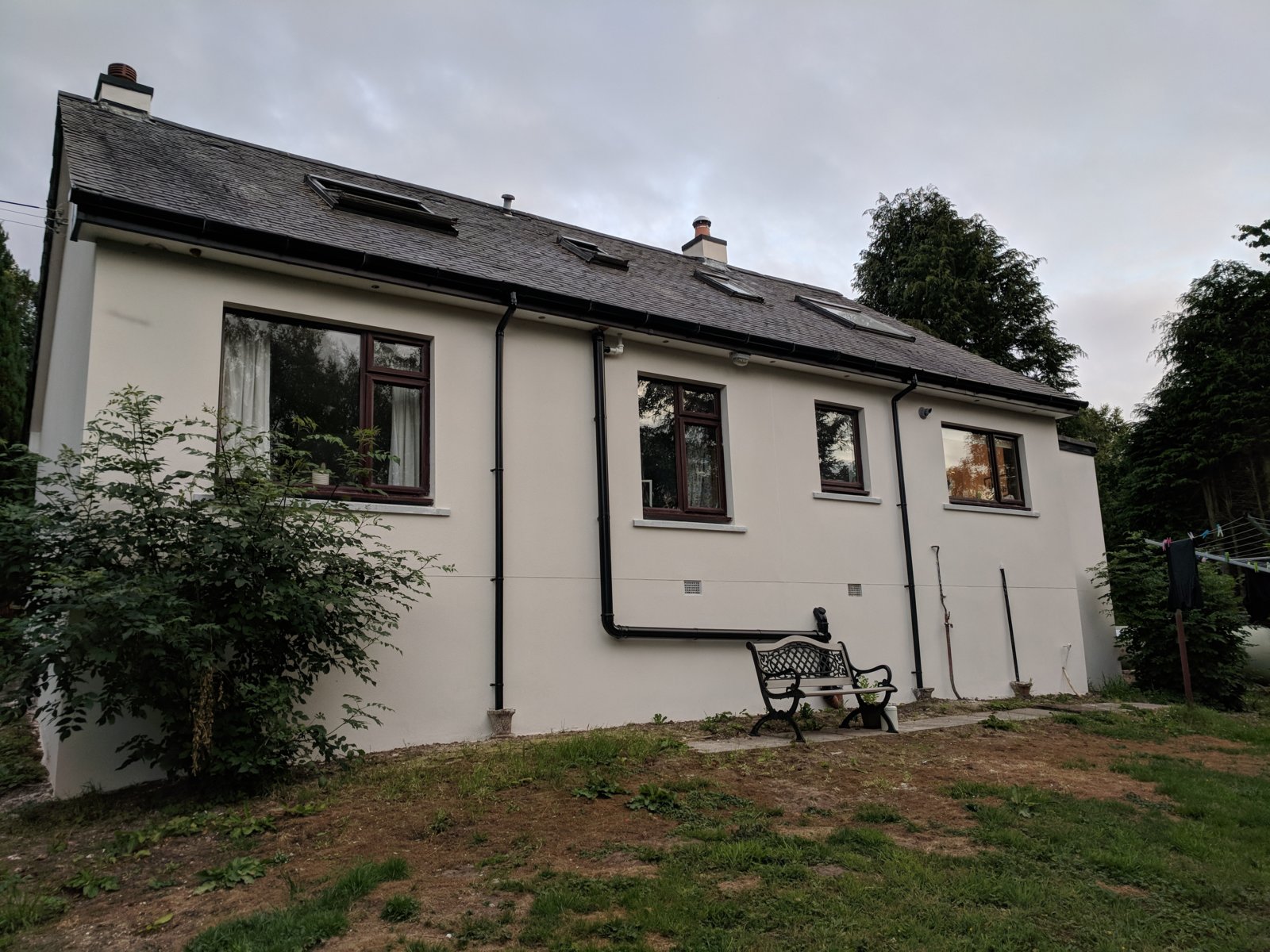

Well overdue but realised I didn't ever put up a picture of the finished pipework job, this was actually taken last summer when the grass was still recovering from the rendering work (looked like
the Somme for a few months). Once again thanks to the helpful members here for their advice, the plumbing is all working as it should so I must have for something right.
Looking good .....
Only thing I would add is, if you have any brown soil pipe that is/will be above ground for any length of time then paint it to protect it. As it's underground pipe, it's not UV stable and will break down over time.
I think some credit needs to go to you Dougie, for asking the questions, taking on board the advice, and no thinking you know best. Result is, a very tidy job and all working as it should, thanks for coming back to us with the result of your labours.
+1 for Madrab's point, good coat or 2 of gloss paint doesn't hurt on all exposed plastic pipework to protect it against the UV in sunlight, but the underground stuff especially needs it to prolong it's lifespan.
Thanks for the reminder. When it was originally planned I expected that section to all be below ground but I ended up digging away a fair bit of accumulated soil to get to the bottom of the old roughcast before the rendering team came in. I intended to replace with a black equivalent but tbh I just put it on the back burner and forgot about it. Paint would be a much easier option though, I've got some black zinnsser allcoat in the garage so I'll lash a bit of that on.
