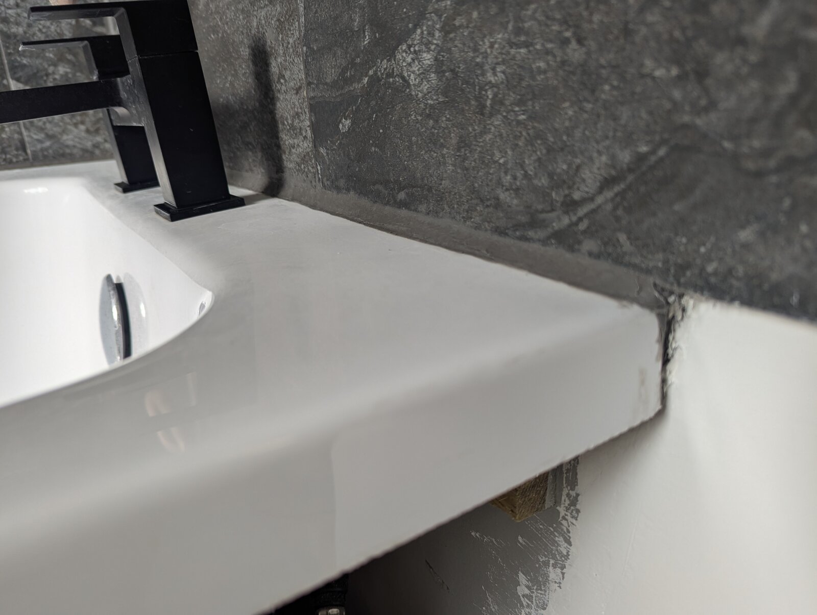

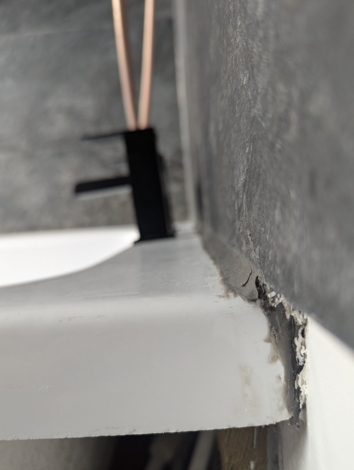

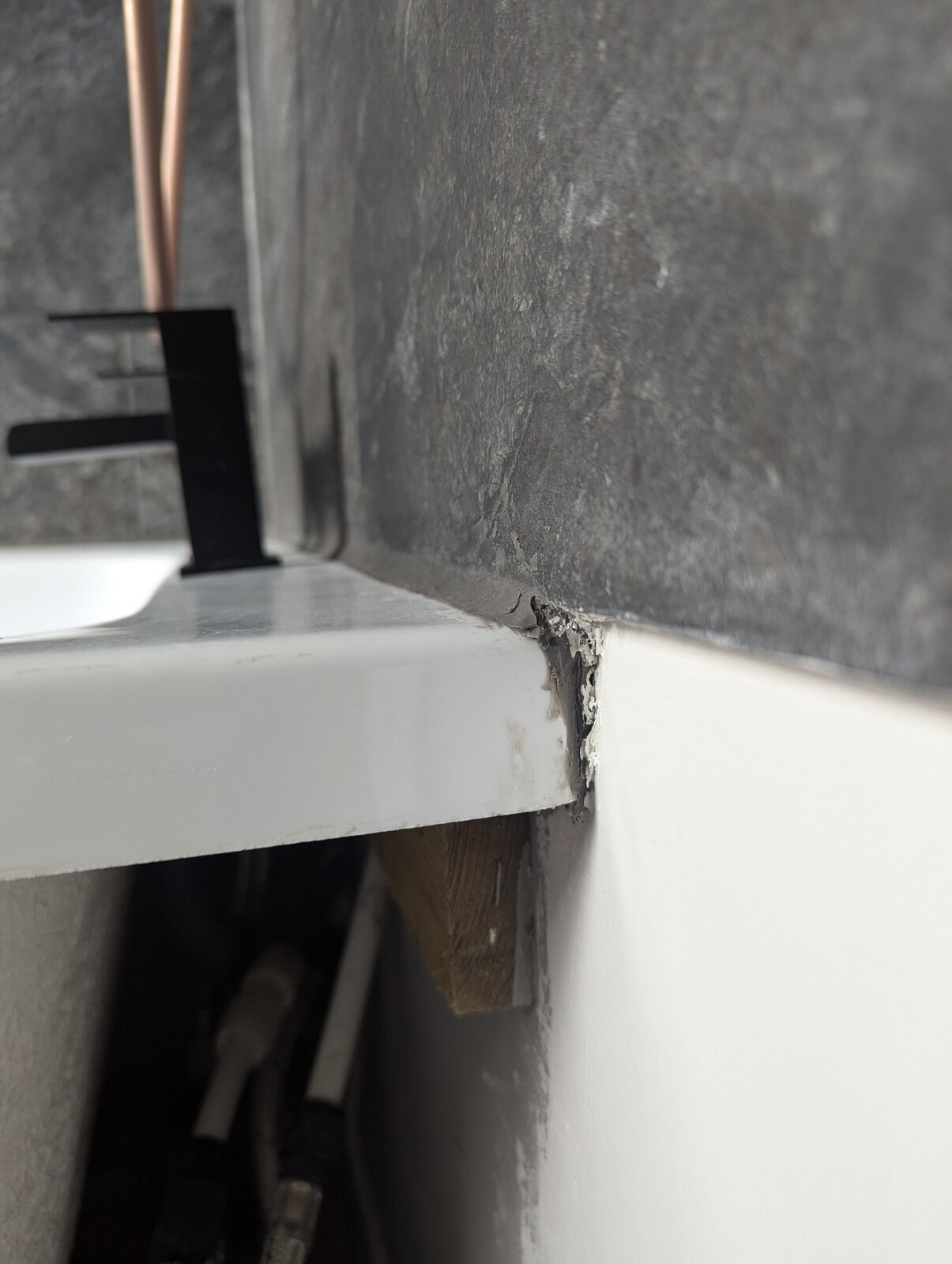

Hi all,
I've siliconed the bath tiles and bath edge already. Decided to go with a shower screen now and to install the wall profile bracket so it can be flush to the wall, is it best to:
A) cut the silicone at the point where screen will go and remove all(as much of) the silicone and re-silicone when installing bracket.
B) cut out just enough silicone (and hope there's still enough to seal tile and bath) so that the bracket can sit (fairly) flush to the wall?
Might be hard to see from photos, but used a tool for the silicone and is quite large (think 10-14mm from memory) as wanted a good solid seal. But because of that, it's hard to put the profile in now

Just cut a notch in the silicone so the wall profile sits flat to the wall and the bath, when actually fitting the channel, fill the notch with silicone attach the cannel then clean off the excess, so the edge seal is reinstated.
Hopefully there is a seal along the edge of the bath at the all wall contact points so removing that small notch shouldn't really compromise anything underneath it anyway.

The only other is is. Manual says not to silicone inside of the screen. But having the nitch and resiliconing up to would mean I am?
I understand not siliconing the inside is so water can escape when water inevitably gets inside the profile. So should I just cut a notch, but just silicone the back of the bath/profile? And avoid any on the side of the profile so water can still escape?
No - you don't silicone the inside edge top to bottom, only on the outside but that's why it's important to have a seal at the bottom at the bath edge so any water that runs down the inside edge leeches out and runs into the bath and not into any gap at the bottom.

Profile the bottom of the wall mount channel with a grinder so it matches the silicone profile, and applies a slight pressure to the existing silicone when installed. New silicone up the back of the channel, touching the wall
The small 10mm screws you refer to sound like they're for attaching the screen hinge to the channel not the channel to the wall - part 9 in the diagram in the manual
I'm sorry but I can't disagree more, grinding out the bottom of the wall channel is asking for trouble IMO. Much easier just to notch out the silicone and then add some new in as the wall profile is being fitted.

I mean applying a tiny 3mm or so radius to the bottom of the wall channel; a smaller radius than the radius of the existing silicone (which is 4mm let's say) so that when fitted, the channel presses on the existing silicone
Very unlikely at that small a radius you'll have to do anything to the hinge attached to the glass; just set it out a mm or two. The entire reason why these things are supplied as a two part "channel on the wall then drill and screw the hinge to the channel" affair is so that the channel can take out any discrepancy introduced by the wall being out of plumb, so the screen hangs straight and doesn't drift open or closed under its own weight. As such, you can radius the channel and not the hinge and just have the adjustment the channel offers take up the difference so the hinge isn't resting on the silicone
Or notch the silicone, if you feel you can do a good neat job and not introduce a hole in it that will then need to be filled; it's either/or and a miniscule adjustment no matter what - I just recommended what I did as I felt it would be faster and neater to tickle the channel with a grinder than adjust the silicone. If you don't have a grinder or wouldn't be confident doing the radius, adjust the silicone
