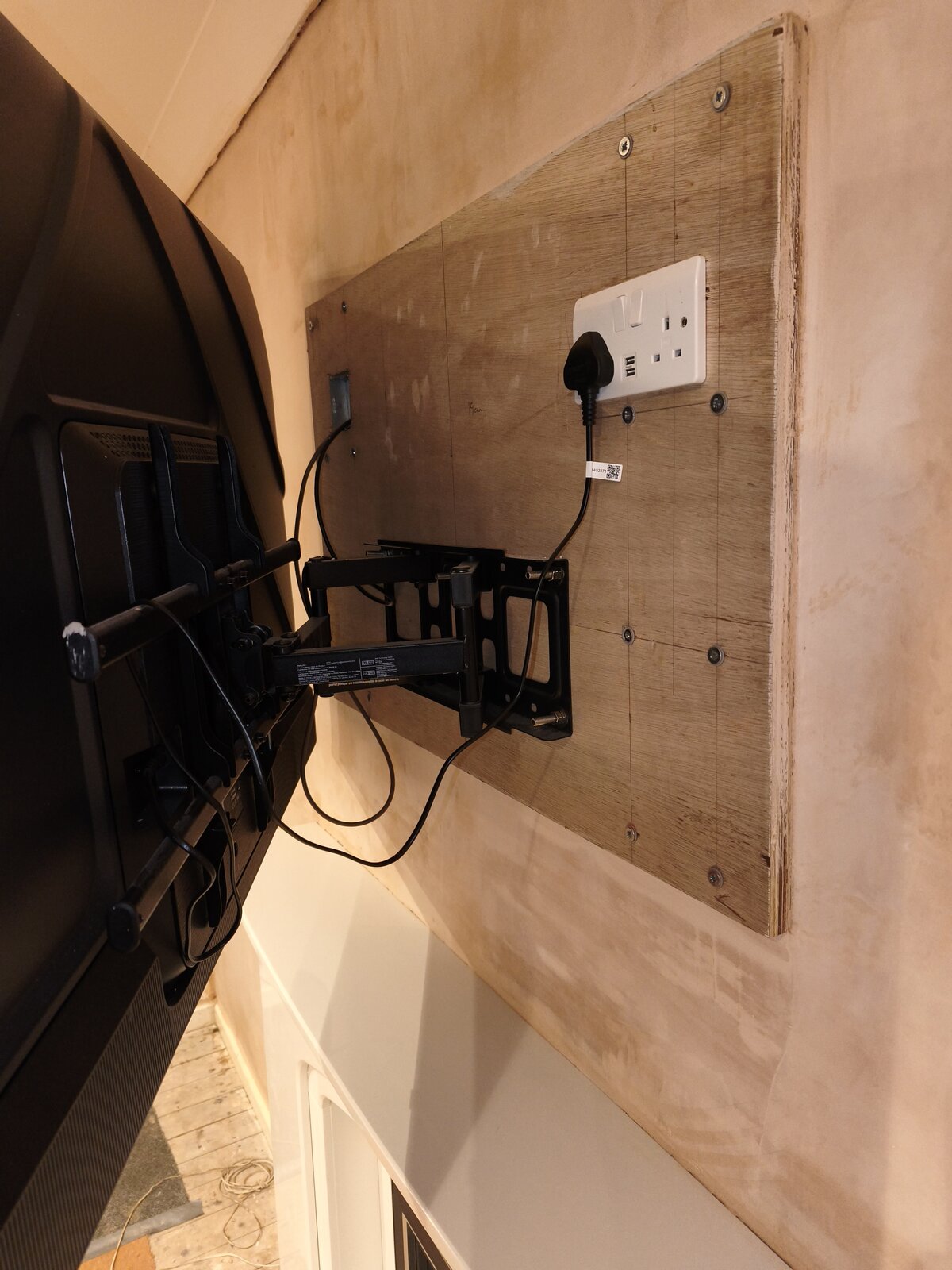

I;'m thinking 25mm wood thickness (100x100 square on wall) should be strong enough to hold anything?

(Just wonderering if I use these to screw into wood, then into plasterboard, I want the sleeve part to reach the block behind)
So, outside of wall - plasterboard - air gap - breeze block - already 30mm approx? I want a decent thickness bit of wood but not so much it means the sleeve is ineffective.
I would go OTT on the fixings.
I have an extending TV bracket. It's mounted into a chimney breast, but I didn't want to go near the flue as it's being used without a liner, so I rang Fischer and he calculated to use 4x 100mm frame fixings either side of the flue.
I like to over engineer things, so doubled up!
The ply I got was 25mm, so I could recess a socket into it without having to bash the breast about.
The bracket I reverse bolted through the ply with 6x 8mm stainless bolts, washers and nuts.
The TV weighs 11.5kg.
The bracket, with its original wall plugs and 10mm bolts was rated at 65kg load.
They seem to be 50mm
With the 105mm plug the screw is 95mm if your board is 18mm thick you might be better off fixing the corefix through the plasterboard only and then screw through the board, possibly using 100mm screws.
