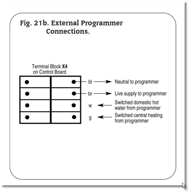

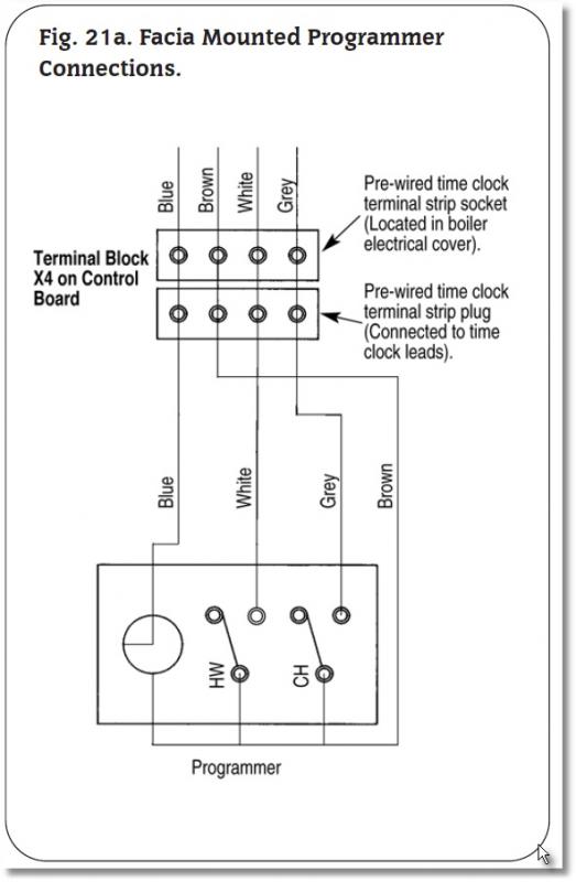

Looking at the installation instructions for the boiler it shows 4 connections for an external programmer - L, N, SL to CH and SL to DHW. Please see the diagrams Facia Mounted Programmer Connections and External Programmer Connections.

The brown wire is L and the blue wire in neutral
The CH On connection ( 4 ) is a Switched Live which will connect to the grey wire at the boiler.
The DHW On connection ( 3 ) is another Switched Live which will connect to the white wire at the boiler.
This makes sense to me. There will be no connections at 1 and 2 on the programmer back plate as these are the OFF positions.

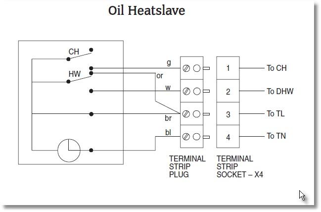

However when I looked at the actual wiring for the existing twin channel worcester programmer I see that there is a 5th ( Orange ) wire ??? Please see diagram Oil Heatslave.
This has me a little confused. Is it something to do with the Pumped or Switched setting on the twin channel programmer ?
