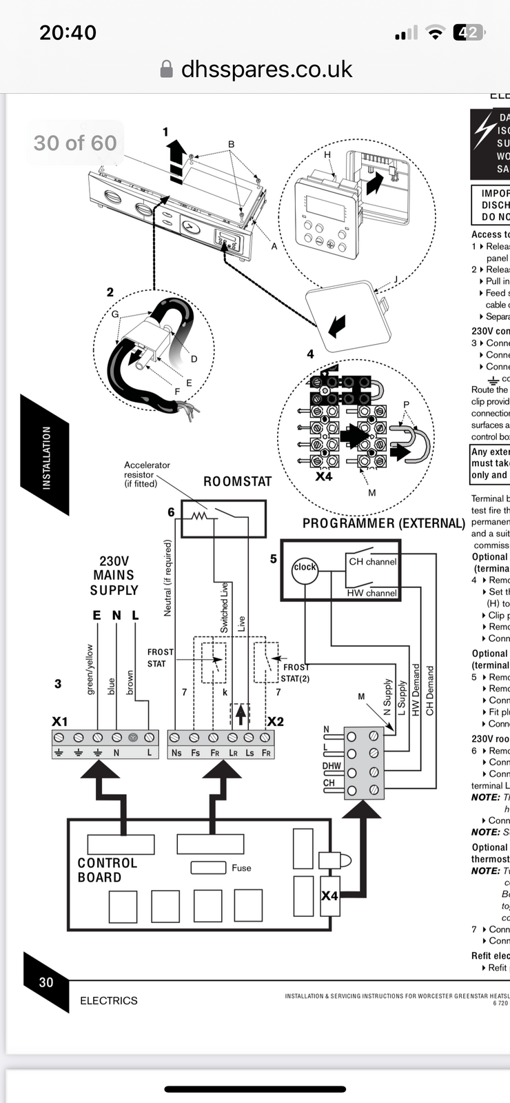

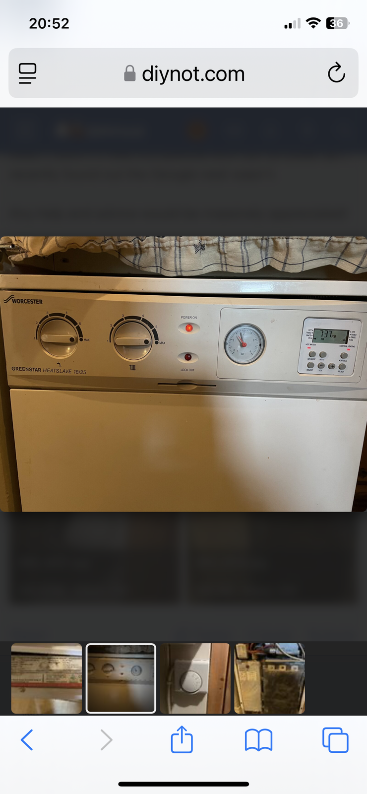

Recently moved into a house with an (ageing) Worcester Greenstar Heatslave 25/32 oil boiler. It doesn’t have a room thermostat just a programmable timer like in the attached photo.
Is it possible to replace the programmer with Hive or Honeywell TR6 control or similar so we can set demand by room temperature as well as just time? For instance so a minimum temp can be set for night time?
Looking at the wiring in the manual (also attached) it appears the current programmer has L N CH and HW wired on the boiler control board, is it as simple as replacing the programmer and wiring these terminals to the hive receiver? If so assume a dual channel is required?

Latter model to mine, but yes can fit better controls, mine does not modulate, so no real problem simply turning on/off.
But how is a little more complex. We have in general the Honeywell Plans, The C, Y, and S are most popular, and there are three versions of the C Plan.
The C and Y plan default to DHW, so the boiler can cool by heating DHW, but these plans we designed years ago, and some control systems can't work with C Plan. Hive has a software option so will work with C Plan, and where one has access to the Com terminal of the relay it can be wired to C Plan so Nest Gen 3 will work, and I also think Tado will work. Wiser I see no easy way to make it work.
But I have found no real need to control DHW, I can't turn it off, so in winter it heats up when central heating runs, and in summer we use the immersion heater, which for us works out cheaper.
So start point is to work out what you have. In the main, S Plan has two x two port valves, Y Plan has one x three port valve, and C plan often no motorised valves. The C Plan, common with oil, comes in three stages, the first pump runs for central heating, and does not run for DHW only, there is no tank thermostat. The lack of tank thermostat means the boiler is controlled by time only in the summer, so adding a tank thermostat only does anything in the summer, but means the boiler turns off when the tank is warm enough. Adding a motorised valve and tank thermostat allows you to have DHW cooler than the central heating water.
