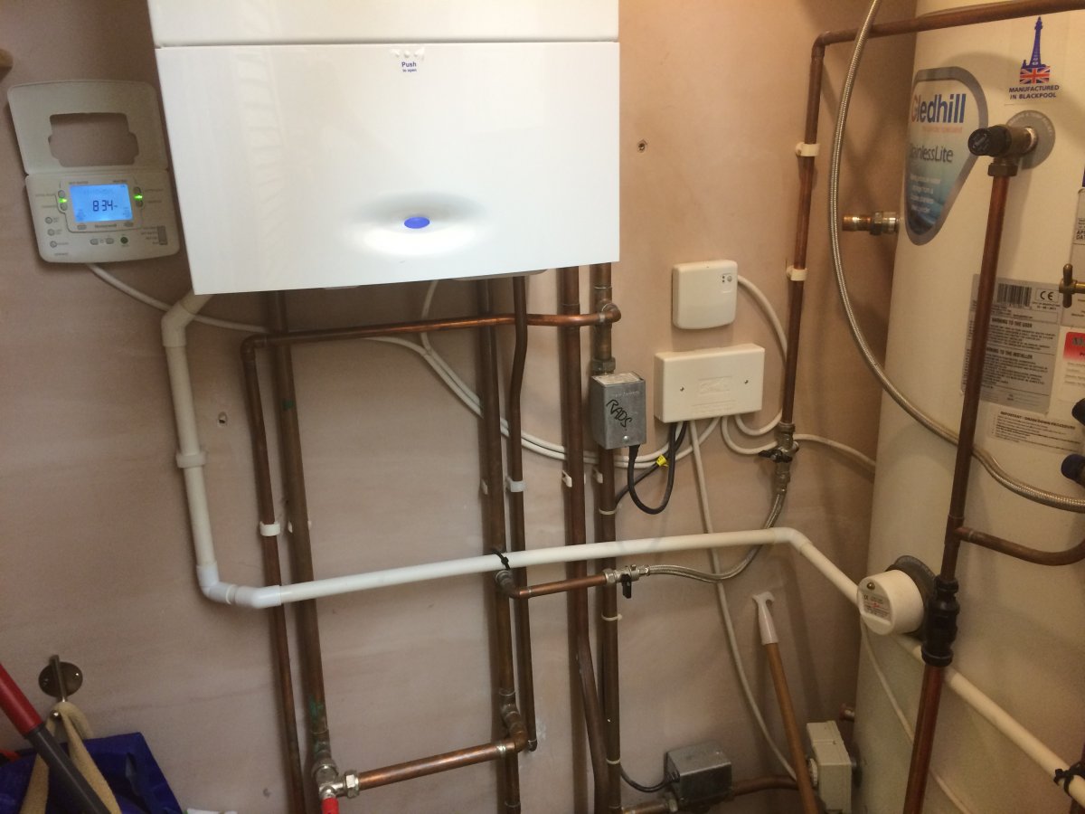

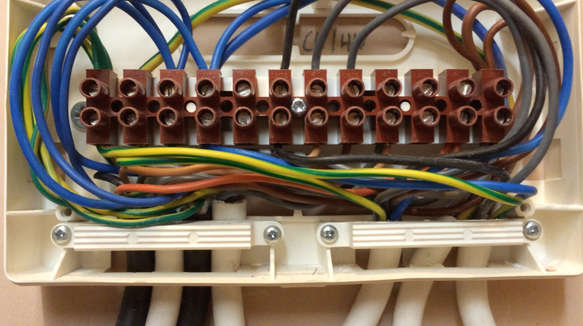

My current CH setup is a pressured sealed-system with a hot water tank and Worcester boiler. It has a Honeywell ST9400C programmer and a wireless Honeywell thermostat. Unfortunately the programmer is starting to fail (it keeps powercycling) so I'm looking to install the new Hive instead.
This is how the setup looks:
![IMG_4478.JPG IMG_4478.JPG](https://cdn.diynot.com/data/attachments/86/86219-b2fdbbad8aca34b2b51557e4abfb3ceb.jpg)

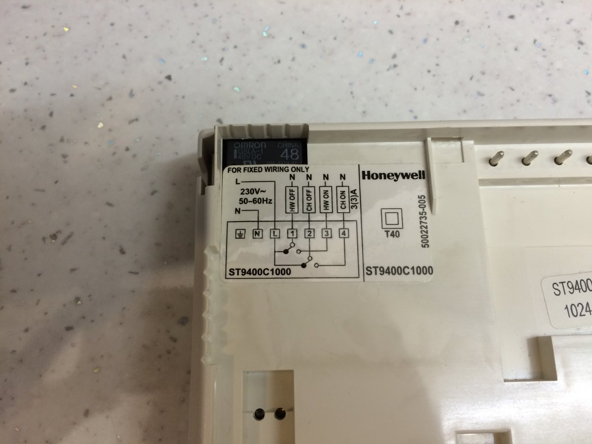

Programmer:
![IMG_4475.JPG IMG_4475.JPG](https://cdn.diynot.com/data/attachments/86/86221-96d59df90984dfe1ada601cb0e55978e.jpg)

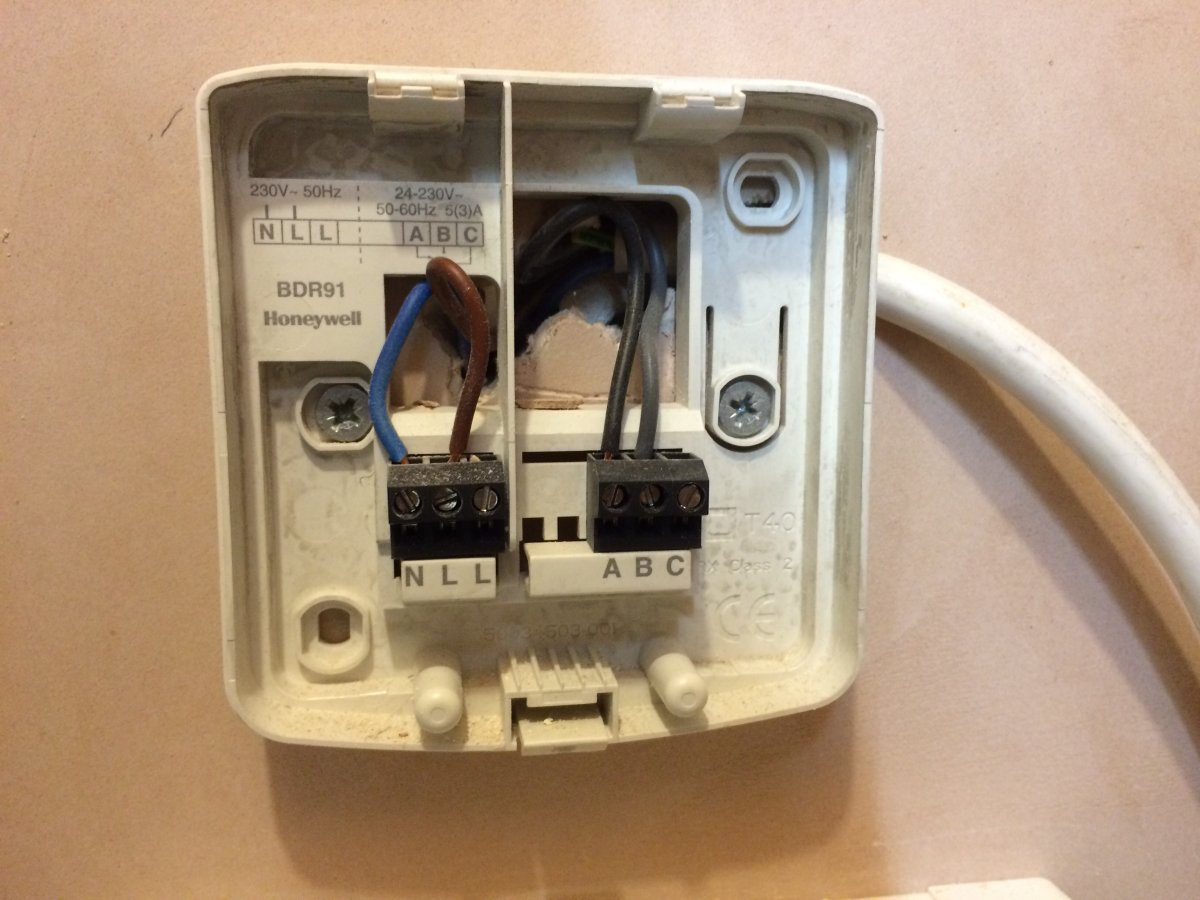

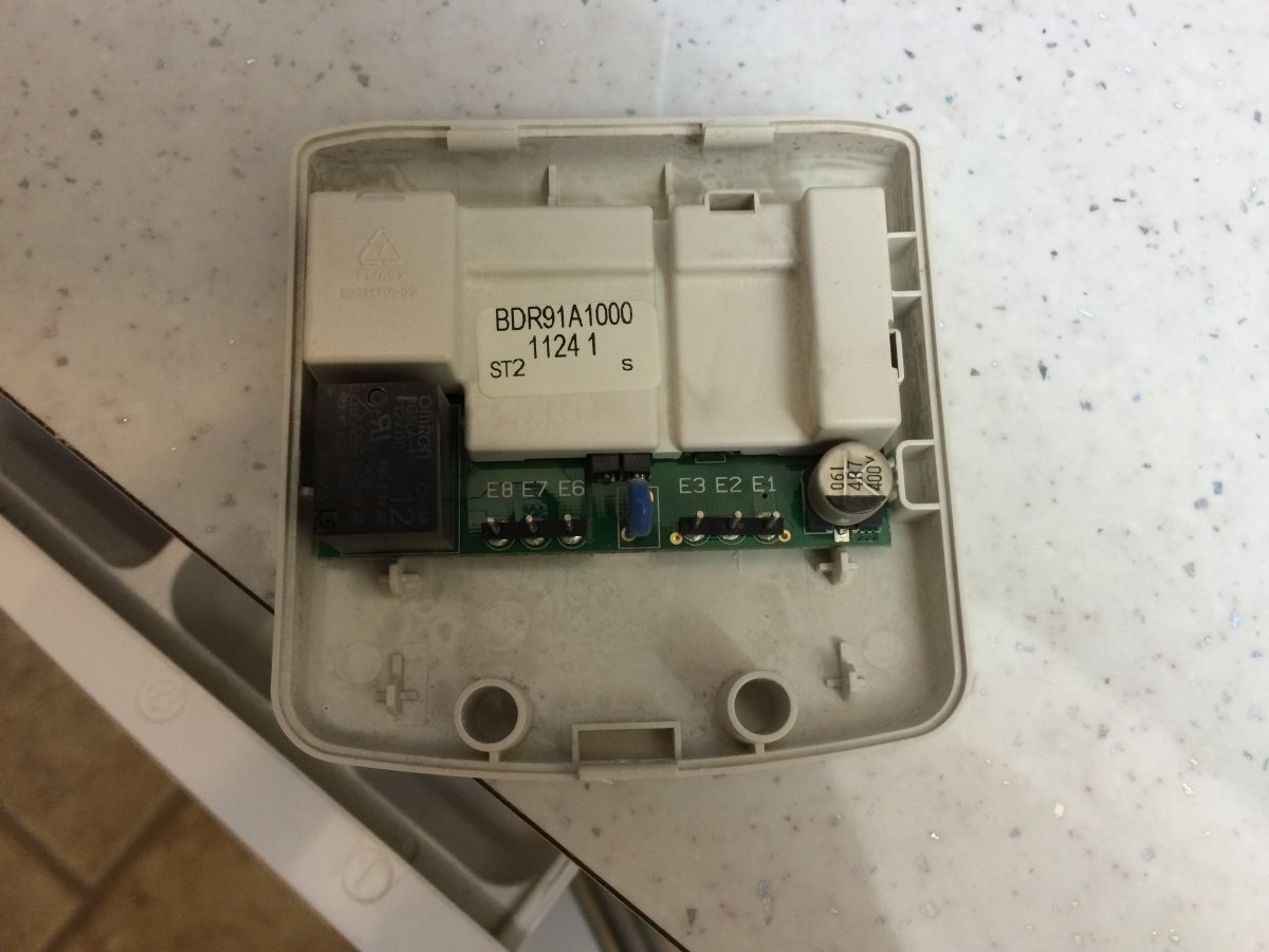

Wireless receiver:
![IMG_4476.JPG IMG_4476.JPG](https://cdn.diynot.com/data/attachments/86/86222-ff9f55810f0a53299b16e62642e27a7e.jpg)

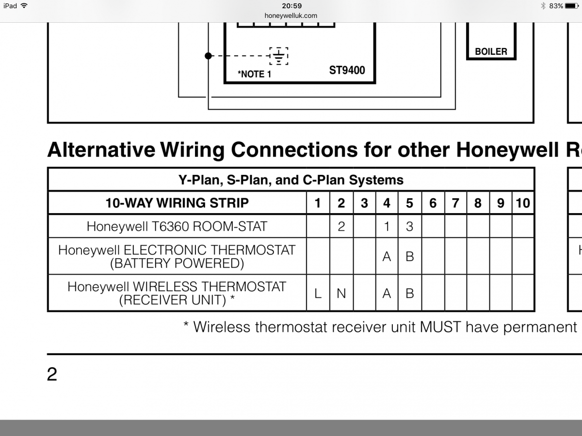

Wiring box:
![Screen Shot 2015-10-11 at 20.43.52.png Screen Shot 2015-10-11 at 20.43.52.png](https://cdn.diynot.com/data/attachments/86/86223-216a0a10556e32e95bae95465aaf9e14.jpg)

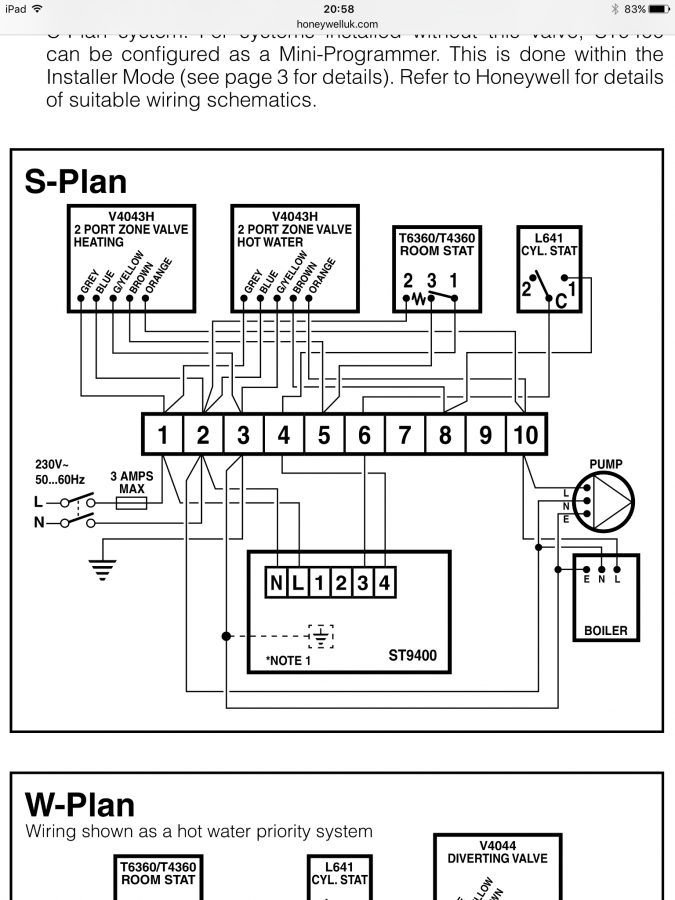

I believe I have an S Plan wiring setup (because of the two separate valves), so the wiring diagram looks a bit like this:
![IMG_0097.PNG IMG_0097.PNG](https://cdn.diynot.com/data/attachments/86/86225-37187d8e4d455b4591fc7907a78a2bda.jpg)
Question is, do I just swap out the programmer with Hive's dual-channel receiver? Do I need to do anything with the wireless thermostat receiver?
I can see that the thermostat connects to pins 4 and 5, with pin 5 controlling the heating valve, so given that I no longer need the thermostat receiver, do I need to wire pin 5 to the new Hive somehow?
Do I need to be concerned that there's no wires for CH and HW Off on the programmer?
Thanks in advance!!!!!
Paul.
P.S. I'm open to better than Hive suggestions?
Programmer:
![IMG_4474.JPG IMG_4474.JPG](https://cdn.diynot.com/data/attachments/86/86220-c7268c690e6e53a491e2d88312549c65.jpg)
Wireless receiver:
![IMG_4473.JPG IMG_4473.JPG](https://cdn.diynot.com/data/attachments/86/86218-fa1f2cb25ba7853633216f5ac6bdc388.jpg)
Wiring box:
![IMG_0096.PNG IMG_0096.PNG](https://cdn.diynot.com/data/attachments/86/86224-5b38689bf662f8c28f51603f56930ae9.jpg)
