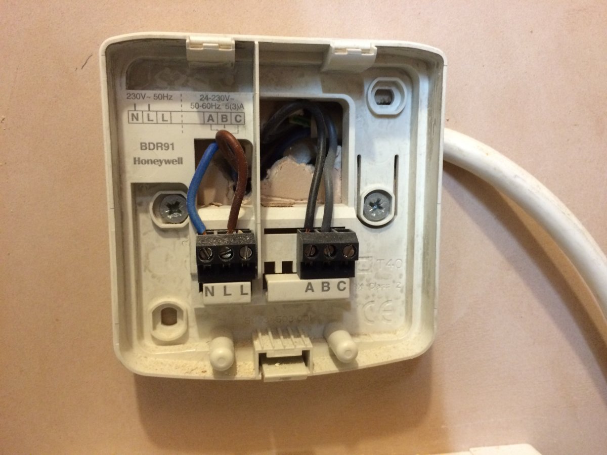

Thanks for the extra info! Not sure what you mean by fitting relays to pattress boxes though? Unless it's the wiring of the receiver boxes to the spaghetti junction as seen in one of the pics in my first post?
The evohome relays (the BDR91's) are really meant to be fitted with the wires emerging from the wall, but if you wires run surface mounted (like most heating wires I would have thought, mine all are) you need to either make a hole in the evohome relay (yuk!) or fit a pattress box first (and drill holes in the side of that).
I did that with a hole the size of the heat resistant cable I used for all the wiring in the cupboard area. Looks neat in my view.

The wires for my existing BDR were dug into the wall by the plumber at the time:
It's not that big though from what I remember. Probably OK if wiring in 1mm t&e?
I prefer using pattress as a: I have shed loads left over from my house build and b: the fsu is in a pattress anyway as the backing is 1/2" ply I had left over to give a good backing for loads of pipe clips.
Horses for courses I guess. But digging out a wall is "not that neat". I'll say it no stronger than that ;)
