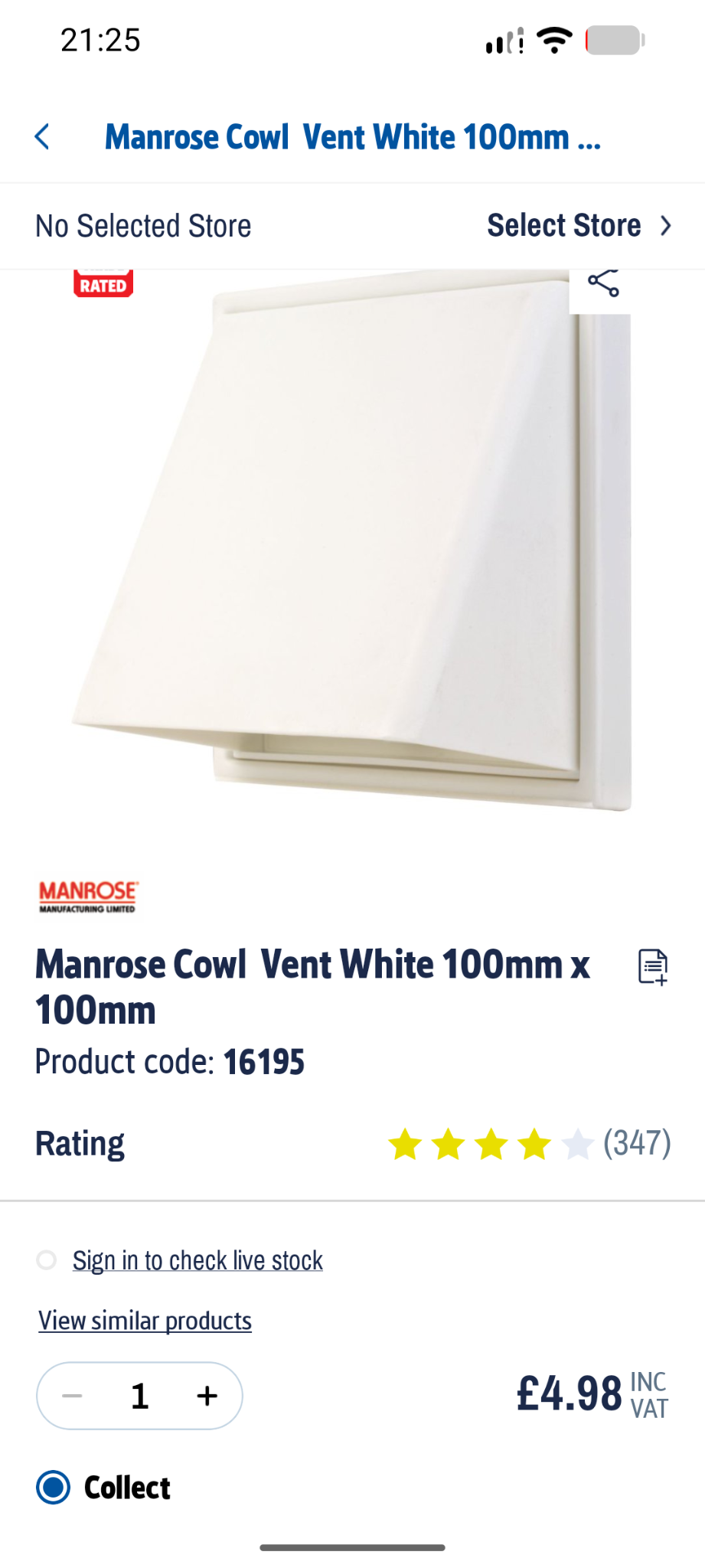

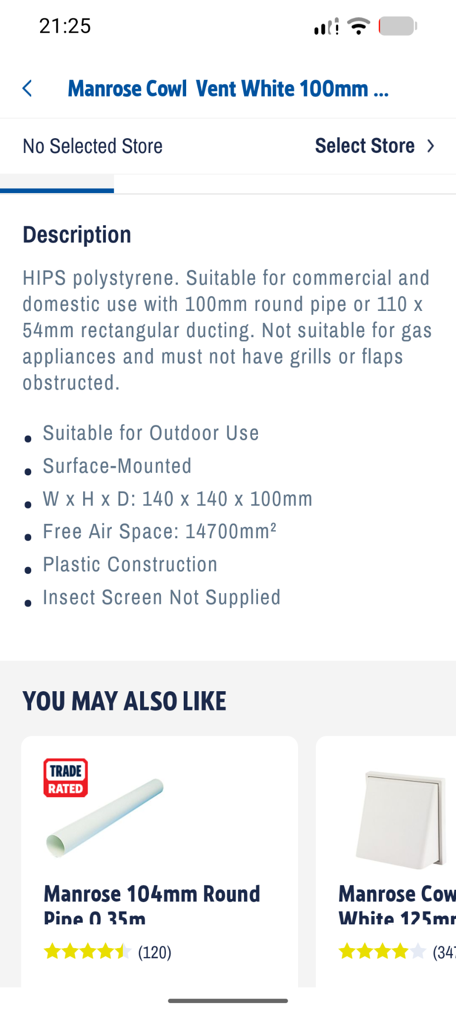

For a LPG cooker the kitchen needs (and has) a 100mm diameter pipe (no extract fan just passive ventilation) going through the kitchen exterior wall to vent to the outside through a large airbrick near the top of a 2.4m exterior wall. Would like to fit a LPG compliant extract hood/grille to stop insects getting in through the hole but the cowls I have seen (e.g. Tool station 100mm vent cowl hood: https://www.toolstation.com/airvent-round-ducting-cowled-outlet/pAB016) can't be used with gas appliances (the LPG gas would get trapped in the hood). Is there a hooded cowl I can use to screw over the Airbrick? Screwfix says this hood type is not suitable for gas appliances

Thanks. The new kitchen design is 5-10m2 (knocked down separating archway) so in theory a permanent vent opening is not required but as is there is a passive (no extract fan) 100mm pipe going through wall through an airbrick. I need an airbrick cover (that reduces visible light reducing insects coming through the hole) that is gas compliant. Can't find any though
The swinging flap can be removed, leaving just the weather protection cowl.
Would gas buildup be able to escape at a fast enough rate with the swing flap removed? In theory the gas would be positioned outside the house so wind etc should disperse the gas. Some sort of airbrick cowl cover

That's not what that vent is for, is it? Are they not to ensure there is enough fresh air coming in to ensure complete combustion and no carbon monoxide?
Would a cowl hood effect fresh air coming in to prevent CO build up? The gas cooker already has a separate vent extraction
