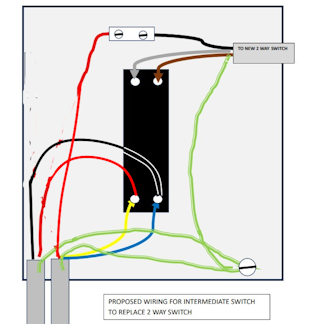

Hello , wondering if I can get some advice Pls
Want to fit an intermediate switch upstairs Landing so I can fit a switch at the end of the Landing also. At present there is two way switching but switches are at the bottom of the stairs and the top. I want to add another switch outside bedroom at end of landing. I've run a 1mm 3 core and Earth from the new 2 way switch Position to the 2 way switch at the top of the stairs and have an Intermediate switch to replace 2 way at the top of stairs. I am a bit baffled by what I found when I opened the switch to replace it though. There's 2 cables coming in ( 2&E and 3&E) in old colours. The house was built approx 1992. I'm guessing the the 2&E goes to the lights and the 3&E to the down stairs switch. What's baffling me is that the Red from 3&E is in connector block with the Black from 2&E. The Lights have worked since house was built so I guess it must be correct. Its thrown me a bit though as I thought I had the wiring for the Intermediate switch sussed but think I'd better get a second opinion on my wiring Plan ( Attached). Also, the new position for the 2 way Switch will be in a Plastic Back Bow so is it usually ok to leave the Earth / CPC in a connector Block as no earth on switch plate ??

Hi, Here's a diagram of down stairs switch. Its a dry wall plastic box being fitted so I will just leave CPC in Terminal block or wago
That's fine. The red wire in the 2&E from the light is the permanent live, which goes through the various switches and the eventual switched live is the red wire coming back from downstairs. That's then connected to the black wire going to the light, which is the light's switched live.
It should of course be sleeved to indicate that it is a switched live rather than a neutral. (There are no neutrals in any of your switches.)
