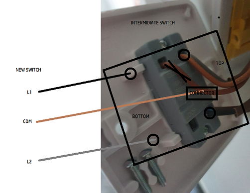

I was considering changing the upstairs 2 way switch with an intermediate
Running 3 core + earth to a 2 way switch next to the main bedroom, joining the commons in the old 2way (now intermediate).
However the light would be fed from the intermediate and not the end 2 way would this work and be classed as within regs?

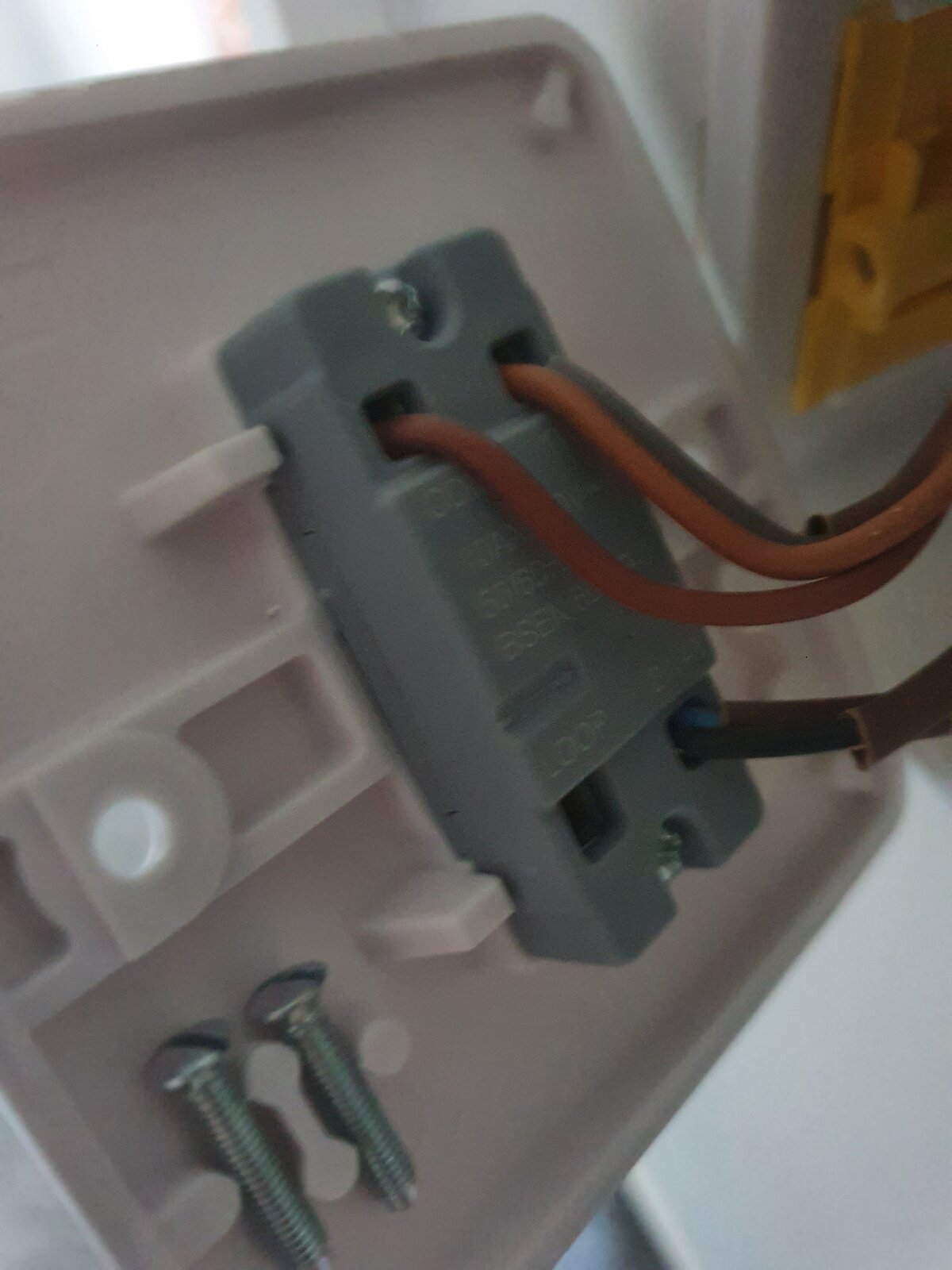

Is there one? Post photo of switch(es) if you are not certain.

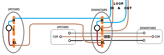

How is the circuit wired?
Post a picture of the upstairs switch wiring. Just copy and paste pictures.

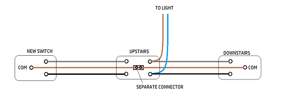

Ah, I see. There is no additional light,l (duh)..
just need the line and switched line connected at the intermediate rather than at one of the two way switches at the ends.
There’s no reason why you shouldn’t do that. Have done so myself when adding an additional switch to a landing light when a loft was converted to an additional bedroom.

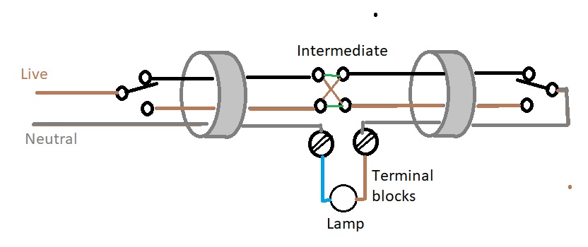

Black should be sleeved with Brown to show it as a Live
Grey from Neutral should be sleeved with Blue to show it as a Neutral
Grey from switch should be sleeved with Brown to show it as a Switched Live.
Can you explain that in a way that my dim brain can understand? Thanks.
Kind Regards, John
In domestic singles is rare so maybe a Twin and earth from the light down to one switch, and no neutral.
The live and switchline connected to L1 and L2 and a Three core cable between the 2 switches
He can then extend a new 3 core to his third switch and still keep L an Sl across the 2 strappers in his new intermediate, just as they likely are in the 2 way switch he is removing, the only joint will be to carry the link through for the Commons
Please see photo as requested
Feed was possibly the wrong term ..I was meaning the switched live, no neutral in this switch but the non 2 way lights do have neutral... new build house

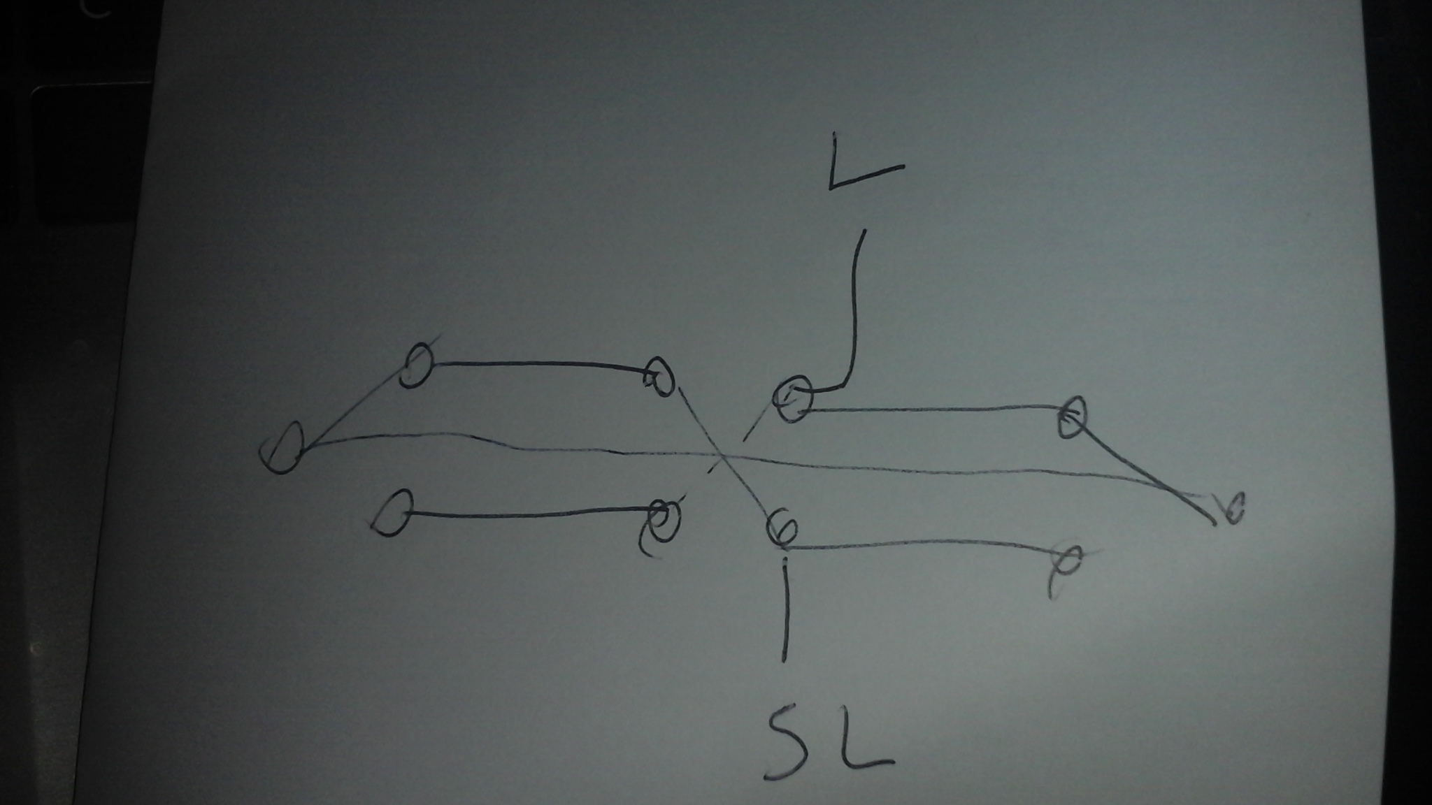

That's great I had a quote to get this done and have been told that the intermediate must be the middle switch when walking upstairs, which will involve numerous junction boxes in the loft
My plan Is downstairs 2 way
Top of stairs 2 way ... new switch...
To the left at end of landing Intermediate which is the current 2 way switch
Sounds fine to me.
Some 'electricians' are simply fixated on the way the college taught it and cannot see that the L & SL can be applied anywhere along those 2 wires.
