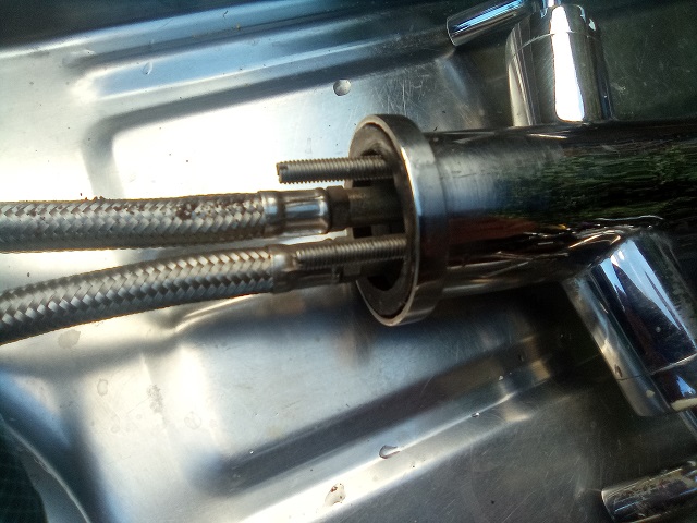

Hello!
Have a standard size/ type domestic kitchen sink. And I have a duel pipe tap that i wish to fit. but need the correct fitting so it will bolt on. please see the photo below
You have there a Monobloc tap, to fit a single tap hole sink. If you wish to use a Deck Mixer with two inlets, you'll need a two tap hole sink. Otherwise fit another Monobloc mixer.

It says mono on that. though mono was singular and not plural. but there is a hot and cold feed inlet (=2)
Monobloc = single hole through the mounting surface, with both H &C pipes going through that single hole.
