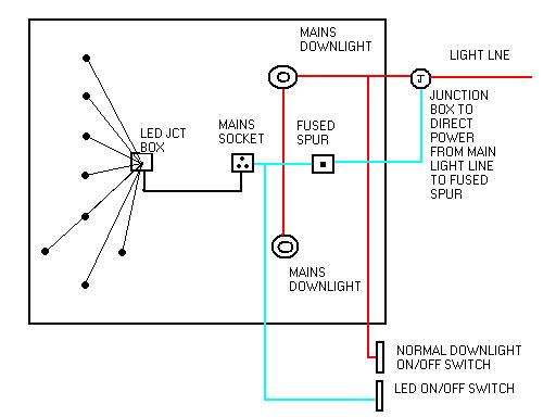

Hi Chris
Many thanks for your reply
I have done a small sketch below. Would something like this be ok ??
What cable will be ok to use ??? 1mm T&E or 2.5mm T&E
Also will i be ok to branch off the existing light circuit using a heavy duty junction box 20amp or 30amp to get to the fused spur like in the sketch
or is there another way ??
I also found a couple pf electronic transformers that go from 240v to 12dc.. Are these what you mean ???

1.0mm is fine, although the 'standard' lighting cable tends to be 1.5mm.
If possible avoid junction boxes, could you run a wire back to an existing ceiling rose with LNE available ?
Since the equipment is already tested and comes as a pack, I think this avoids Part P notification for a bathroom (ELV fixed sets are exempt).
Without fullest details I can't say what xformer would suit- but using one would mean the work becomes Part P work.
As long as you restrict the work for the switch to the outside bathroom wall and that the electrical work is limited to the fused spur + a socket in the loft, then the lighting is 'simply' plug and play- thus you avoid Part P.
Awaiting the guns of BAS :(

Why avoid junction boxes ??? do they fail alot ???
No more than any other screwed connection, it's just that if you can find an alternative it's one less thing that could go wrong. Also they are supposed to remain accessible for checking, which can be problematic.
But if you have no ceiling roses then you've no alternative.

1 last question though, to fit an on/off switch to control the leds, do i just interupt the line between the FCU and the socket with a junction box and run a T&E cable from the switch to JB ??
Also the socket and FCU are switched??? does this matter or would i need
un switched ones ???
Kris
Presumably the socket will be out of sight, so there's no point it being switched.
If you use a switched FCU then that will do your on/off, won't it...
Yes your correct BAS it does, but the FCU and socket are in the loft and i
will be damned if im dragging my step ladders out and jumping into the
loft to switch my lights on everytime.
I want to turn them on / off on a switch outside the bathroom.
Whats my solution pal ???
