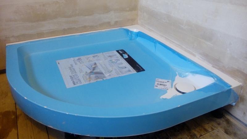

Hi,
I'm about to tank the walls around our quadrant shower tray using a Mapei Shower Waterproofing Kit. Here is the tray.

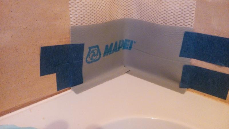

The kit came with a 10m roll of waterproof tape, I've cut a small piece off the roll for use in the photographs and I've temporarily attached it to the wall with some bits of blue masking tape.
The instructions suggest the tape slightly overlaps the tray like this.
I am fine doing this until it comes to the corner, because you end up with a ruck in the tape like this

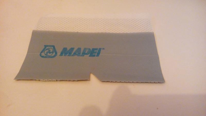

The only idea I've had is to cut a small section from the waterproof tape like this
So you end up with the corner like this
However it means there is some overlap of the tape.

Use the method in pic 4. and push that corner into a small blob of silicone to seal the cut.
Make sure that the tape is well pushed into the inside wall corner or the tile wont go into the corner.

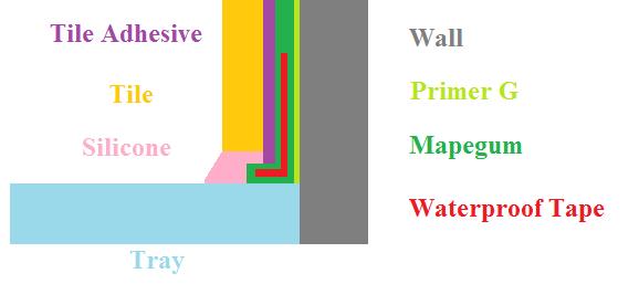

Here is an magnified colour coded diagram of how I believe it all goes together, when complete.
Thanks.

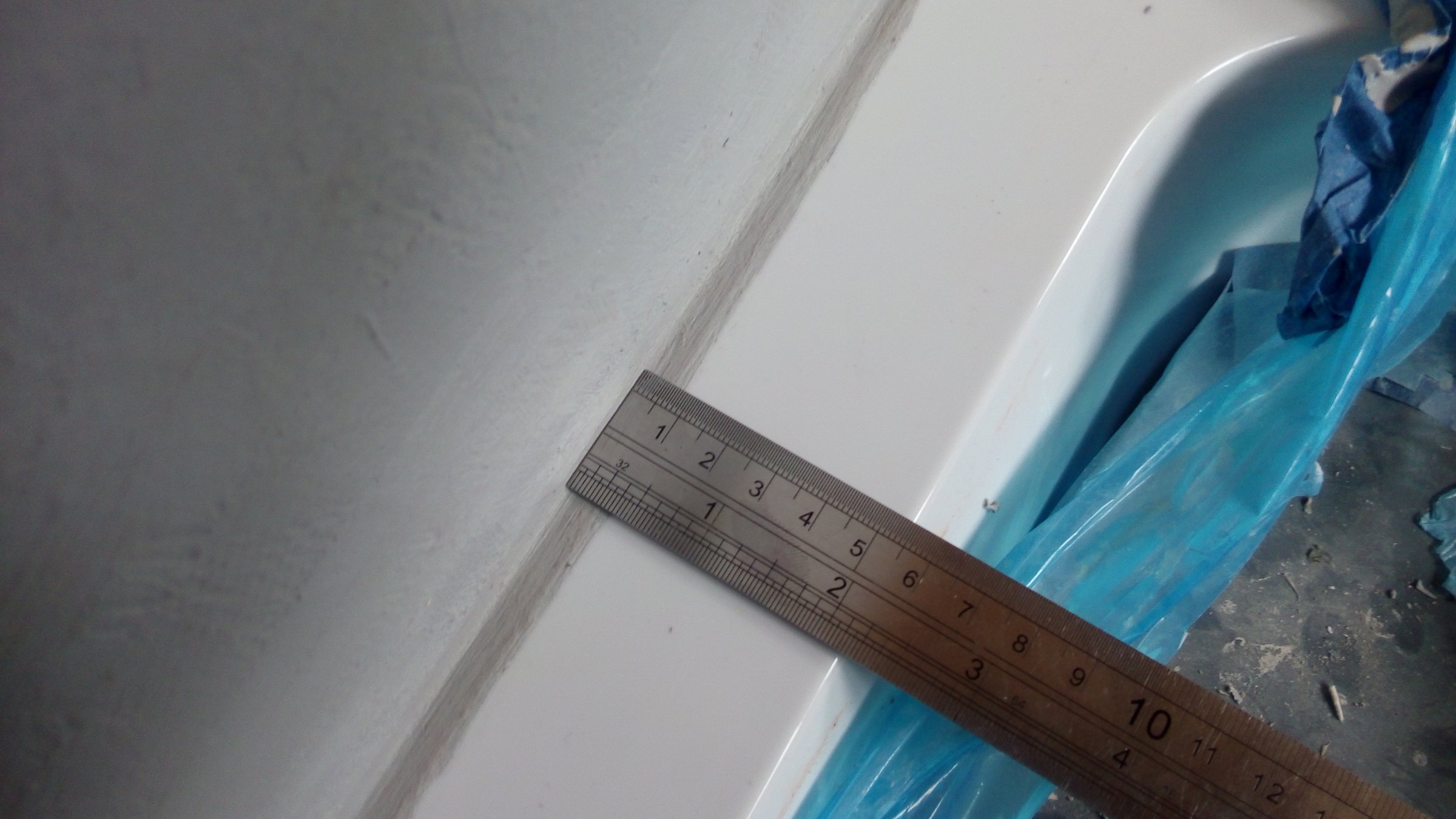

I did a 7mm overlap with the tray
full

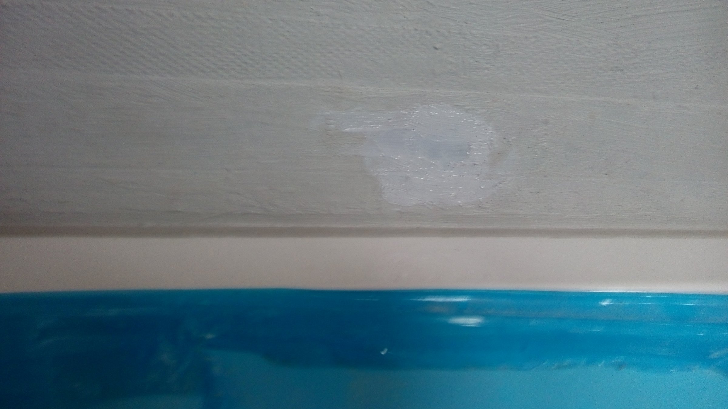

Something else I noticed, although the mapegum sticks really well to the walls, and sticks the back of the tape to the wall ok, it hardly sticks to the front of the tape at all, you can just peel it off (very poor in my opinion).
full
I touched this bit it back up
full
