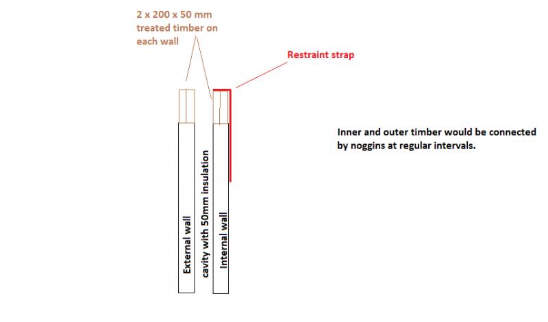

Hello people,
I'm building a single story largely glazed extension with a flat fibreglass roof.
BC has said i can use wooden lintels to go over the window and door openings. My question is how do i attach the 200mm timbers to the top of the cavity wall.
I was going to use the L shaped straps to the internal leaf and then down onto the top of the joist.
I've attached a rough drawing.
Thanks for any advice you guys can offer.
Mark.

WOW indeed not exactly what I would call a "conventional" design?
1/. Suggestions as follows?
A/. Using galvanized "coach Bolts" you firmly fix the two lintels together, both the outer and inner. If you fit these "Coach Bolts" with the heads into the cavity so that they will not be visible from either the room side or the outside then that should be aesthetically "pleasing" the use of washers under the heads of these devices is advisable.
B/. Should these things not be "designed" by a competent "Engineer"?
C/. Turning now to ensuring these two "independent" "beams" in some way act together? and support each other? And at the same time have an inherent "monocock" function?
The insertion of noggins between the pair of Lintels would appear "prudent"? Plus at these points it could be thought that some form of firmly fixing the two twin Independent "Lintel units together" is worthy of consideration?
the use again of suitably long "Coach Bolts" on this occasion inserted from the "inside" [plus washers under the heads of the bolts] could form a reasonably "Stable" beam like system?
The bolt heads could be left "proud" of the surface? [dependant on surrounding "finishes"] or recessed and the circular holes filled with "Plugs" of the timber to which it has been fitted?
As for your "Idea" of hold down straps, YES! BUT! ?
How about fitting these straps, not only over the Inner lintel, BUT extending to fit over the pair of twin lintels? the thinking here is that if you follow the above, you are constructing a twinned two part "Beam" "System" comprising of four individual "elements" all firmly tied and bonded one to another?
Following on from the above [If you are still awake ! ! !] if you fix these hold down straps on or as close as you can to the Noggins and coach bolts between the outer and inner lintels the overall tie down and improvement in overall "strength" of the entire design should be improved.
Conversely, "obviously" depending on where you can get a really good solid Hold down fixing could dictate where the hold down straps Et All are fitted?
Hope this has given some Ideas?

Hi Ken,
Thanks for the reply.
Building control had told me the size of the timbers but not their prefered meathod of fixing down to the wall or wallplate.
Your answer has been most helpful and from what I understood is what I had in my mind.
I've emailed the drawing to my building inspector as I dont want to do anything unless he is happy. Weather has stopped play again! so I can patiently wait for his reply.
Thanks again.
Mark

I am not sure I understand the question. Your drawing shows 8x2" treated timber doubled up on top of each wall? are these walls made of masonry?
Screw them together with the relevant space in between filled with celotex and the odd noggin, your roof boards and windows should do the rest.

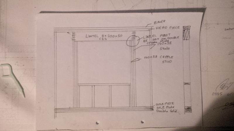

I've done a sketch for you showing the details of timber lintel details in timber kits hope it helps you to understand how it should look all timbers should be c24. The outside wall can have a concrete lintel or a steel lintel. Must be seated on at least 100mm either side. I build kits every day your idea with the restraint strap won't work and isnt needed. Nails should be 90mm at least for a nail gun approved to eurocode 5 class2 service. Lintel needs to be double nailed every 150mm each timber lintel. The cripple studs need to be double nailed every 300mm
