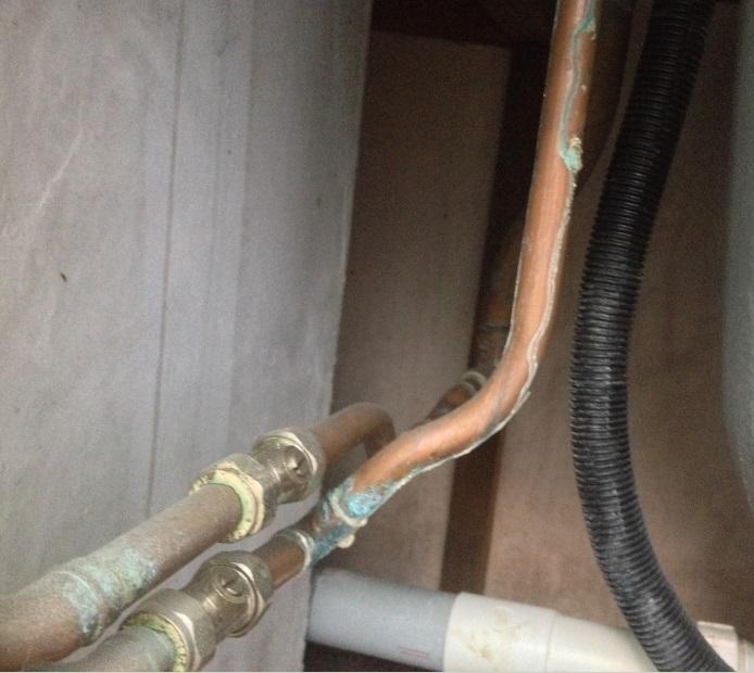

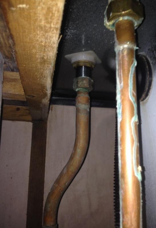

I'm still confused but here are a few images that may help.
isolator valves
taps
[/img]
is it possible to identify what connection type these are?
They look like normal soldered tap connectors at the tap end and a normal soldered T at the other.
You can get flexible push-fit tap valves with a tap connector one end and a push fit the other. That means you could isolate the supplies (I see you already have isolating valves) cut the pipe then fit the 15mm push-fits on the supply ends and screw the tap connectors to the new tap unit.
You also get compression to tap fittings if you prefer.
If you have a high pressure system (combi / thermal store / unvented cylinder) then probably the simplest fix is to get two long flexi hoses, cut the pipes and fit the flexi's crossed over.
If you have a vented cylinder it would probably be worth re-piping it without flexis as you may encounter a low flow situation, although large bore flexis are available, they're less easy to find. As Belboz says you can get flexi's with iso valves built in, or use a compression iso valve, some of the left over pipe, and a flexi.

Agreed but he already has isolating valves for the hot and cold tap supply according to the pics.
Or am I wrong??
The crossed push-fit flexi's will be fine then (It's a combi).
