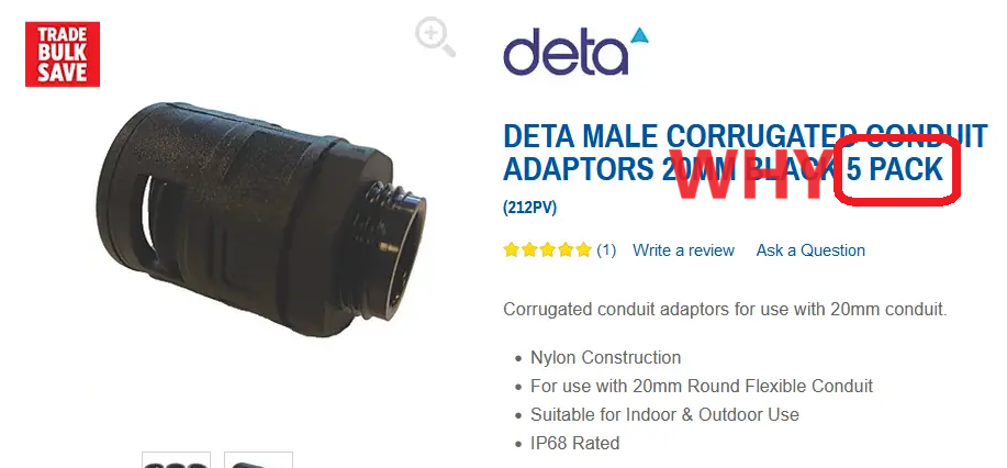

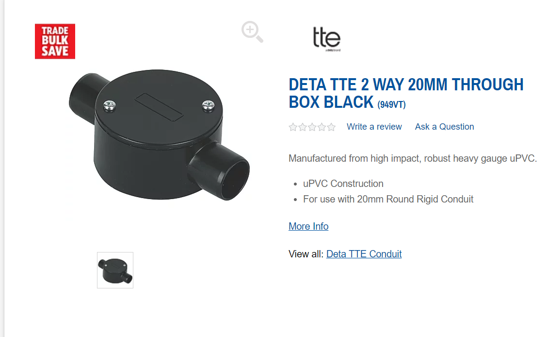

I am looking to use this for an alarm cable.

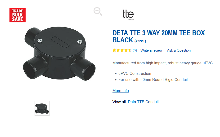

It will be easier to push through a route that has some obstacles. However, I do need to tee off in places and also use two of these in different sections.
Will it just slip over these type of fittings or do I need to use some sort of adapter?
Thanks in advance.

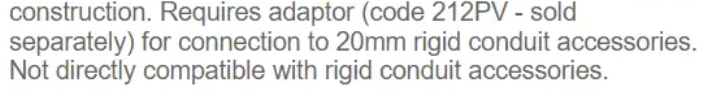

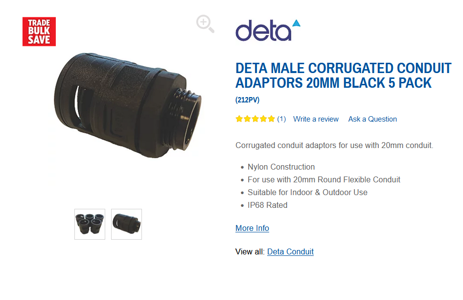

They need an adaptor, which is 20mm threaded. So you will need an adaptor, from 20mm, to adhesive conduit, then the 2way box.
Personally I have never had a problem with solvent welding plastic flexible conduit directly into fittings...
However I see this is described as 21.5mm OD and as such is the first time I've come across it being bigger than rigid.
This is the correct adapter
and quite likely the threaded male thread on them will solvent weld into any conduit fitting such as these

This is the correct adapter View attachment 358341
and quite likely the threaded male thread on them will solvent weld into any conduit fitting such as theseView attachment 358342

Yes. The description of the flexy conduit actually tells our friend the part he needs. I despair sometimes...
