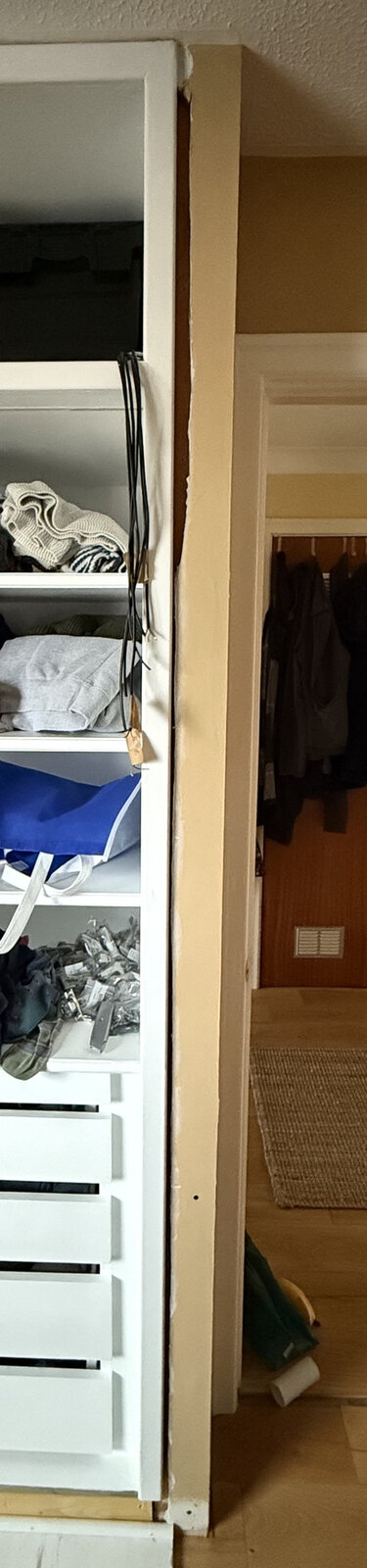

I recently replaced a built-in wardrobe and whilst stripping out the stud wall that made up the old wardrobe I cut the plasterboard too far beyond the edge of the new wardrobe and now I have to repair it. I have a thin slither of plasterboard now missing along the whole edge of the wardrobe:
I'm wondering how best to repair the plasterboard. I've only ever repaired small holes and filled in old electrical boxes, nothing as large and near to a corner as this. I can think of a few different approaches. Probably the neatest would be to remove the whole plasterboard panel up to the corner and replace it with one long thin slither cut from a larger stock. Would I then have to install a mesh to protect the corner, and if so would that need then plastered in on both sides of the corner? That sounds like it could be a major piece of work but I guess should look best? Another approach could be to neaten the existing cut edge by making a new cut parallel to and a few cm right of the wardrobe trim, then replace with a new long thin piece wide enough to slot behind the trim. I fear it might be tricky to blend this in to the existing plasterboard and not end up seeing a seam there once finished.
Any advice appreciated!
Remove that damaged plasterboard and replace.
Put a 3mm stop end bead up the front corner, and another against the shelf side panel and skim up the front edge with toupret powder filler.
Having 2 stop beads will make it easy to level as they will act as a guide. You just need a scraper blade wide enough to bridge the two stop end beads.
Or, squirt with expanding foam, let it set fully, scrape off the excess inc 2mm below surface and then use filler to bring to surface level.
If everything is remaining white cut in a flat strip of UVPC trim to finish the edge.It will look like part of the wardrobe.
