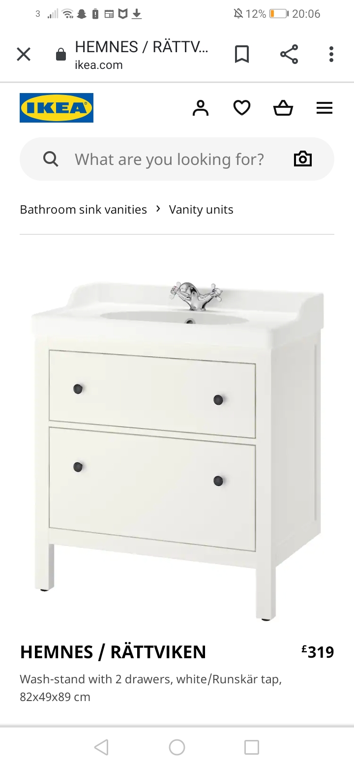

It's for a vanity like this legs at the front, fixes at the back to the wall.

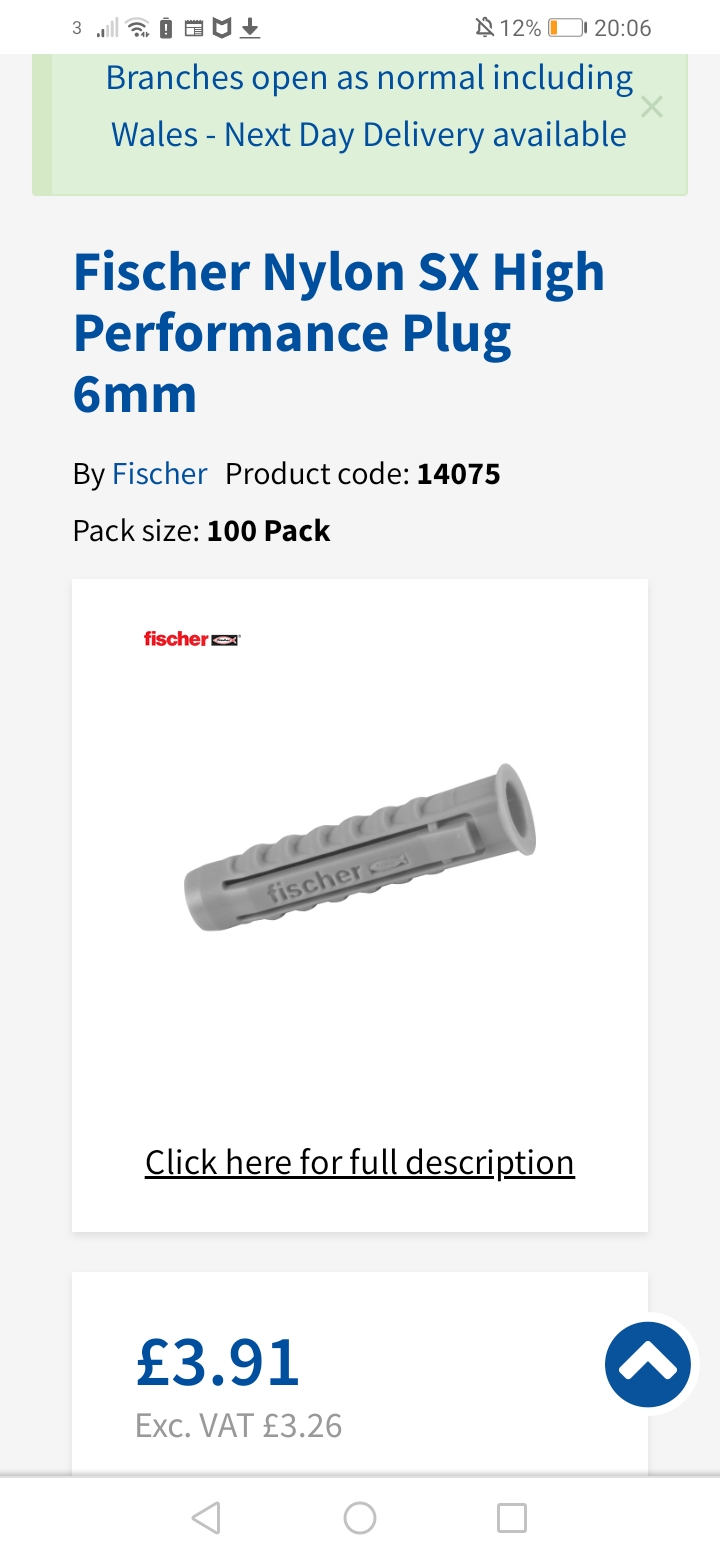

You mean these?

Yep, that’s all you need.....those Fischer plugs have a spline to stop them rotating and grip very well.
If you want to go for a larger plug, the SX8 is just the same design.
Drill nice and slow - I like to start with a 4 or 5mm masonry bit before going for the recommended size.
Good luck with your project!
John :)
The weight of the vanity unit is held by the legs so its necessary to prevent it pulling away from the wall....those fixings are fine.
I’d go for a 5mm diameter screw - I think that’s a 10 gauge but you’ll feel resistance if its too big.
John :)
Ikea stuff is poorly designed, I added a extra strut to lower rear to secure the unit top and bottom
I'd just do as burnerman says but also run a bead of silicone down the back of each leg. Once it's gone off the unit won't be going anywhere.
