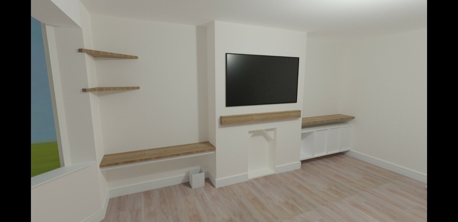

The idea was as follows:
1. The bench would be slightly higher than the rough example in the post description.
2. The bench would be about 10-15cm above sockets but ofcourse id be extra cautious with any area there. There is a socket that's quite low hidden behind the breast. I'm quite sure it comes from above near the ceiling.
3. The bench would have all 3 sides of the wall to support the weight off. Id add frames to left, right and back section of the wall.
4. The bench would be floating. I have a rough render of what I thought it might look like below. Though idk if that's the final design for everything but thoughts are welcome
