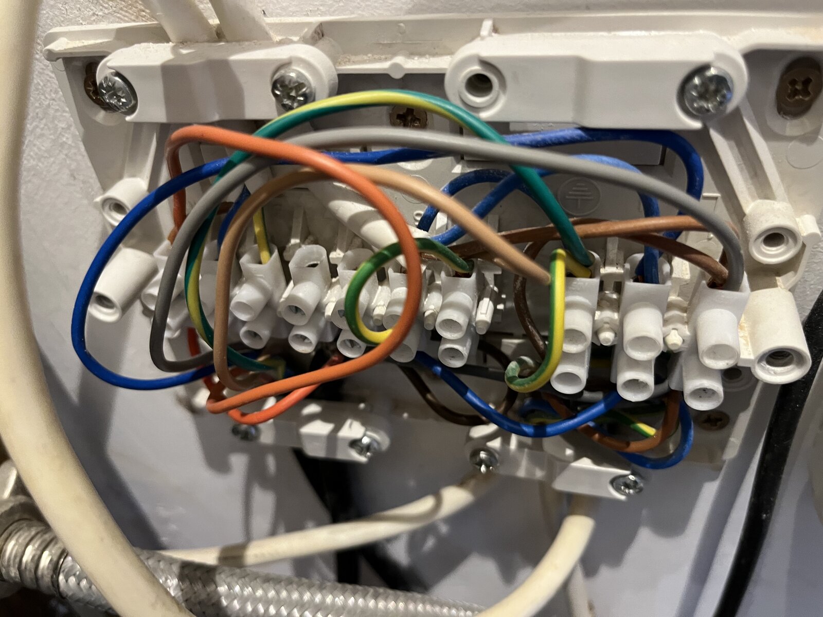

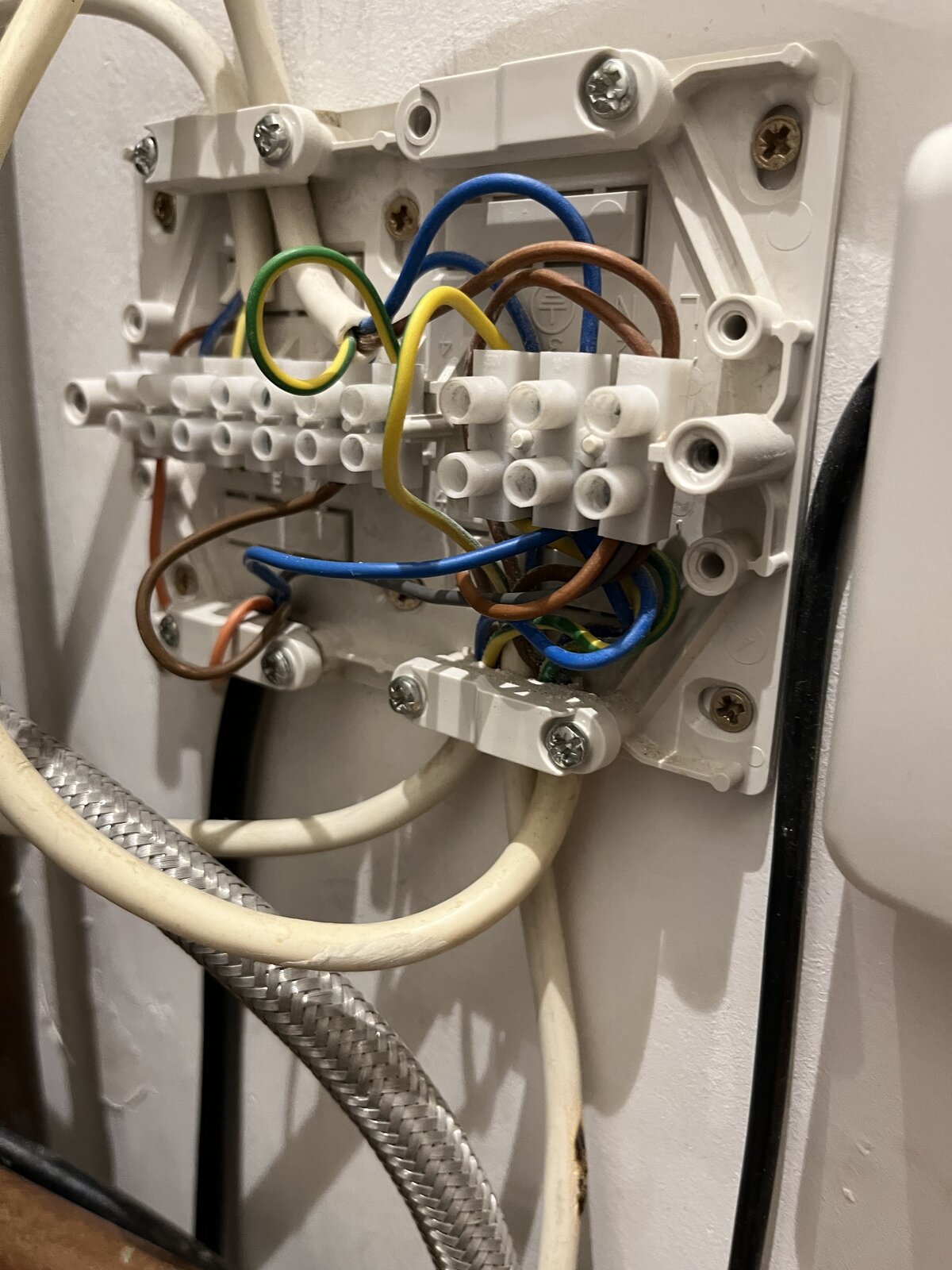

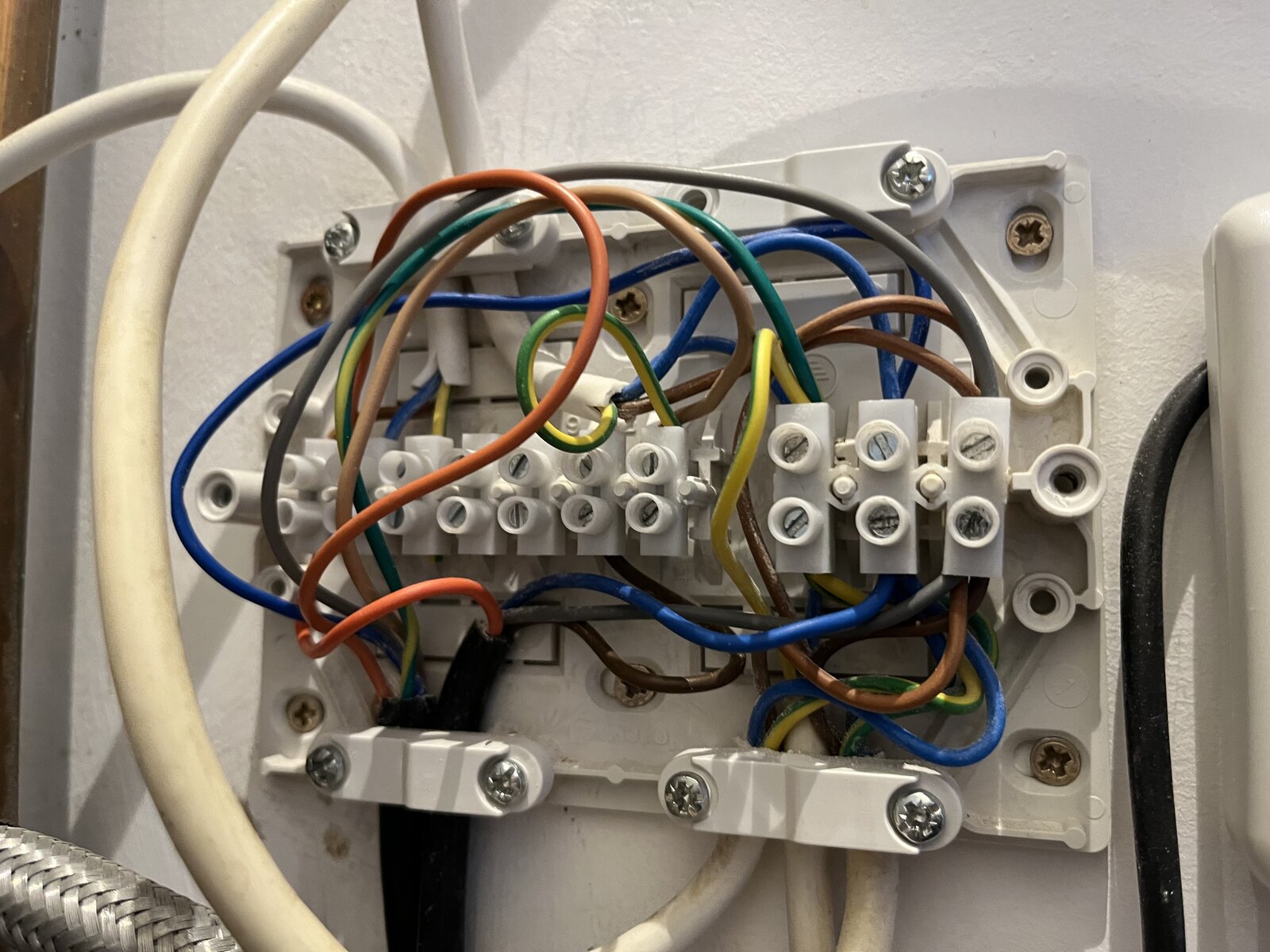

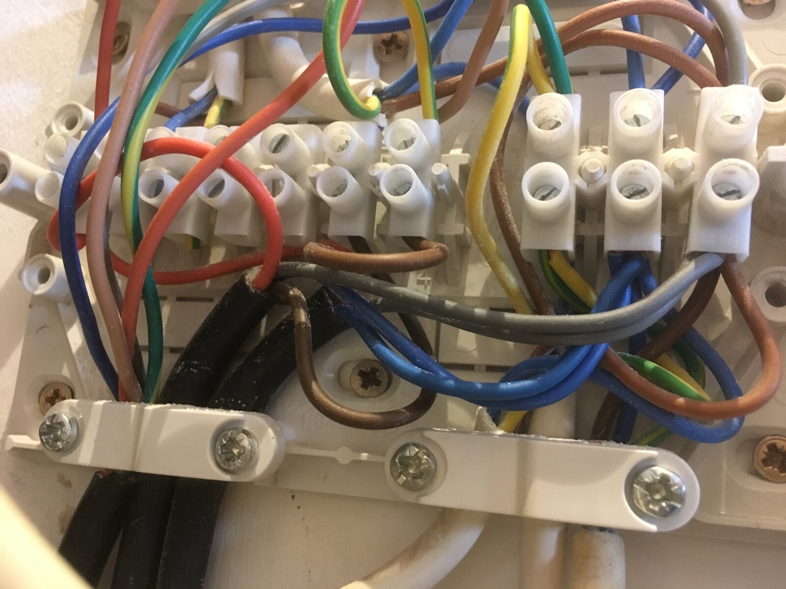

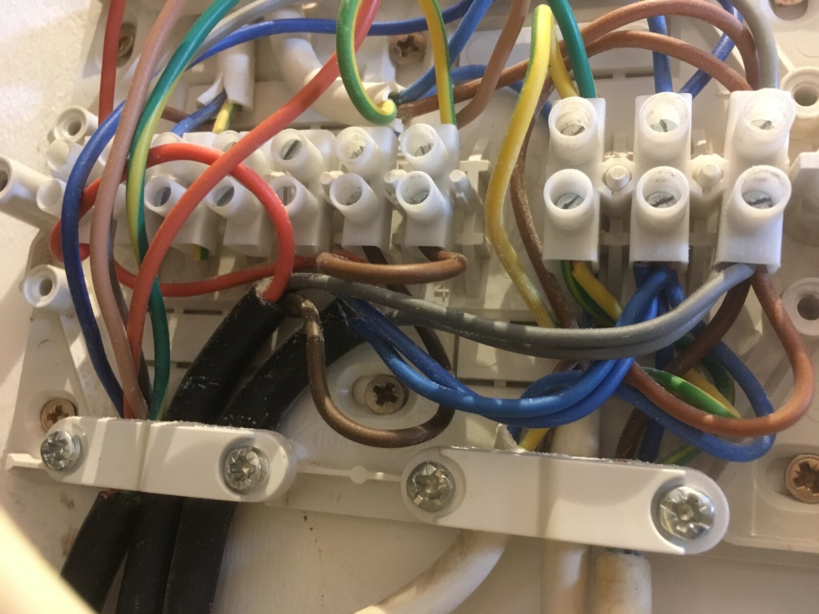

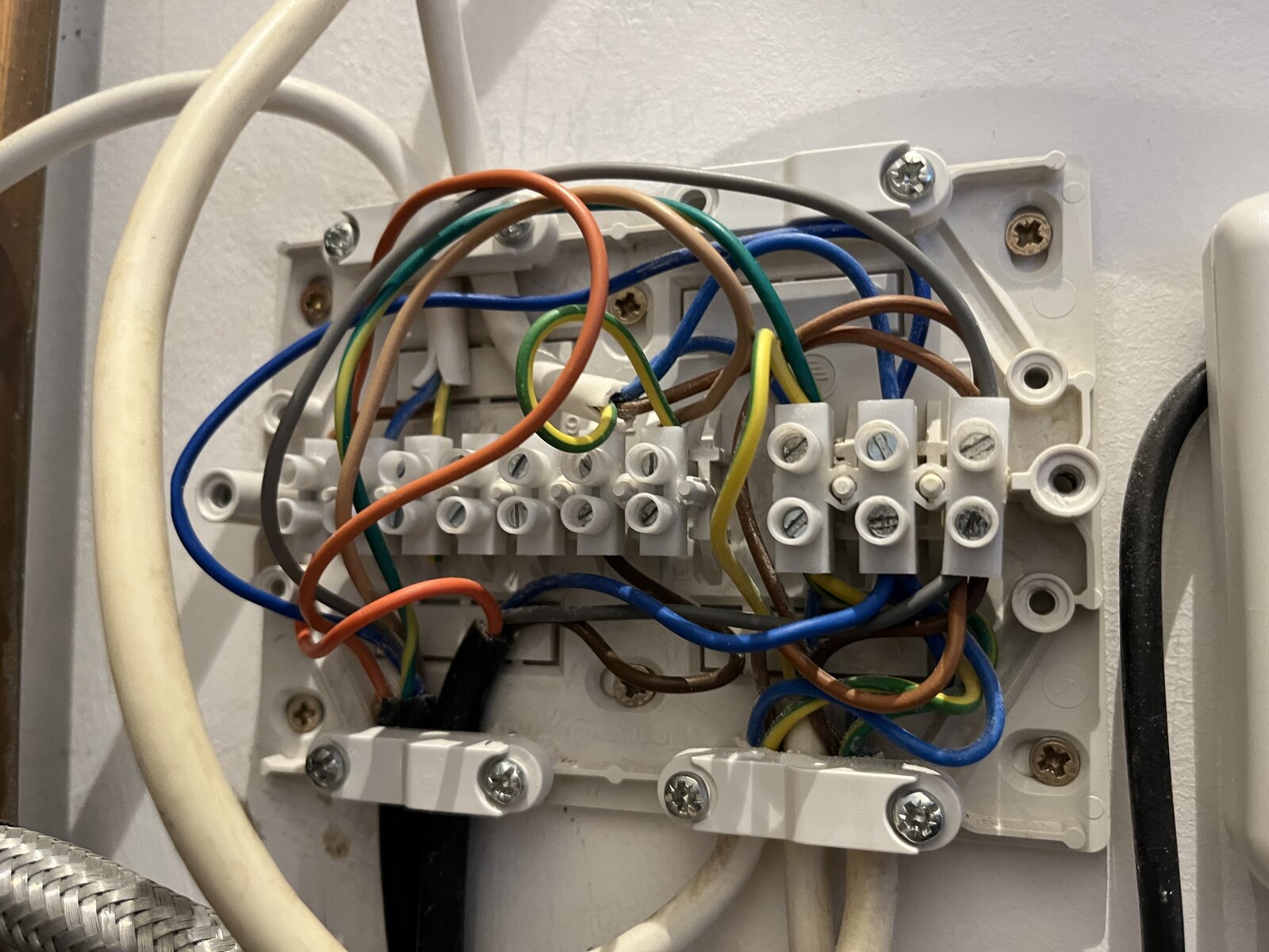

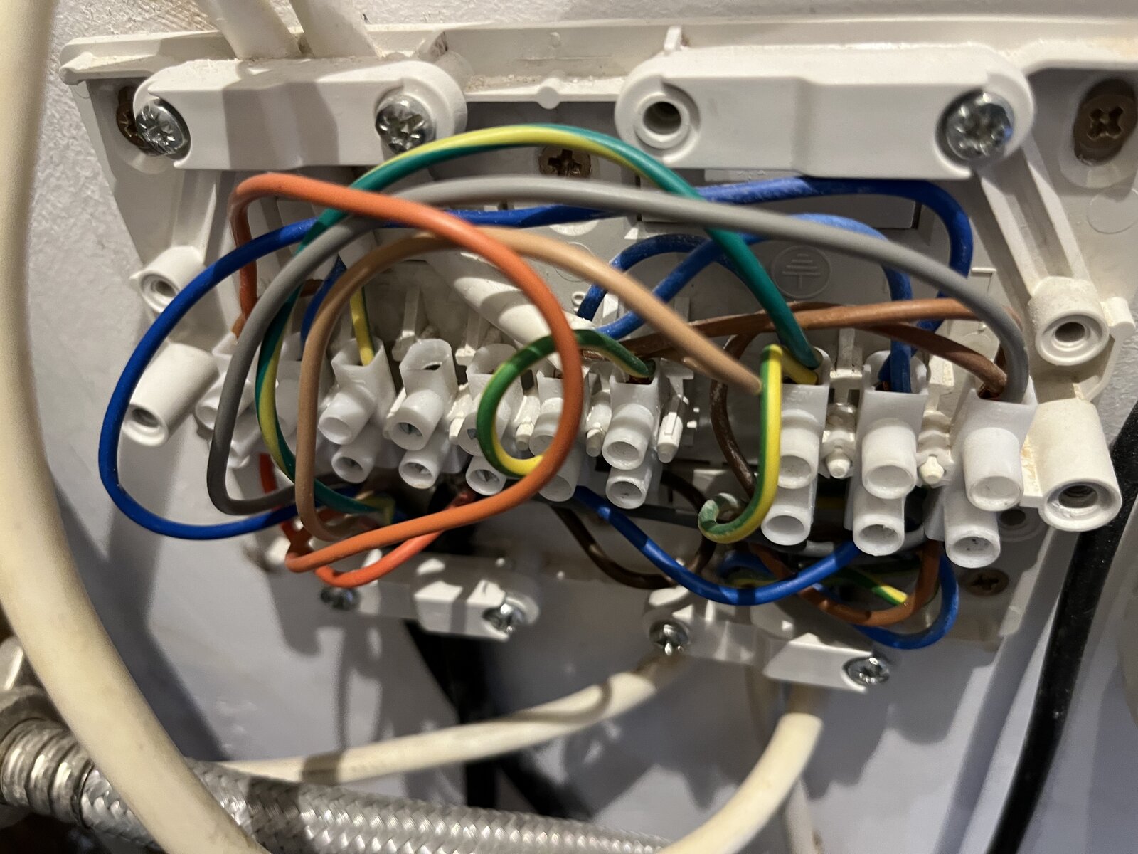

Here are 3 pictures when 3, then 2 and finally only 1 actuators where in place (big black cables at the bottom left of the wiring box):

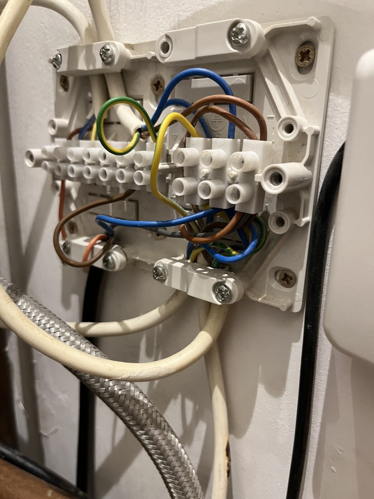

Sorry, with 2 cables is the picture below.
The cable coming from the BDR91 is the right white one at the top left. As you can see, on the last photo of the previous post (8517), the green-yellow cable (in the ~middle connector, just before the gap) leads to nothing, while it was connected to a light brown cable coming from the Honeywell actuator before (picture 7528) and also to a brown cable from the additional HPA2 actuator that was first removed a couple of years ago (picture 3275).
So your switch live from the BDR91 should go to the brown of the motorised valve, which in turn should drive the motor open, making the microswitch at the end, sending a switch live from the permanent grey live to orange. Similar operation from the cylinder thermostat and ufh.
