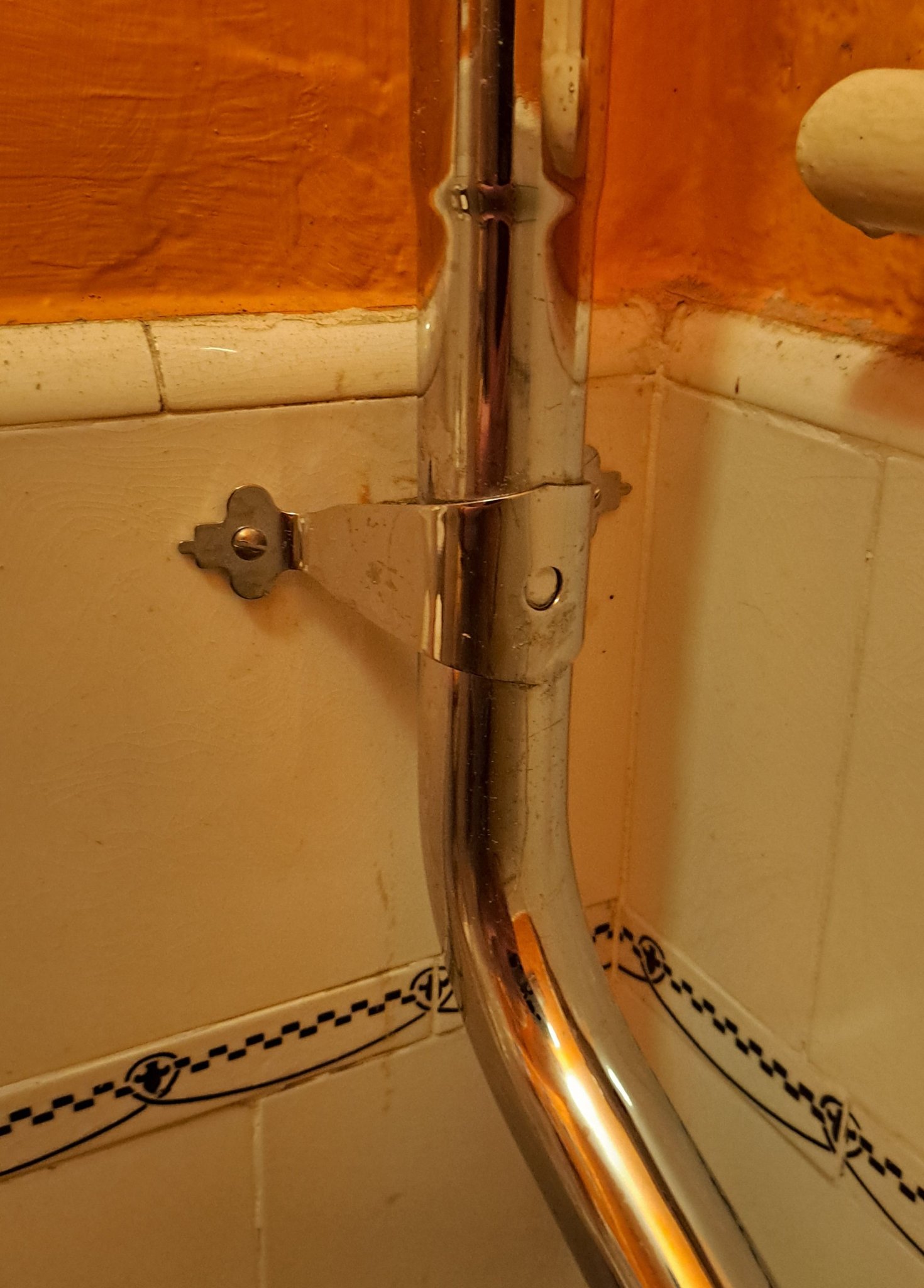

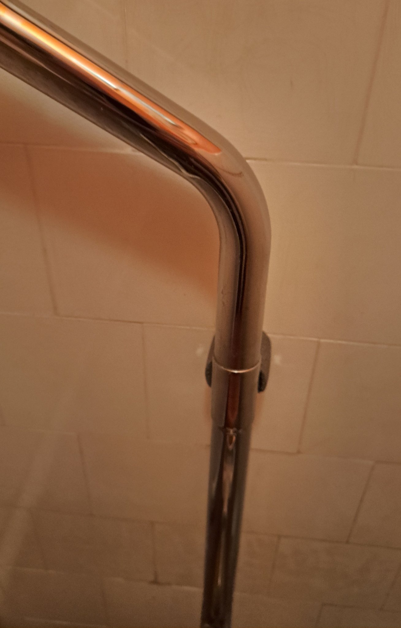

We recently had a new toilet installed and the water pipe is supposed to be held on the wall by two brackets. However the toilet had to be installed further from the wall [1] so one of the brackets will not reach the wall.
Bracket screwed to wall by our plumber
Where the other bracket should go
Ideally one would drill into the tiles, insert rawlplugs and screw the board on. However I have never drilled tiles before and I am worried about cracking them. So my plan is to fix a board to the tiled wall and then screw the bracket to this. The board will be 10-15 mm thick and there will be minimal load, the brackets are to stop movement rather than to hold the pipe up.
So I wonder if I could use some sort of adhesive to stick the board to the wall. If so what sort of adhesive would be appropriate.
1. The toilet outlet is intended to go out horizontally through the wall, but the existing outlet is in the floor. To line up with that outlet the toilet had to be moved forward.

Just use 10-15mm spacers behind brackets neater than a board .
I thought it was obvious from the first photo that the bracket is not actually connected to the pipe, so spacers would not be of any use.
The bracket relies on pressing the pipe back against a block of plastic (not visible in the photo) which in turn presses against the wall.
@foxhole, did you read what I wrote?
The bracket is not attached to the pipe, so spacers would obviously be useless.
The bracket stops the pipe from moving forwards and the block of plastic (pressing against the wall) stops the pipe from moving backwards.
Spacers would hold the bracket in place but there would nothing to stop the pipe from moving backwards.
I have no idea what you mean, because you have not made any attempt to explain it in your multiple posts.
Spacers behind just the screw holes in the bracket would enable long screws to reach the wall and be hidden. Thus the pipe could not move forward but it could move backwards.
A spacer behind the entire bracket (holding the plastic block against the wall and thus stopping the from moving) is a board attached to the wall.

Three spacers , one behind the pipe .Or flame ports suggestion.
Sling that 'bracket' away and install a brass munsen ring with backplate and an extension piece of the appropriate length.
One of the more ridiculous suggestions I have seen.
The brackets came with the water pipe and match it. Why on earth would I, or anyone, want to throw away a functional matching fitting, then buy and fit a non-matching one that (most likely) will not work.
Three spacers , one behind the pipe.
At last you have explained what you mean. That would have required extra work to shape the middle spacer to fit the back of the pipe.
And your only reason for this was aesthetics and that, IMO, would look a lot worse.
Easy job , white spacer would match you almost white walls .You mention atheistics while proposing an abortion of a solution .
