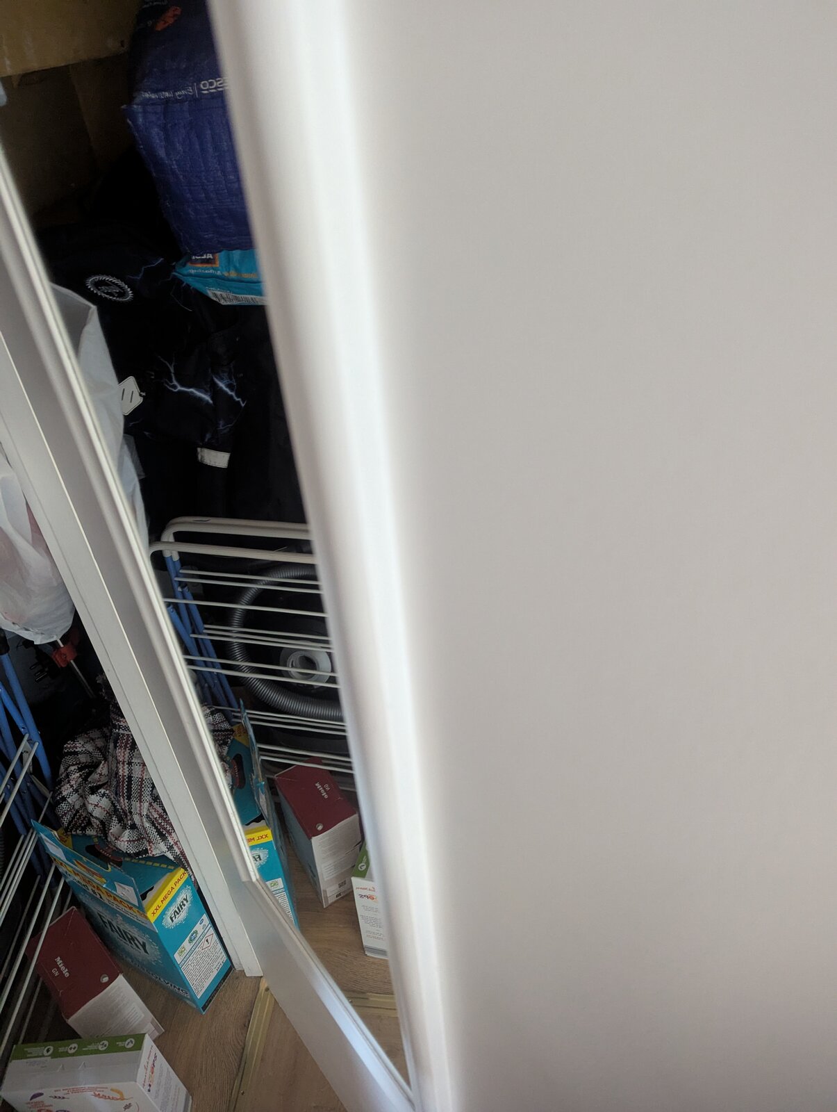

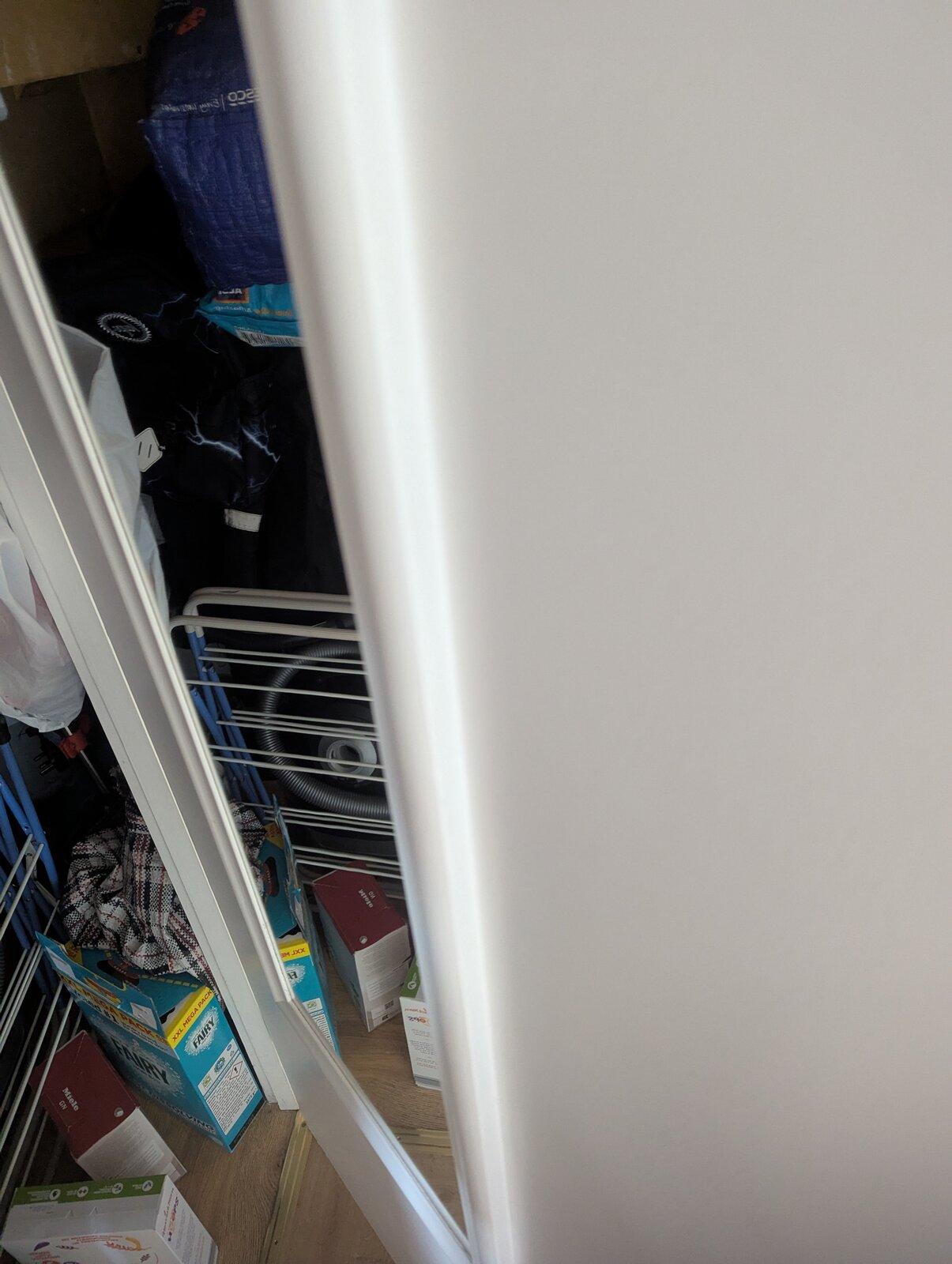

This heavy mirror is stuck on our cupboard door at home. Been there for 15 years. Hinges are holding although I can see them showing signs of stress
Hi. You didn't say what was on the door. Paint can be well stuck on and polymer really sticks.
Yeah, good idea to dig through to wood.
how many hinges? and could you hazard a guess about the weight of the mirror?
if i had to replace the hinges in 15 years due to the extra strain from having some towels and dressing gowns hanging behind the dooor....
i think i could accomodate that expense :P

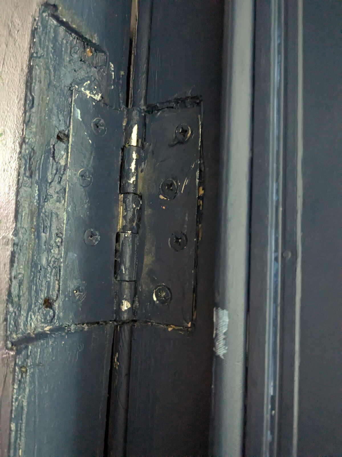

oh also on the subject, would it perhaps be a good idea to replace my existing hinges?
This door, (every door in the house i think) has these pretty standard things. Four screws on each side, five interlocking sections with a central rod.
one of these near the top and the bottom
Surely there are Better Hinges that can handle the extra weight more comfortably. Like different shapes or designs
It is also worth noting that on this particular door everything is inverted. Because my bathroom is tiny and the door opened inwards, i desperately needed to make better use of that space, so i paid a carpenter to rebuild the doorframe, flip my door upside down and reattach it so it opens outwards. This was of course in the dark days when i was blind to the wonders of construction, now i could possibly do that myself
A handy design when decorating, is the type of hinge which includes a removable hinge pin. It makes it much quicker to just knock the pin out, to take the door off, than unscrewing the hinges.
Eclipse Grade 7 stainless steel ball bearing hinge I have

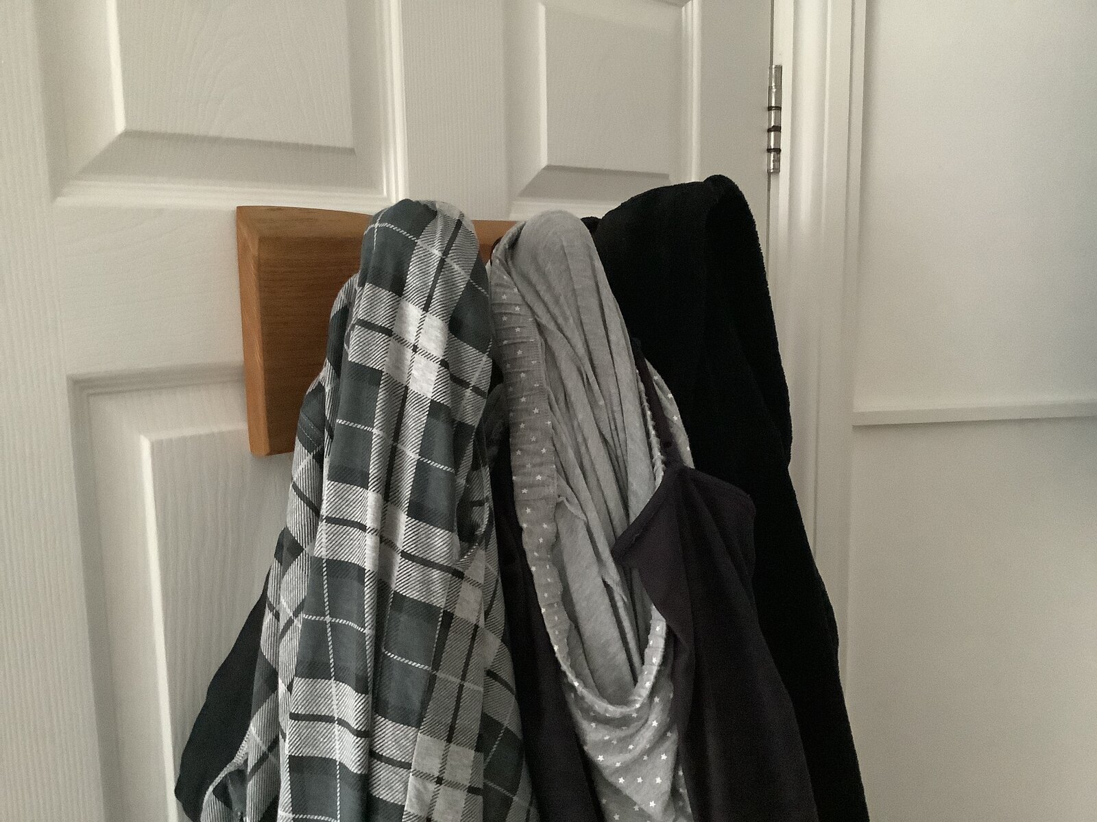

You can get over door hangers. Hollow doors are tough to get stuff to stay on with screws. Keep it to a dressing gown is okay but youngsters will hang all sorts off a hook. Just fixed grandaughters wardrobe lower shelf as she used it for a step ‍:rolleyes: its chipboard sitting on a 6 mm peg!
Plugs are a no no on hollow doors, large thread screws should hold but not to single hooks. Never needed glue .Screw hooks to timber then timber to doors, my heavily loaded bedroom door is just fine with this method.

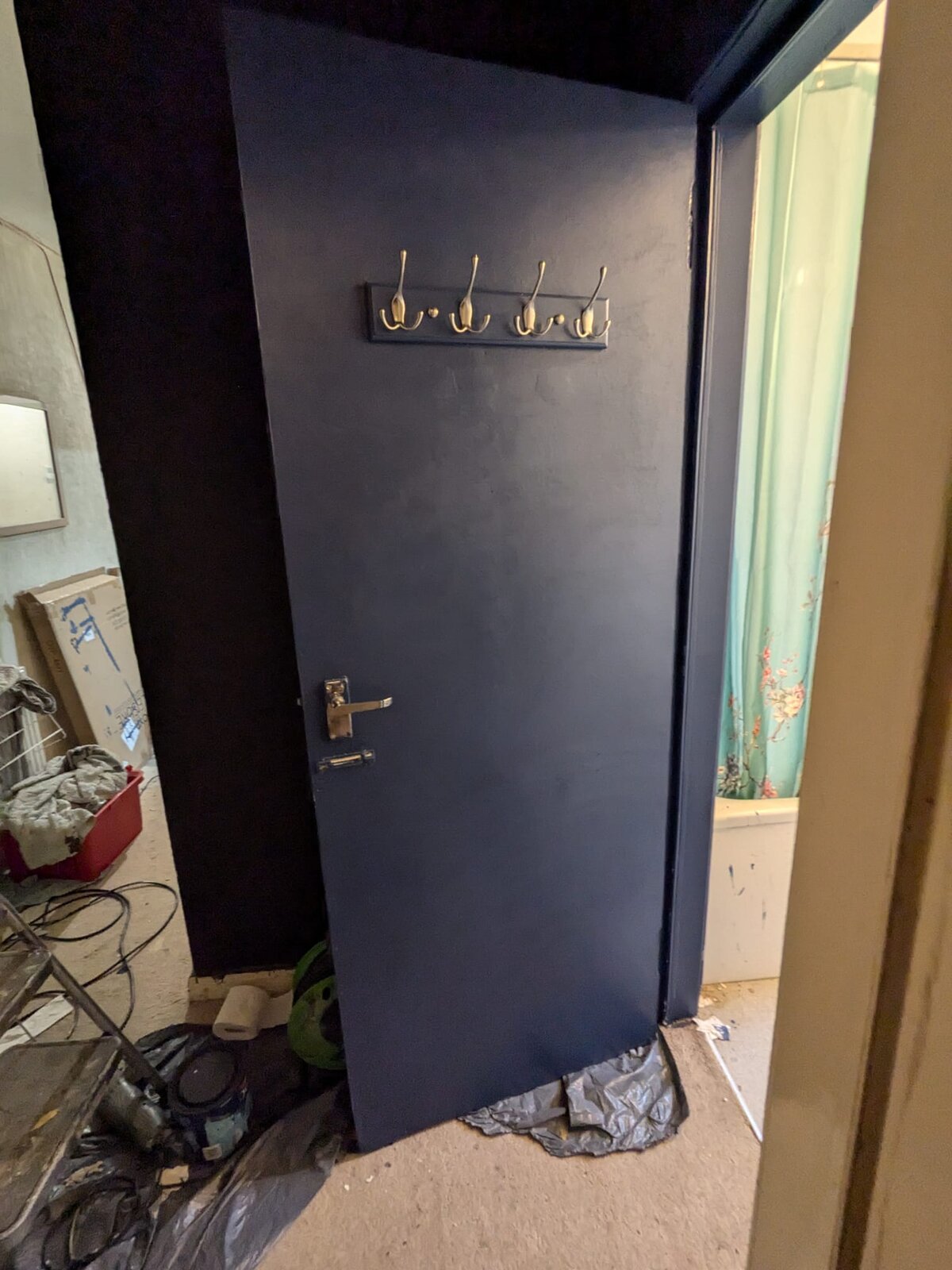

Well i got it working in the end with those damn hollow door plugs
The trick, it seems, is to NOT follow the instructions on the pack, and instead to use a significantly thicker and longer screw. got some 60mm ones that almost (but not quite) poke through the far side, They definitely do poke through the central support panel of the door and i think that is providing a lot more grip too
and now my bathroom door has a real neat hanger
i'm thinking in time, i will repeat the process for a towel rack farther down, and do the third hinge as wayners advised above
