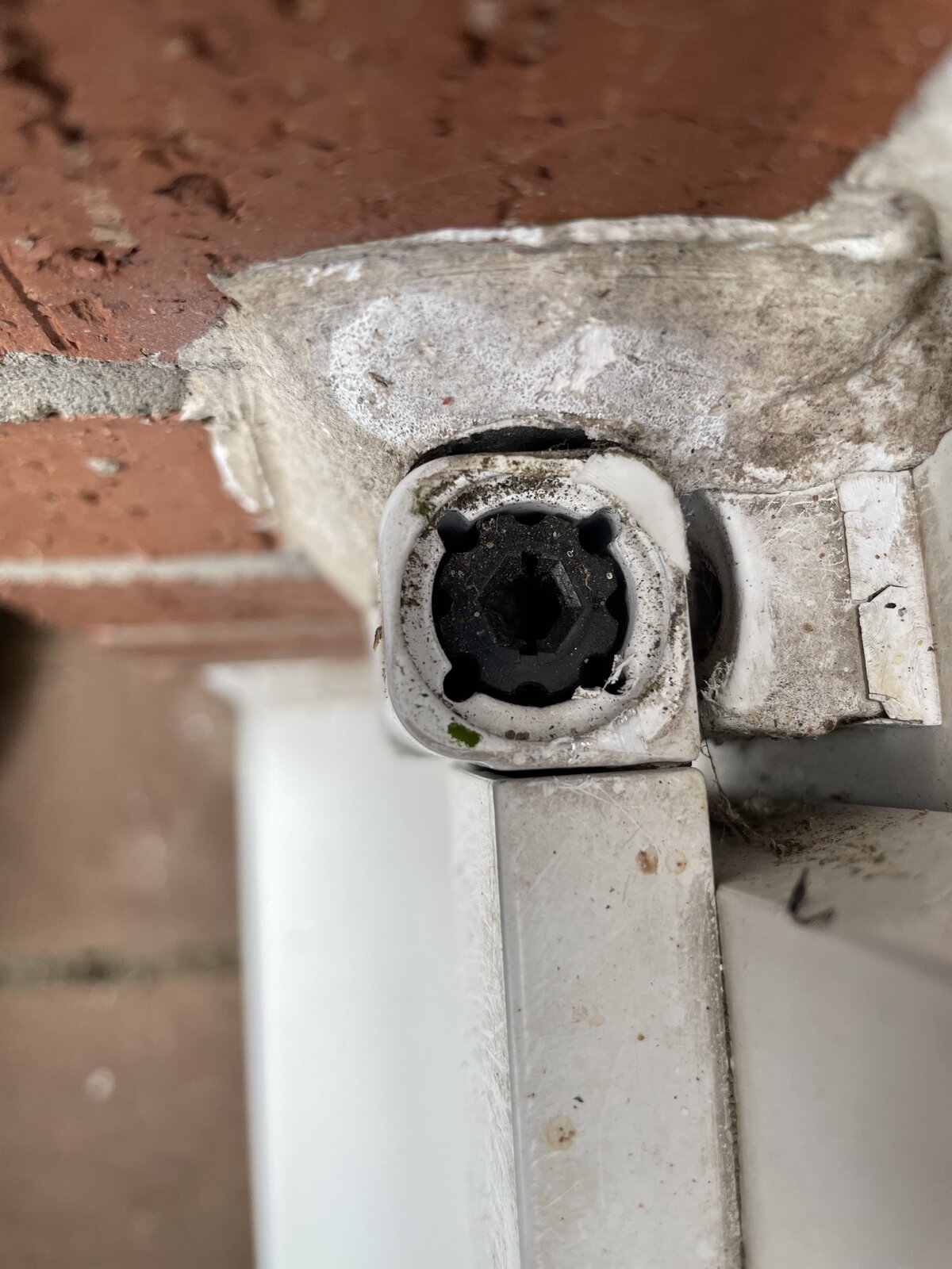

Is this adjustable? I’ve already adjusted the bottom bolt & side bolt to realign the patio door with the other side but I’d like to move it a little closer at top / bottom.
Or does the bottoms bolt do this? Both side & bottom are metal screws adjustable with Allen key. The plastic ones at top of each hinge will not budge.

Yes they are but they look like they've never seen any.oil so will be stiff or seized, soak with WD-40 and try again maybe also lifting the door to take the weight off the bush, note that once you've turned and are happy with the position then at least one of those holes needs to line up possibly two, the cap you probably took off may have a pin or 2, those pins need to go in the holes and locks the bush in place stopping it from unwinding itself with constant opening and closing
Thanks. Two of the three hinges are missing the plastic caps. I’ll some wd40 & see if they will turn as you suggest.
