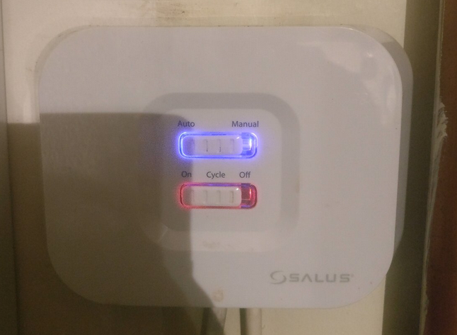

I've recently moved into a house which has Ideal combi hooked up to Salus RT505tx receiver. HW and radiators have worked fine since yesterday, when the receiver, which was formerly lit with blue and green lights, now flashes purple (top) and red (below).

Without any knowledge of the stat, so could definitely be wrong!
But, are you sure it's not flashing blue?
A flashing blue with a lit red underneath, could easily appear to be purple! :)
Fair point, I recall the blue was quite bright but there may be an effect with the red underneath. I've added a screenshot as a guide.
If it is blue (or purple) could anyone still someone shed light on the fix? Many thanks

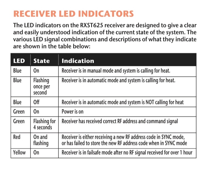

Although this doesn't relate to your model, I suspect the procedure will be similar!
Yes, hopefully a simple DIY job! :)
