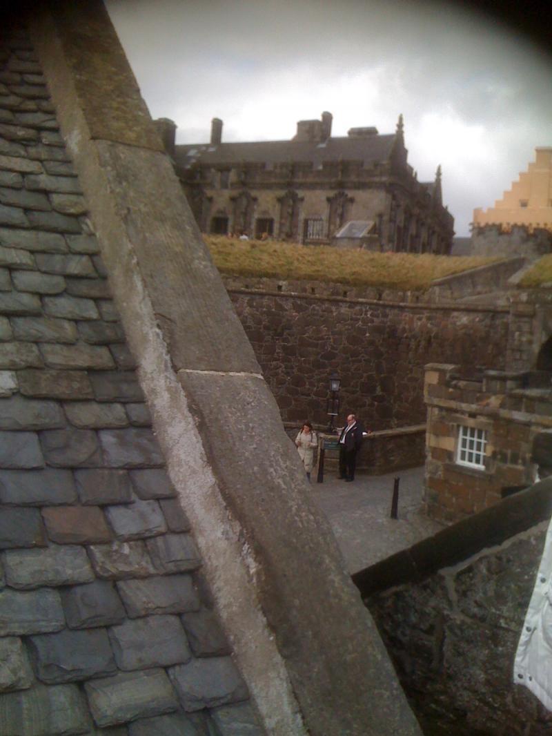

Firstly, apologies I have a few queries on the forum. I've just come back from the house and I have a lot of thoughts buzzing around but I'd like gain some opinions from people more experienced.
The kitchen extension on the house (photo links below)
Has no flashing, it has a cement fillet. Should I remove this and install some lead flashing (no evidence of leaks at present).
The ridge tiles need taking up and re bedding, but I can see quite a few gaps between what I assume is a cement bed the tiles are bedded on. Should I fill these gaps?
Lastly, the aluminium roof light needs to be replaced, it's approx 60x80cm. Is this going to be a bespoke item to replace. Is it a relatively simple task to replace.

The cast skylight can be replaced with a velux.
Removing the cement fillet will take out a load of slates with it...i would leave it.
If you are taking off and rebedding your ridge tiles you wont have any spaces.
I'd not considered how well the fillet could be bonded, thanks. Could I use a wider lead and flash over it?

just me but ive never seen torching like that. is it because the house is exposed to weather?
if youdo mess about with that torched on roofin slate for the velux you could think about doing the whole roof to modern standards.
sods law the fillet an ridge will play up as soon as you occupy the place. the fillets failing near the top and its running into the window sill

Thats the way it was done in Scotland in years gone by Bob....still is on older buildings.

I had to Google 'torching' so I'm staying with the conversation :) ( I thought you had referred to the flatter extended roof section) i might need to investigate from inside to see if it's sound, and I'll need a lime based mortar mix to keep it breathable if I do rake anything out to tidy it up.

I would imagine it was once quite exposed, but developments around this plot now shelter it considerably. Circa 1960 it appears a large retaining wall and 3 storey house got built which now protect that exposed side to the west, and another high level line of terrace houses protect from the north.
