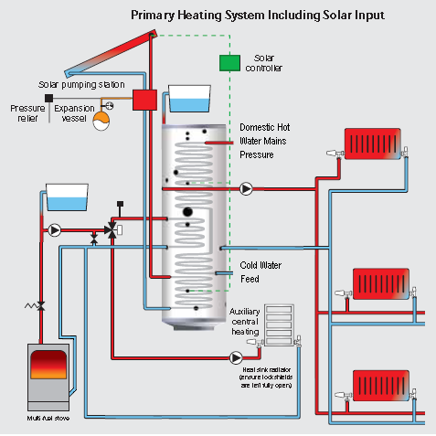

So we are not looking at common sense, we are looking at options permitted by the government. I have seen this Torrent pipe example.PNG in one home, my brother-in-laws, and yes it worked, but when he moved, he was quoted a silly figure to fit it in his new home. It is only really an option when installed from new.
Already pages and pages about the Willis system, why did I not fit it, simple could not find anyone who knew how to fit it. I live in Wales not Ulster.
