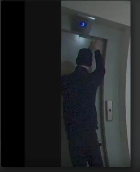

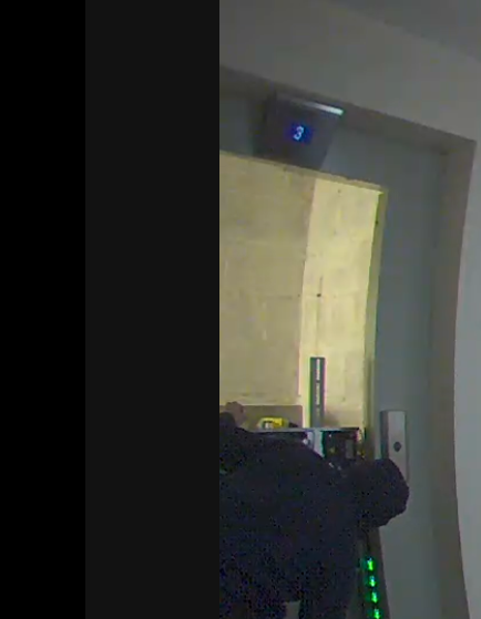

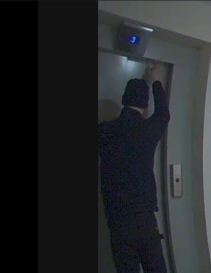

Specialist is on site right now.. Oh, it's so exciting :giggle:
Asked the chap if he knew what the issue was.
He said that it was 'too early to tell but the door is sticking on the 3rd floor' and he will work on it.
Will update when i have more info..

All sorted..
Cause - obstruction causing door jam
The Specialist made some adjustments around the door. He then took a screwdriver to clear the door track.
Chap took about 20 mins
To get the door open, he used a service key to turn a lock at the top of the door. He then pried the door open with his hands.
All in all, looked like easy work for the lad.
Lesson learnt - give the door track a wee hoover once a week.
