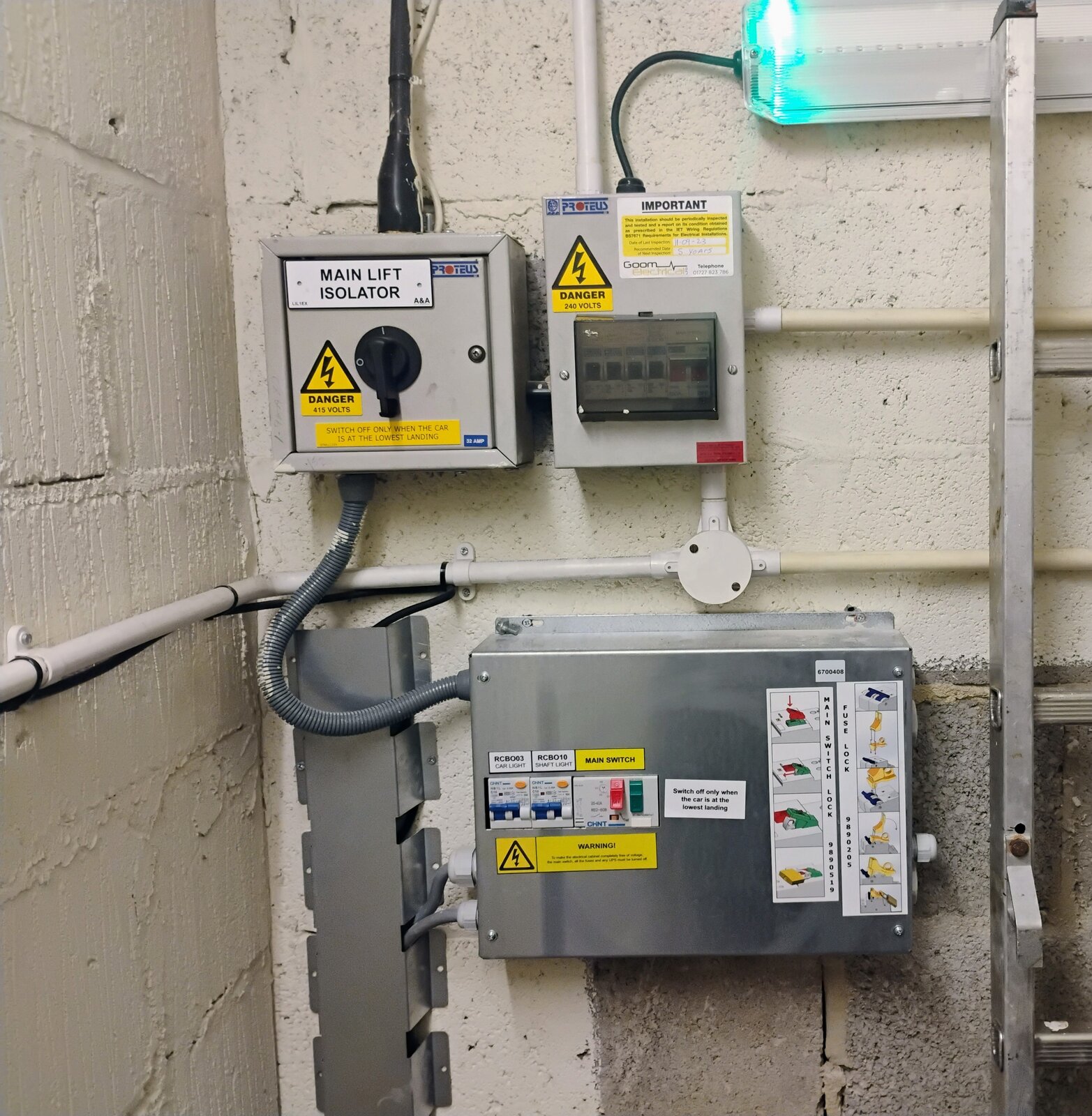

The lift to our building of flats is stuck on the 3rd floor.
The lift makes some mechanical noises as if the door wants to open, but then it doesn't.
Can any advise on some basic things to try

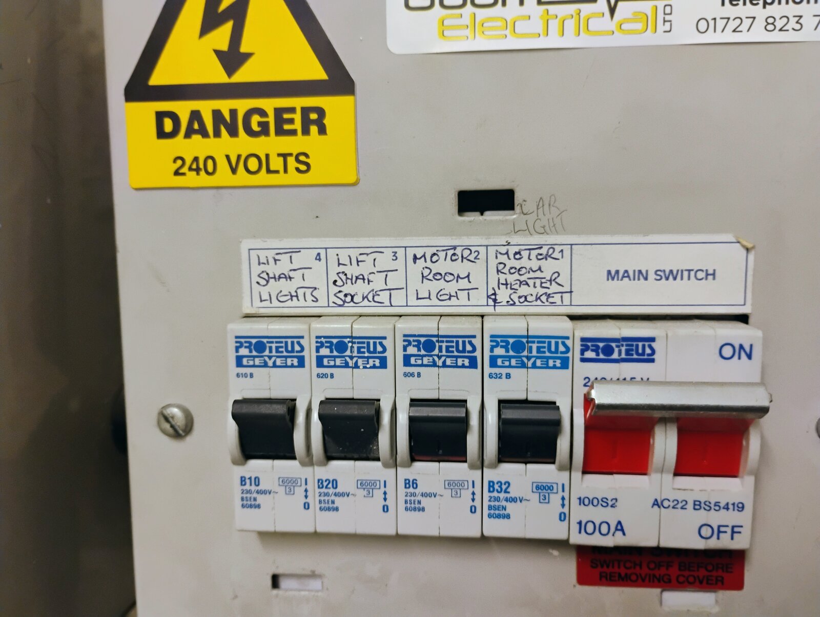

Someone mentioned shutting of the power, waiting a minute, then switching it back on to reset the lift.
However, when i went into the lift control/power room there was a sign which said,
"Switch off, only when the car is at its lowest landing."

Surely, switching it off wouldn't lead to some sort of disaster like the entire lift cab falling multiple floors, then crashing into the ground floor?
Nope, cannot happen. More likely, switching it off, will result in someone trapped in the lift between floors - the notice avoids that possibility.
Even if the ropes snap, the weight of the car, on the ropes, hold back pins. The pins would shoot out, to lock the car from dropping. If the pins fail, there is a big spring for the car to land on at the bottom.
Not very lift is on ropes, some are on hydraulic rams and they can gradually lose height if the power is shut off.
Used to work in a 2 storey building with a lit like this, it developed a problem and the facilities manager propped the first floor door open (lift at first floor) and barriered it off one evening. Following morning the lift had dropped several meters and that is with the power on. Lift maintainer didn’t believe it until shown the photos.
Don’t mess with the lift, hassle the landlord until it is fixed.
I have worked on lifts and having seen what goes wrong I generally take the stairs!

Update:
1. I switched off the main isolator, waited about 5 mins then switched it back on
2. The lift made some noises (similar to a PC starting up). It then made noises similar to hydraulics (sounded so cool)
3. To my surprise, the lift cab automatically went down to the ground floor and opened up (very slowly).
So it went from being stuck on the third floor and refusing to open to going to the ground floor and opening
4. To test the lift, I sent it to the 1st and 2nd floor and then back to the ground floor. Everything worked perfectly
5. I then sent it to the 3rd floor (i.e. the floor the lift was originally stuck on)..
When it got to the third floor, the lift stopped again and started clunking. It refused to come down just as described in the opening post.
What could the issue be?
