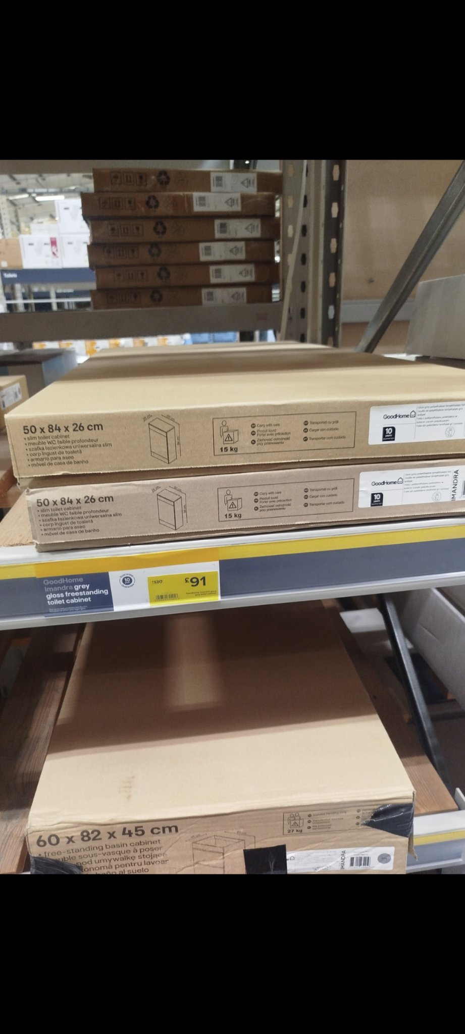

Has anyone put together one of these units?
Yup - relatively easy. As long as they have removable fronts that pull up and off, some don't and they keep changing these things.
If it isn't they can be a pain to fit the pan with the flush pipe and pan connector and to and get everything checked, tested and dry. So much easier when the front is removeable.
It is removable. But not sure if the front panel pulls up. Or if it pulls forward. I know the ones that pull forward are a pain
Could I ask do you think once built up you could transport it in a car?
Most are removable as they are a flat pack kit as the cams can unlock and the front pulled off as most flat pack kits do. You can get the hook clips that allow the front to be removeable by sliding up though. You can also get the clips to allow the top panel to be pulled forward. It makes a huge difference when it comes to fitting & servicing in the future too.
Cabinet plinth panel clips
And potentially install those clips in the link instead of the clips where you have to pull the panel forward so have to remove the toilet to remove the panel
Absolutely -
Build the cabinet, then screw the hook clips onto the front panel and the retainers onto the cabinet so they are set correctly, then unscrew either the retainers or the hook clips. Then remove the front panel as normal and remove the dowels and unscrew the cam pins.
