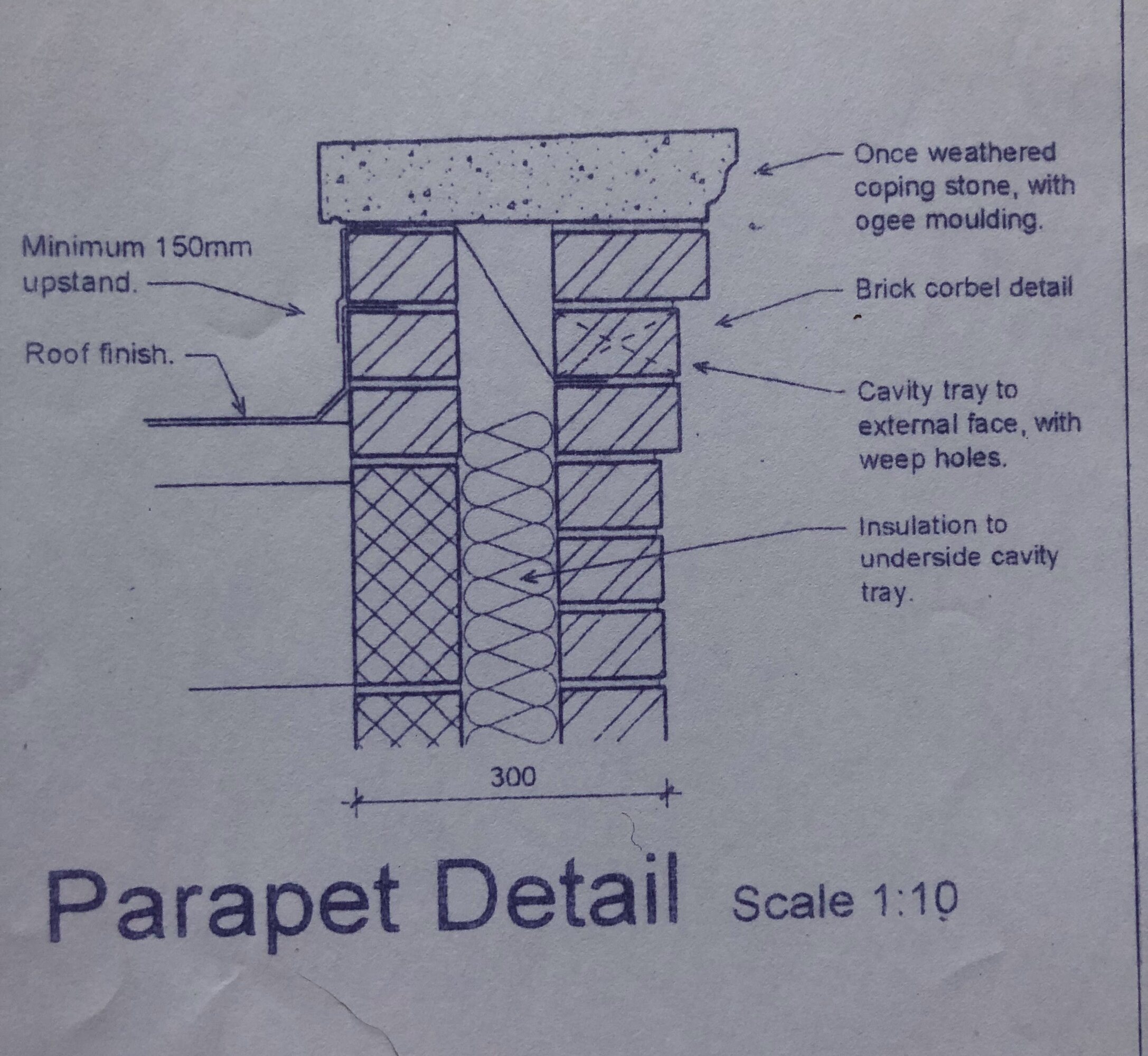

When detailing parapets, the roofing material should go over the parapet under the coping stones. The coping stones should also be secured in place with rods to stop them moving and becoming loose. It's not just about installing a cavity tray.
I wondered that too, we're currently trying to get in touch with the architect to clarify a few things.

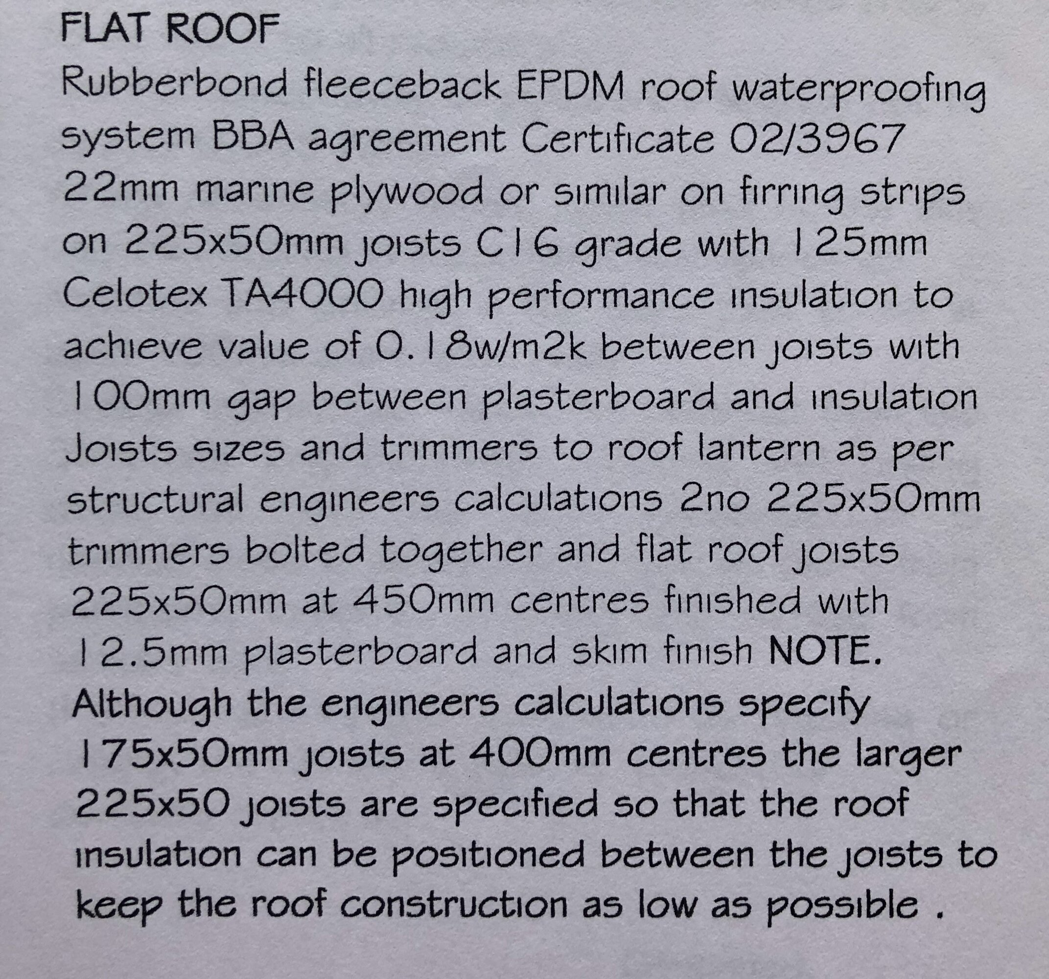

This is from the architects specification document and blueprint.
This is from the builders original quote.
that does seem very much to be a build issue then based on the supplied information.

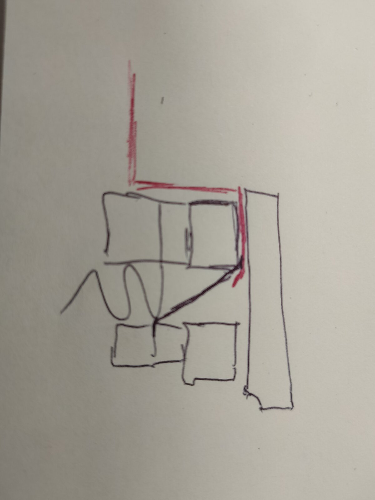

looks like the roof will need to come off, along with the coping stones and maybe mushroom vents installed, the roofing material to be taken up and over the inner leaf under the coping stones, and the coping stones ideally should be held in place with studs.
the roofing material neds to go over the inner leaf as per the attached crude drawing (roofing material in red) this is incase any of the joints between the coping stones fail and this stops the water from flowing behind the roofing material.

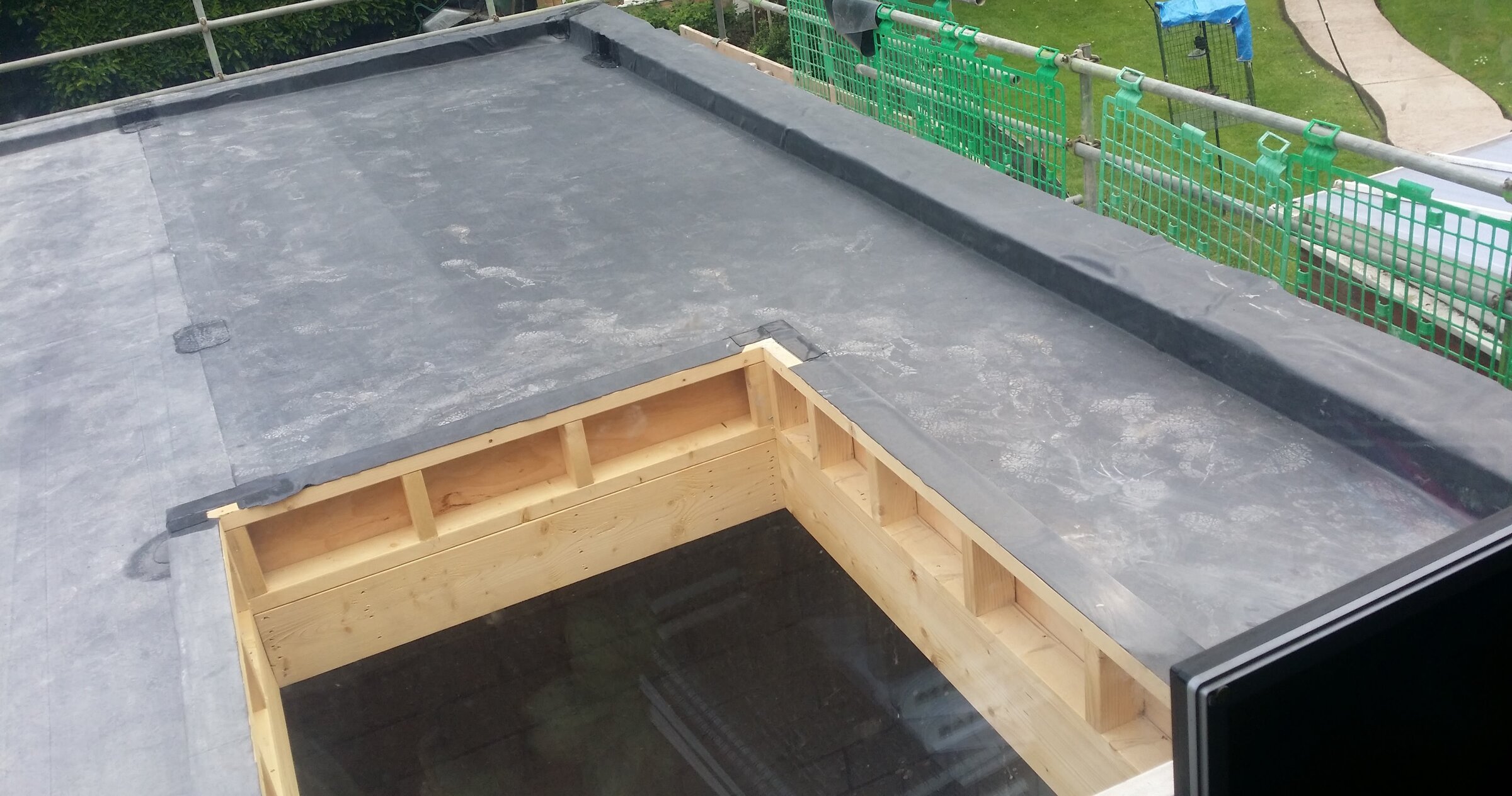

Yes, I'm sure you're right. Mushroom venting looks likely from what I've seen if it has to remain a cold roof. The original rubber membrane did go up and over the parapet prior to coping stones being fitted. When they ripped out the rubber they cut it at the base of the roof so that rubber under the coping stones is still there.
Looks like it was done right first time apart from the venting.
2nd time it's been done wrong and still not vented

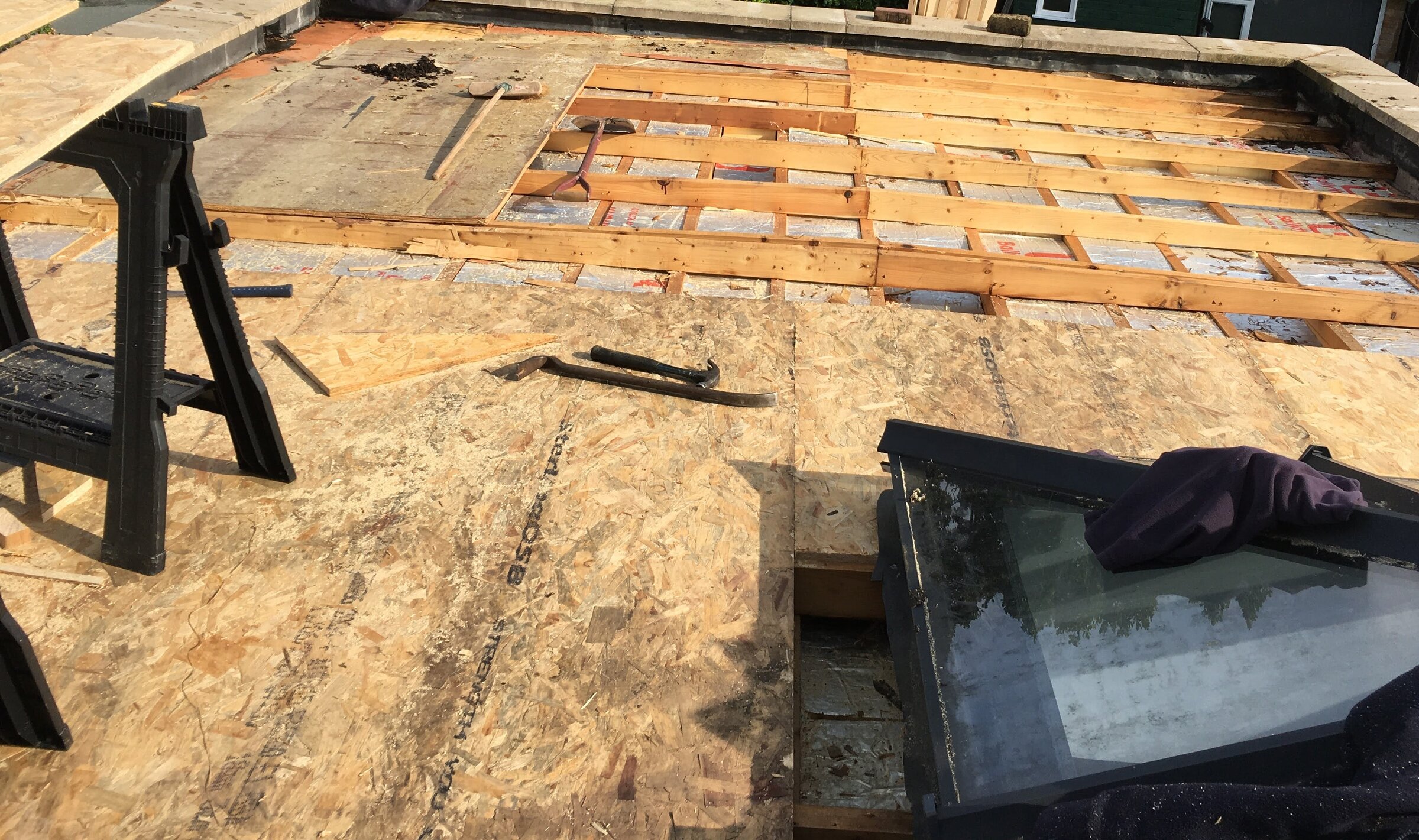

looking at the construction images, my suspicion is the 120mm insulation may have been pushed up tight to the underside of the counter firrings…..leaving no cross ventilation.
I can see how it’s happened, I’ve been on sites where very similar has been done - I’ve had strong disagreements with builders on this - I did one orangery where the client engaged their own team to do the roof etc - and they insisted on putting the firrings above the insulation like you have.

One more pic when they came out to replace the deck and rubber, showing the celotex up tight to the firrings as @Notch7 stated.
It very seems that you had 1 problem, and the builder trying to fix it without understanding the reason for failure , then failed to rectify the initial failure and introduced another fault.
Now you've found yourself with 2 faults.
The 2nd fault is easily fixed the roof needs to be installed as originally planned by removing the coping stones.
The roof, I.dont think can be turned into a warm roof without some major work, there isn't enough height on the parapet, so would need at least another course on the parapet, not sure if anything can be done in regard to the firrings to give you some additional room.
You could move the insulation down and install mushroom vents, not sure how many vents you'll need but I presume the roof will be peppered with them to get the air flow...
