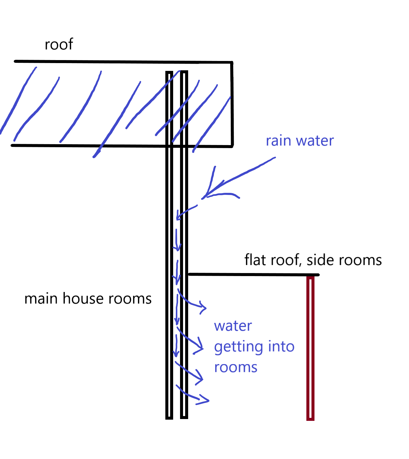

I am reading about cavity trays and panicking about :

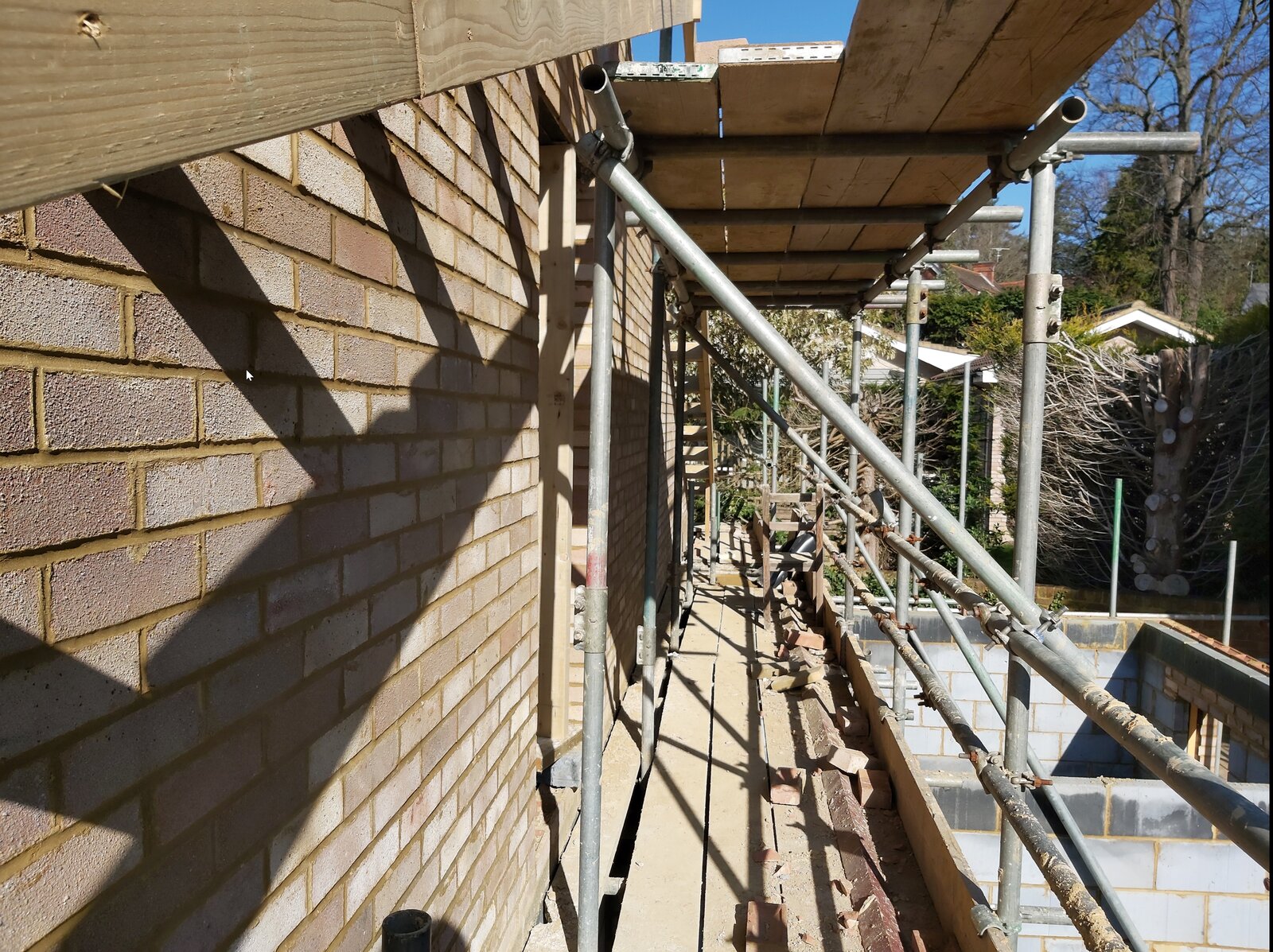

I have built a flat roof side extension measuring 9.2m x 4m alongside the gable wall on one side of the house. There is no cavity tray. If I understand it correctly from what I am reading now, the water from the gable wall above the flat roof structure will run down the cavity and all the way down to the foundations, but on its way can come out the blockwork into the rooms? Should there be a huge cavity tray running the whole length of the side extension then to take water out of the gable brick wall and potentially onto the flat roof?
Hi, it is all brand new brickwork. The house is under construction. There is no flat roof yet, just the walls. But it is too late to fit a cavity tray. The bricklayers fit cavity trays over windows and doors, but not over the side extension wall. I attach a photo (do not have a better one).
it is not too late.
Get some trays retrofitted - the bricks are cut out, a section at a time and trays inserted.
or go to cavitytrayman and get them to fit their tray - it’s basically a strip of metal with a bit of a bend along its length - they grind out one line of mortar and insert the tray - it doesn’t go right across the cavity, but the water that gets in runs down the inner face of the outer skin.
Either way, it’ll cost you about £1k ish
The solution now might be to use a breathable brick sealer
Sealers have a limited life span - will probably only last a year, although the most expensive ones containing silvan / siloxane do work pretty well
If you choose not to do a tray - I would suggest on the wall in the extension, fit 50 x 25 battens then fit 12mm foil backed plasterboard - that creates a cavity so any water running down the bricks are less likely to show on the plaster - bear in mind any water running down the cavity will hit any steel lintels above openings and will run out at the ends of the lintels

No, and neither did the inspector who actually was here a few days ago and literally measured the cavity right over the utility rooms! He could see right down into the wall, as he stood over it.
The assumption is that you don't use shiite bricklayers.
Yes they inserted cavity trays over every window and door, but not on that wall. And I do have a full roll of DPM left they could have easily used if only we knew.

Lots of properties don't have cavity trays and don't suffer any damp.
In the old days cavity trays didn't exist.
In reality, unless the extension is on the exposed side of the house and you get heavy rain, you won't have a problem.
Although, as it's a fresh construction, installing the tray now won't be too difficult and would be a suitable belt and brace approach.
