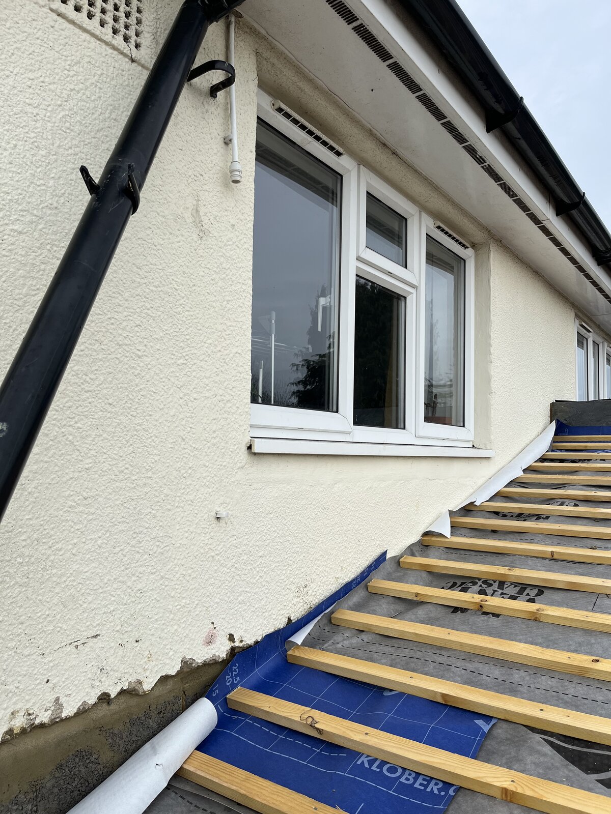

BCO may (rightly or wrongly) allow them to be absent though if the wall is rendered (ie fairly well protected) and isn’t a huge area also protected by the soffit overhang
The render is some sort of pebble dash-ish stuff. The main roof soffit overhangs ~30cm.
Would cavity trays be a problem so close to windows?

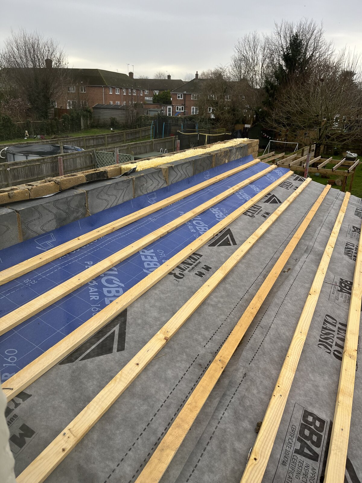

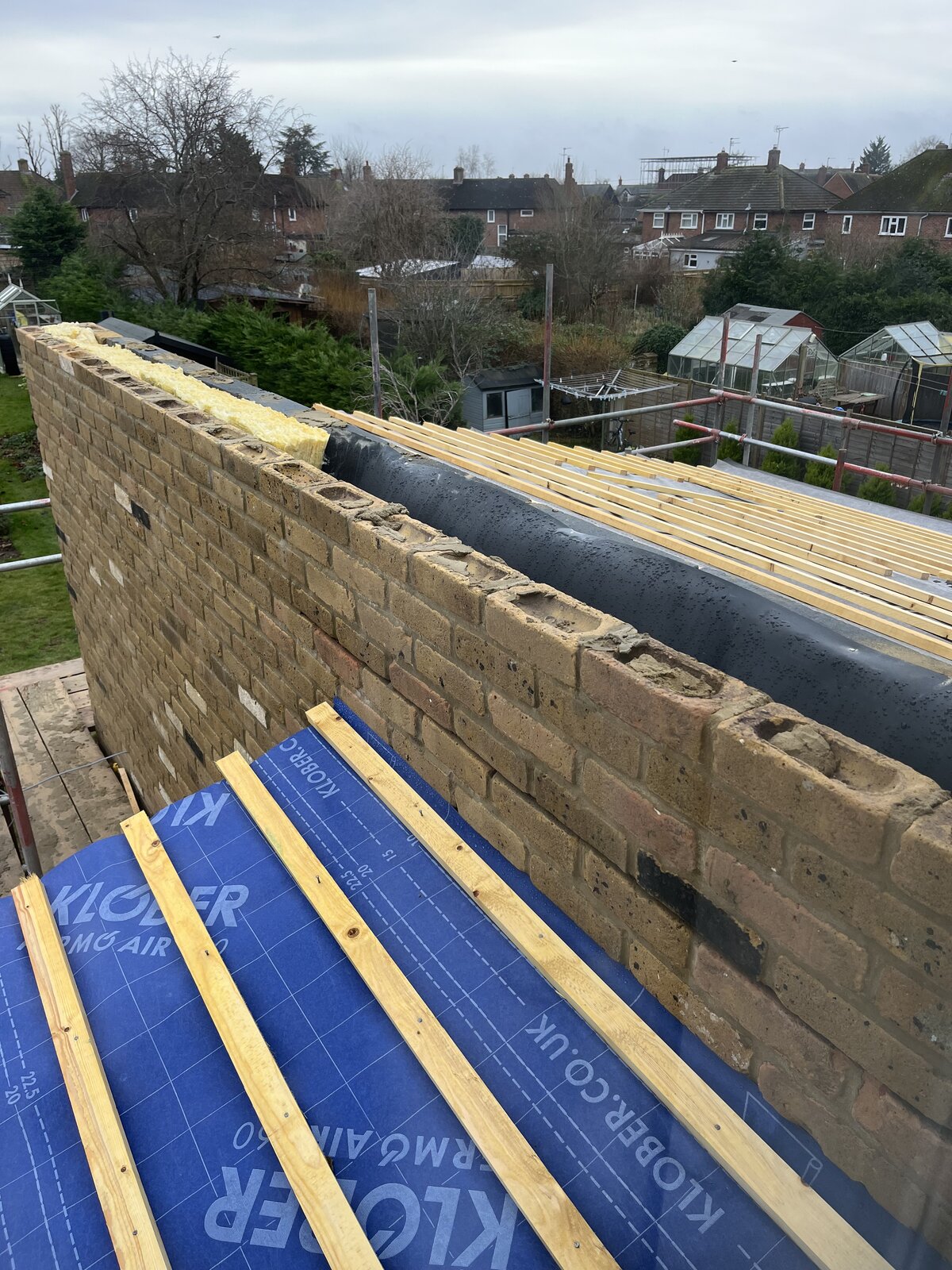

Thanks. That’s helpful. What would be best practice for parapet wall? They have installed some sort of flexible membrane above roof on one side. The rest of parapet doesn’t have anything yet.
Original plan was for standing seam roof and parapet cap, but have changed to tile roof due to cost. I think the plan is to put coping stone on top now.
Would they need to put a cavity tray or membrane across entire wall?

I know others will disagree, but particularly given so much of the wall is taken up by window, and it’s dashed, I’d say fitting them may not be worth it in this case. Any water ingress is going to be fairly unlikely, and easy to locate and fix. But that’s me from the perspective of the person doing the work and assessing the risk, you can specify that the builder does whatever you want

Window openings are a significant source of water ingress to cavities. Eaves also, along with ..... cracked render.
All cavity walls require cavity trays.
The plan monkey should have specified them, and if so the builder would have priced for them.
