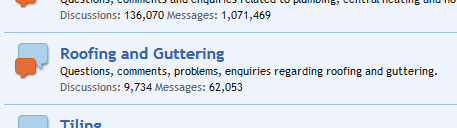

You should be asking these questions here:
not here:
Who was the person who designed the roof and decided that it would comply?
A builder who specified the roof. I'm in contact, so expecting to have that discussion, but need to understand what BC might allow to resolve. There are several other issues too, but this is the main one.
Thanks, didn't read the descriptions.
