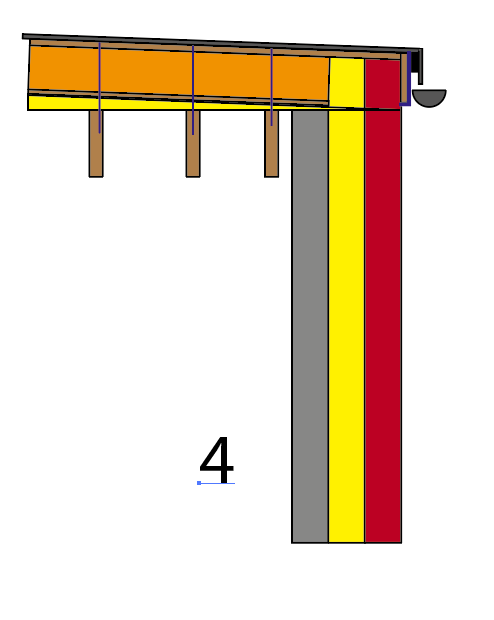

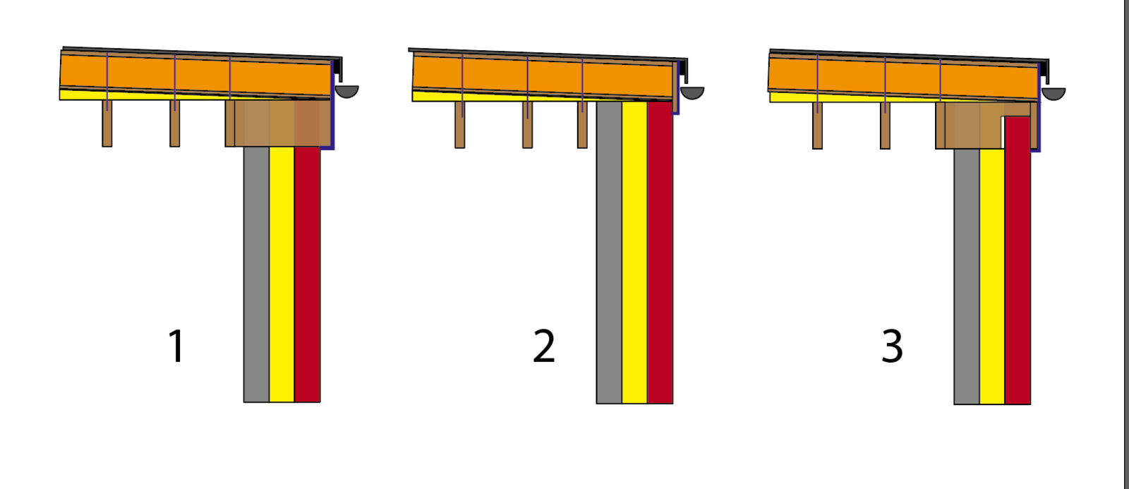

Hey guys
I am at the roof stage with my extension - Roof joists are in and i am just after some advice about how the warm roof terminates into the gutter and how it goes across the wall thresh hold
I have put some images together of my thoughts, maybe they will all work but just wanted some advice
I kinda want keep the facia board as small as possible
Posted before and got some great help, so thanks in advance again!

You'll need to extend the wall higher than the bottom of the joists to achieve a slimmer fascia, and carry the effect around the roof sides too.
Okay something like this?
Basically yes.
In practical terms the roof still sits on the internal leaf, and only the outer is extended up.

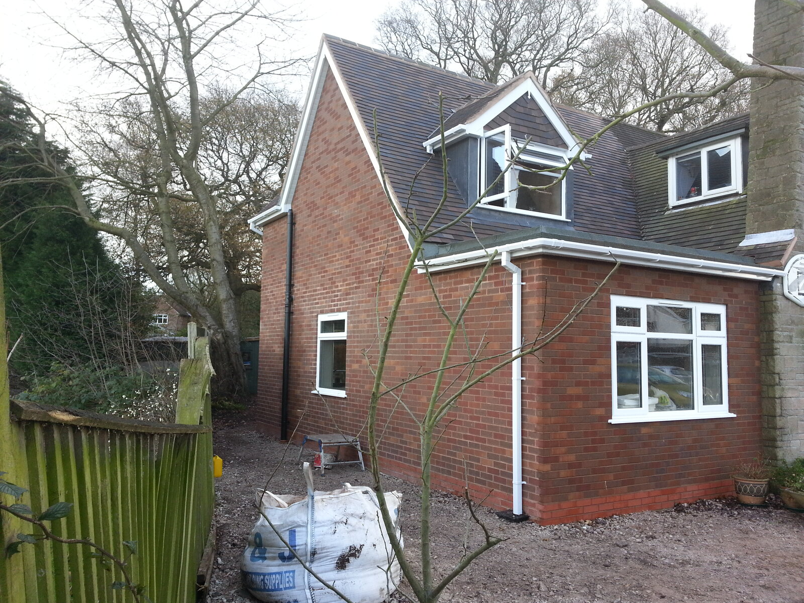

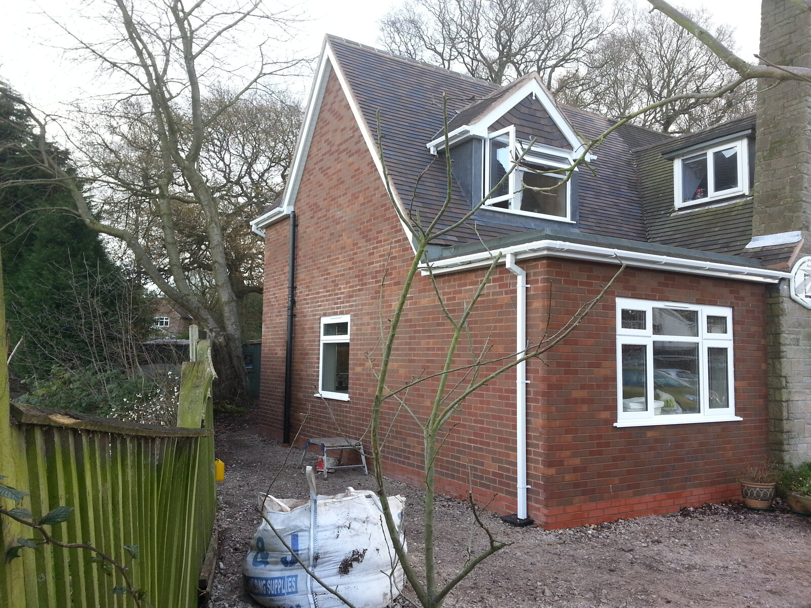

@noseall how have you got the angle on the edge of the roof? Is it insulation cut to an angle, or ply fixed somehow to create the angle, or something else? I want to do the same, but not sure the best way to achieve it.
Tim
Don’t forget your roof trim at the gutter will depend on the roof membrane, GRP has a different drip edge to EPDM and it’s best to set out the roof to suit. For GRP, I’ve found it’s necessary to put a shallow rebate on the edge of the deck board to ensure the roof doesn’t end up with a bit of high spot.
