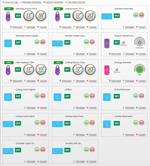

I have 5 eQ-3 and 4 energenie TRV heads, and they do work. However a lot depends on design of the house, unless linked to wall thermostat there is nothing to make the boiler run.
So I have carefully set the wall thermostat and programmable TRV heads so boiler will start at same time as the TRV changes temperature, basic idea is turn down 0.5 half hour before change then back up on change.
So I got eQ-3 for £15 each with bluetooth. And for me they have worked well, as good if not better than the wifi Energenie TRV heads.
Yes I have Nest gen 3 wall thermostat with geofencing, and also the Energenie with IFTTT can also be set for geofencing, however I find not used much, and there is a problem with geofencing in my case with over shoot.
The TRV also has a problem the Energenie has OTT anti hysteresis software so set to 22 for hour then back to 20 to speed up reheat, which will not work with geofencing.

However the pairing of the Energenie and Nest did not work out, using the phone to alter Nest with the Energenie app and all the TRV heads followed Nest, but with a schedule change or turning dial it failed, phoning Energenie we found support by Nest had been withdrawn, also the wall thermostat telling the TRV what to do seems wrong way around, seems there were no TRV heads designed to work with Nest any more, so unpaired and simply set the TRV to same schedule as Nest, however no where near as good as with mother house as boiler does not modulate so TRV heads opening will not warm room unless boiler running, but still worked reasonably well, and since nothing works with Nest any more I bought an extra 5 programmable TRV heads without wifi, just bluetooth at £15 each, bluetooth was a little of a disappointment as will only work with one device, so 3 on my phone, and two on wife's phone, and it only displays target temperature not current. However have open window detection and are really easy to manually control, I can set eco and comfort temperatures not fixed like energenie, so walk in room press one button and switches to comfort, rarely do I press when leaving it turns down again at next scheduled change. And the window open feature turns off kitchen radiator when unloading my car.
