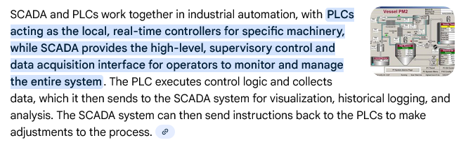

Basic some form of HMI (Human machine interface) or SCADA (Supervisory Control and Data Acquisition)
which is designed for the home rather than a factory. The Google Nest speakers do a reasonable job, but would be nice to have some visual display as well. I have worked with Mitsubishi PLC's and have some spare ones kicking around, but really want something any domestic electrician can fix when I kick the bucket and my wife is on her own. So looking for something designed for the domestic market.
