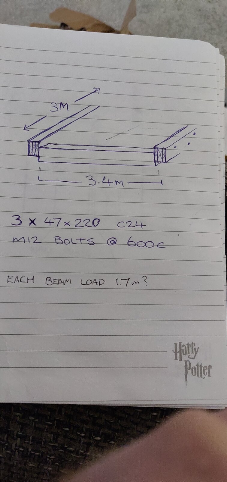

Ah the existing joists are 70x50. The beam is supposed to be sitting above these by 20mm but he wants to keep the bedroom ceilings flush without the beam sticking down. At the same time I suppose you don't want the beam sticking out the top of the floor. It might not be possible unless he starts notching existing joists and have the beam sat in them instead but I thought the new floor needs to be independent so not to cause any cracking to ceiling. It's not possible to install two beams either so beams would be out the way in storage area, the beam is just off center of room due to how the load bearing walls run
The eave is quite narrow and won't fit the full 195mm depth of the joist but apparently that's ok
Have you considered steel box-section as a beam? If you are supporting around 9 sq m of floor, a 100 x 100 x 10 with a 97 x 47 screwed on top should do that over 3m without excessive deflection.
Hi Tony, would this work as an option? See attached image.
would it be correct that each beam would only take half the span load ?
