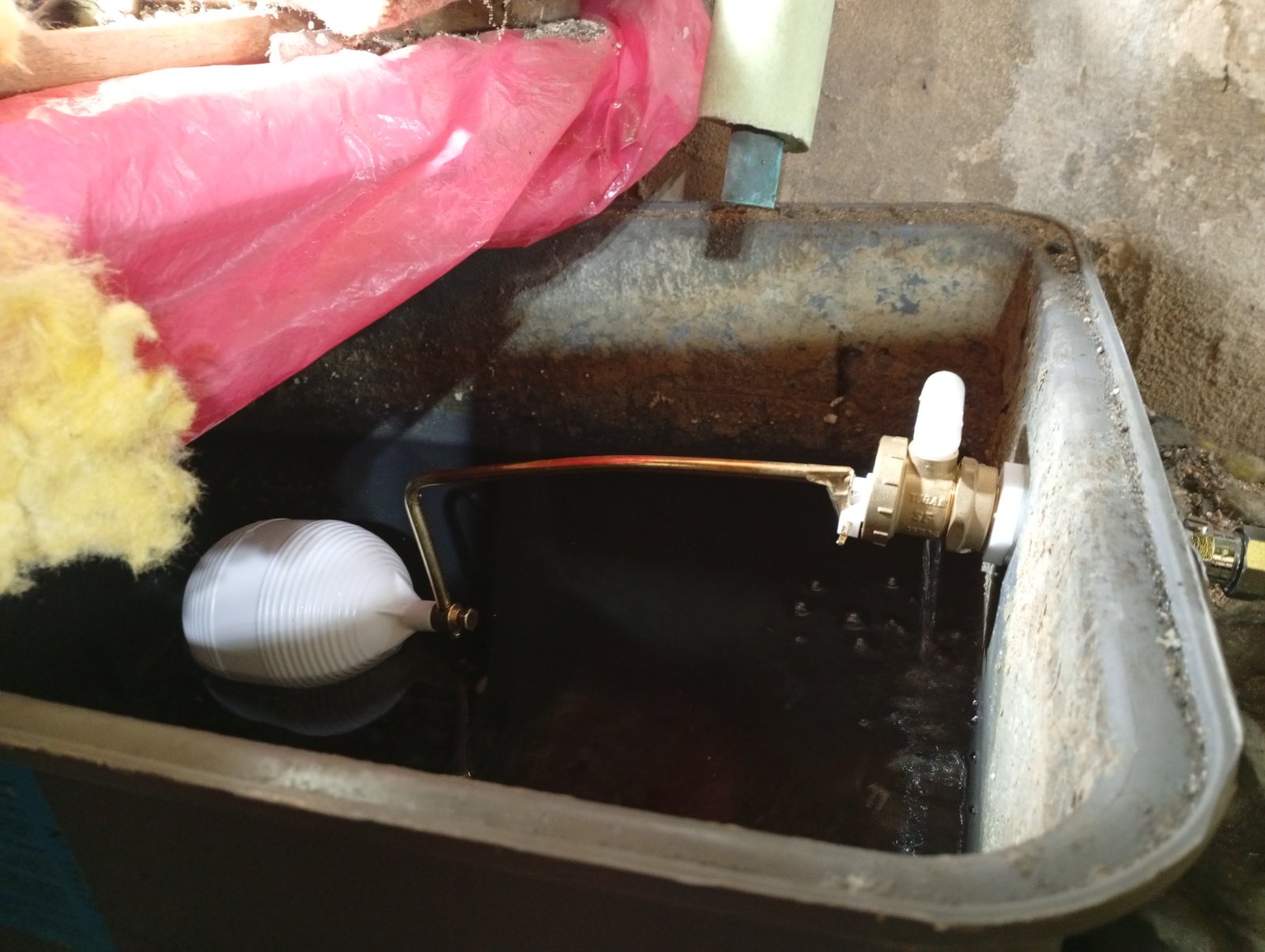

Float valve? Help please
What are the chances that the existing nut is imperial?
A possibility. The nut profile looks like it might be a Conex brand valve which, if I recall correctly, used to have a non-standard/Imperial thread.
The nut will be imperial because the ballcock is 1/2 BSP and the nut is screwed onto it.
It won't make any difference to what you want to do..Just change the ballcock and add an isolating valve.
Plenty of 15mm compression nuts will screw onto 1/2"

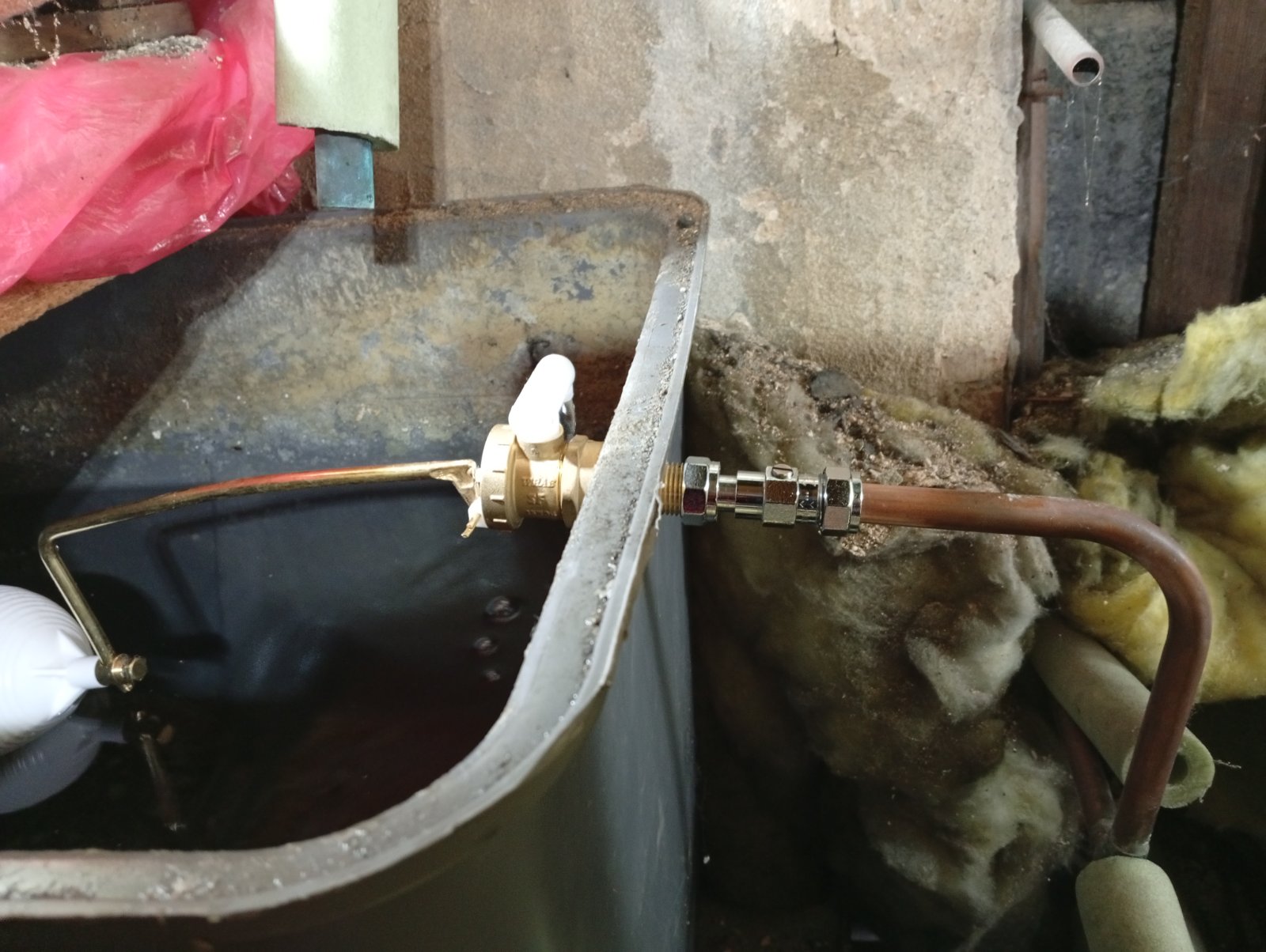

I think I'm going to cut the horizontal pipe and solder a new piece so to get a brand new connection and service valve.
Or, if the new service valve is long enough, just cut what needed on the right of the existing tap connector.
I can see PTFE tape on that nut, so maybe it's already given problems in the past (deformed olive?) and I don't want to risk spending all day on a 20 minute job.
What do you think?
What do you think?
Personally, I'd change the ball valve only, and only if required. A ball valve repair must be the most common plumbing task, I wouldn't over think it. But you could of course go as far as you like.

Ok, all went smooth with the valve.
There was enough pipe to cut and add a service valve.
The overflow wasn't blocked, it had been disconnected by roofers to fit new fascia and soffit recently and not reconnected.
So most likely float valve had been leaking for a while and nobody noticed because overflow was discharging outside (moss visible on bay window roof just on that line.
I had to bend the shaft a bit to get the correct level.
Thanks for your kind advice.
