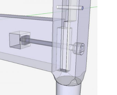

You could use a bed bolt joint with the access hole underneath.
Like this
another view
