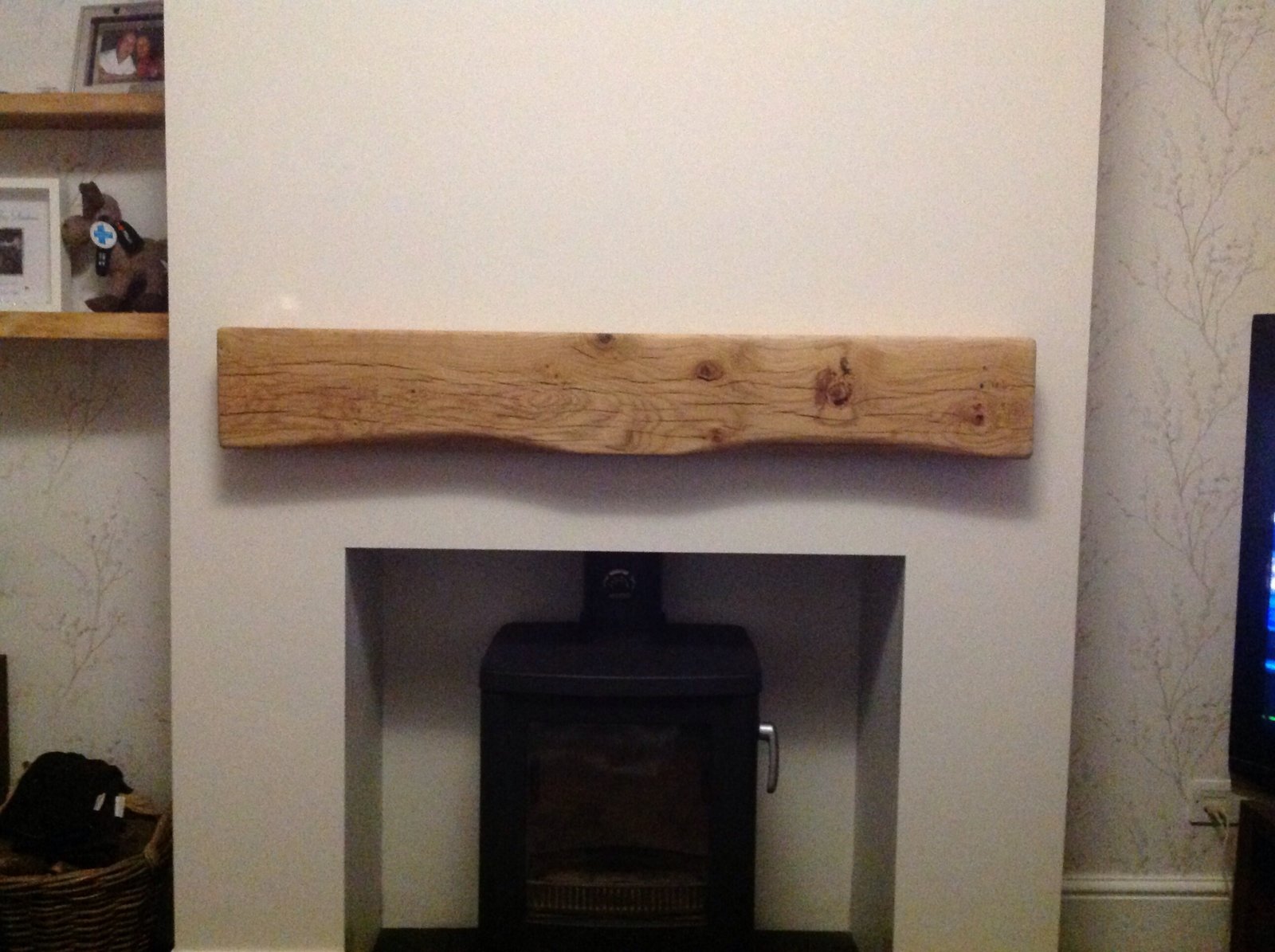

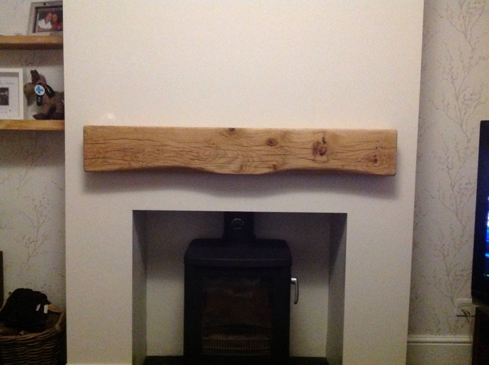

I've just done the same 12mm s/steel thread bar with chemical fix , made a template with mdf , set bars with template , then removed and fitted mantle
That looks really good! How many steel bars did you use? Also what chemical fix did you use?
John
3 bars , the mantle was pre drilled , so just made a template, to be honest I fell lucky with the chemical fix as a friend loaned me some with a dust extractor ...all I can say it was a two part white and black that was grey when mixed ( was a two part application gun ) not just a standard sealant gun , the studs where rock solid within about 10mins
